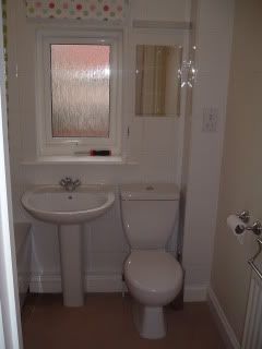

Bathroom 1:

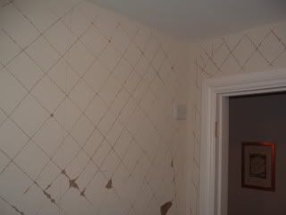

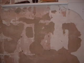

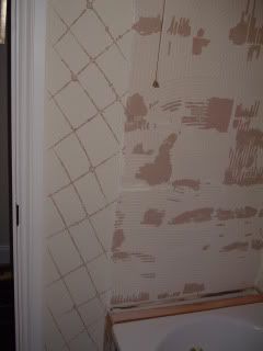

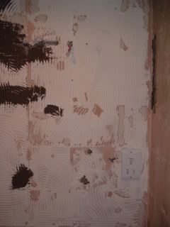

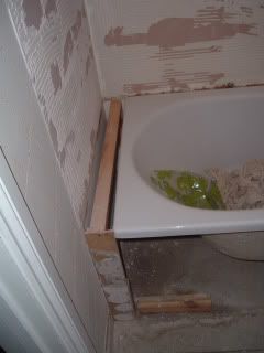

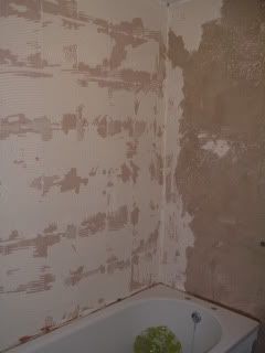

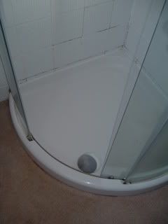

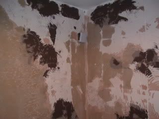

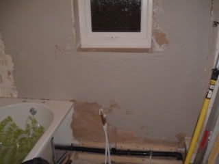

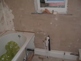

From the old grout joints in shower area it was obvious there would be water damage and there was. Only ever ripped ONE shower out that hadn't had water damage - this is why I always tank. Bottom header stud was rotten and needed replacing and bottom meter of plasterboard was black with mould and disintergrated. Other wall was a skimmed block wall on sand and cement render and the old adhesive (tubbed) could be removed with a sponge.

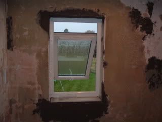

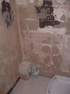

Unfortunately elsewhere the tiles mostly came off taking plaster skim too leaving a very uneven sand/cement scratch coat:

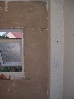

Window wall wasn't too bad and used a concrete rubbing block to take off the high points. Other rendered wall was awful but couldn't overboard or I would have lost the shower tray :thumbsdown:
Leveled off as best I could with rapid set and ditched the idea of brick bond.

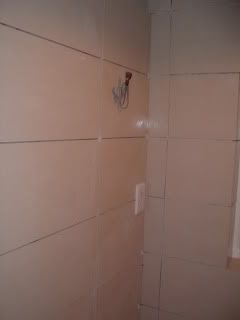

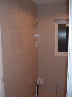

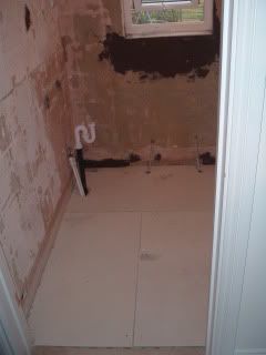

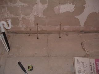

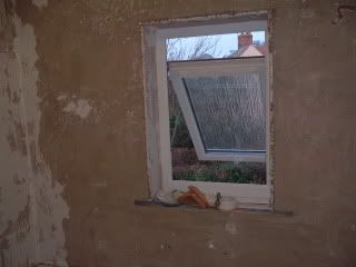

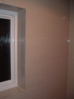

Removed window sill and made good:

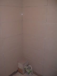

New plasterboard, tanked and levelled with rapid set:

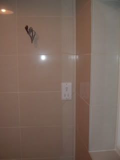

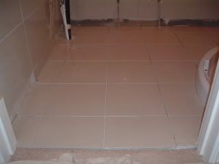

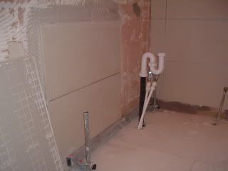

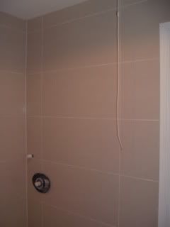

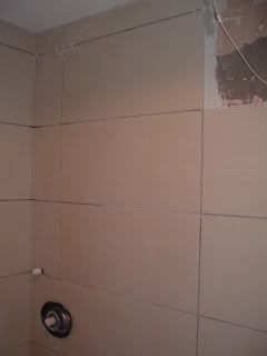

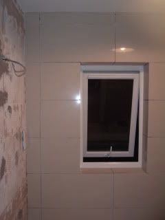

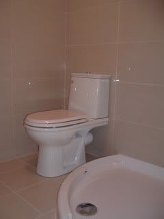

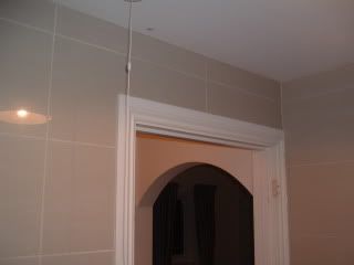

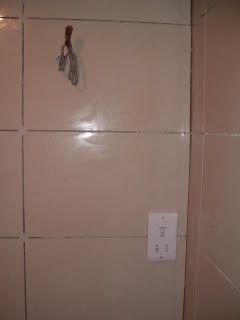

600x300 beige porcelain (makes a change.....not)

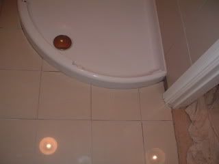

But these are polished and is my first time working with polished porc.
First thing I did was test if they would need sealing by marking a tile with a dry wipe marker and rubbing it off - this left a permanent stain so knew it would need sealing.

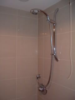

Tried out my new toy and love it!

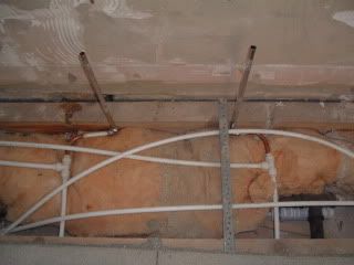

Sure I would have nicked them JB pipes if I hadn't had this:

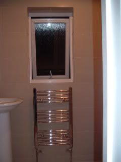

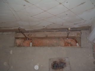

New centers and chrome pipe for Towel rad
Tip: pushfits don't seal well on chrome pipes so use a compression cap to seal off before refilling the system (these help keep the diameter down for the holes that need cutting in the tiles too)
