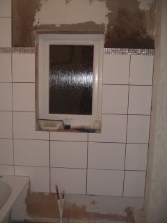

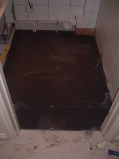

600x300 beige porcelain (makes a change.....not)
But these are polished and is my first time working with polished porc.
First thing I did was test if they would need sealing by marking a tile with a dry wipe marker and rubbing it off - this left a permanent stain so knew it would need sealing.

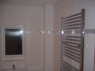

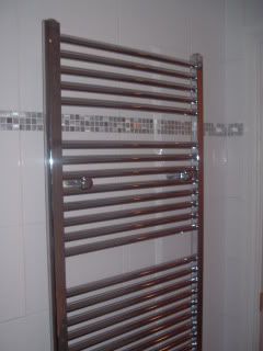

New centers and chrome pipe for Towel rad

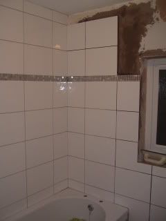

Tip: pushfits don't seal well on chrome pipes so use a compression cap to seal off before refilling the system (these help keep the diameter down for the holes that need cutting in the tiles too)

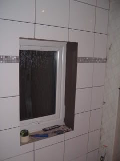

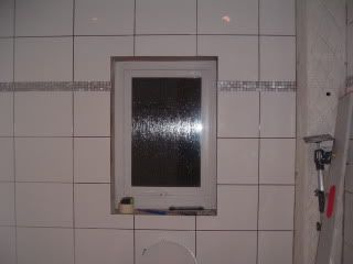

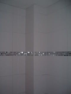

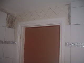

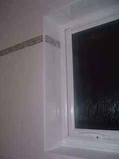

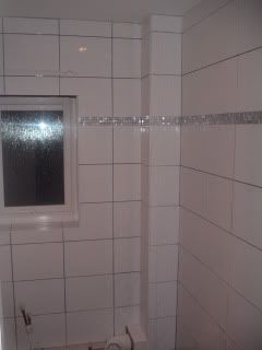

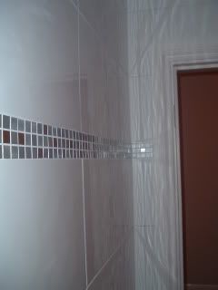

Had to mess about with the window a bit but got a nice set out around it as a feature that worked well everywhere else.

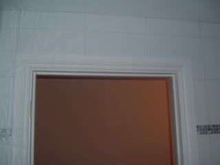

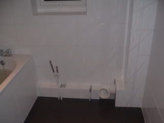

Full bodied porc so won't be using trim on this job:
Lengthened feed pipe to accommodate thicker tile:
Feed for lighted cabinet:

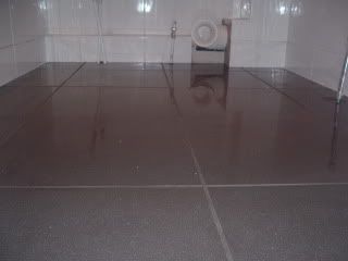

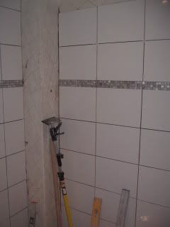

Need more tiles to finish bottom cuts so will pick some up in the morning - need to get the floor down and all walls complete tomorrow or I'm gonna be stressing.

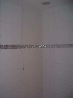

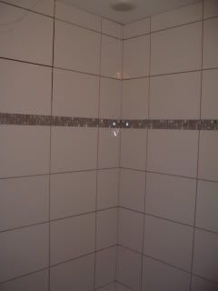

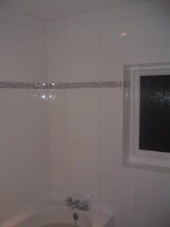

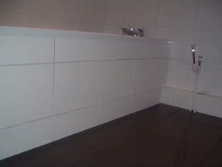

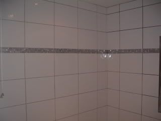

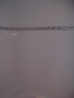

De-waxed, sealed, grouted and siliconed.

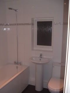

Final fit tomorrow - not looking forward to the sliding curved shower door - haven't got a clue how it goes back together!! :lol:

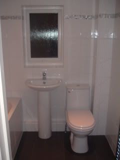

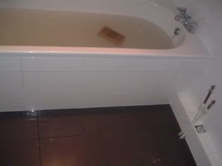

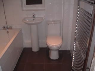

Got everything done bar the shower enclosure:
Used a McAlpine 90 degree flexi - elbow - never knew they did them but was perfect for this job.
