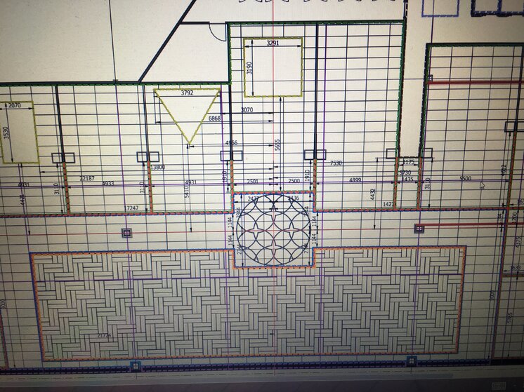

We have to start a Harolds Shop in Heatrow,big area (over 1000 sqm) and just receive the details:
''Please see setting out drawing for Harrods,
Please note 2mm grout lines, the project has been set out as this''
I don't know if is right to do it or refuse to do it, BS is min 3 mm.And big tiles not help!

1200x600x10mm Porcelain tile, Ref Precious – Approx 458m2
1200x600x10mm Porcelain tile, Ref Pietra Reale – Approx. 234m2
1200x300x10mm Porcelain tile, Ref Precious – Approx 258m2
Black Granite to Entrance
100x100 tiles with Brass inlay to both sides
Waterjet cut feature with Brass Inlay
1200x300x10mm Porcelain tile, Ref Pietra Reale – Approx 58m2
Simons70
603
763
Luton

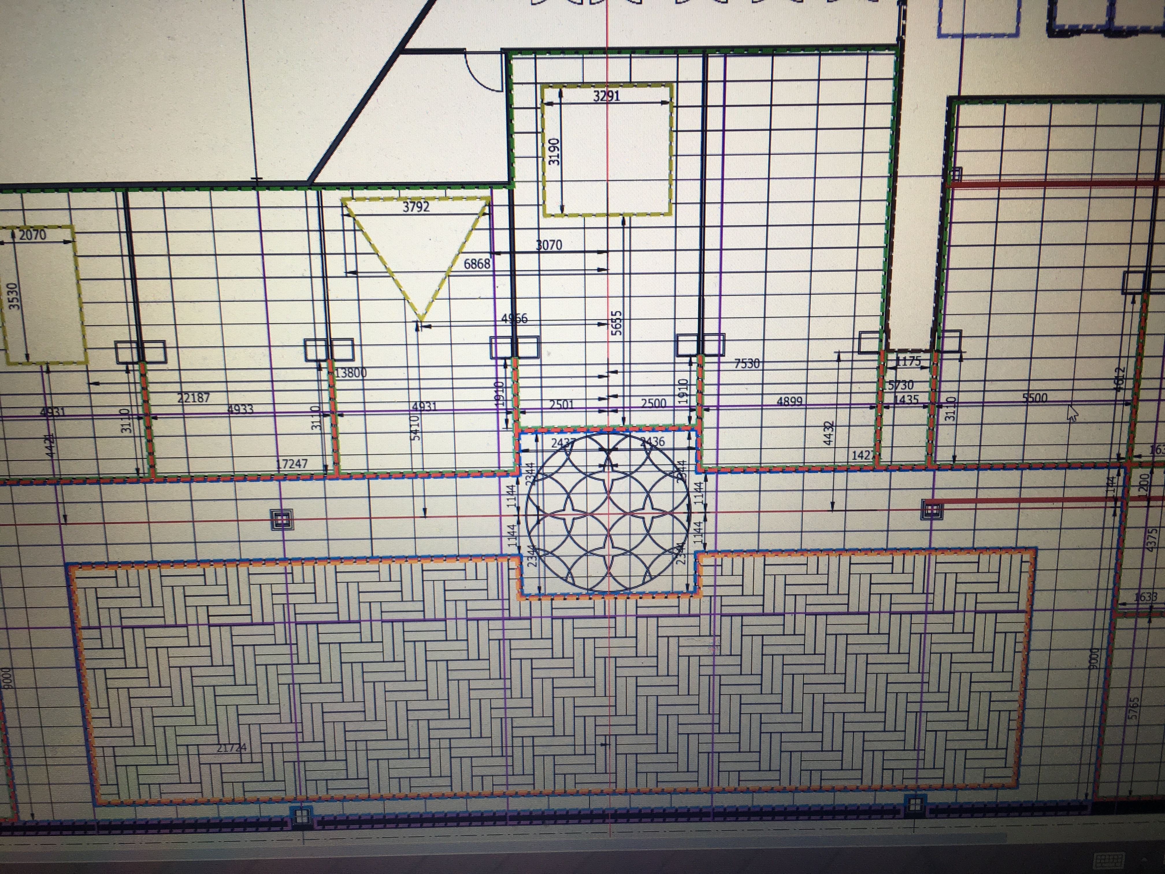

The problem is 2 mm spaces,the job is with mixed tiles laid on ditra with expansion. All is nice and easy in the drawing....

The set out of 2mm grout lines is dependant on the tiles actually being spot on 1200, 600, 300mm dimensions. if the tiles are 1mm less then the joints will be 3mm to keep the same drawing set out; if the tiles come larger than spec then the designer may need to have a rethink.
As stated earlier the BS 3mm is a recommendation which it is wise not to exceed (i.e. go less than) unless someone else suitably qualified is taking the responsibility - presumably the architect/designer in this case.
