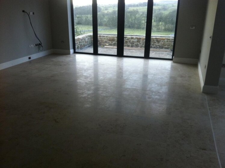

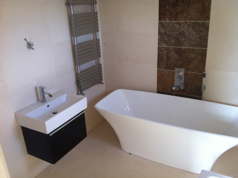

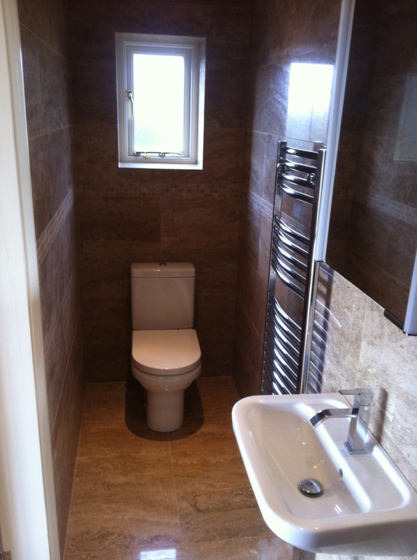

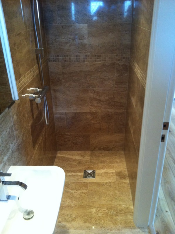

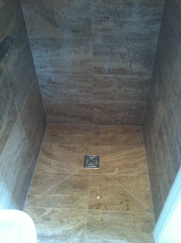

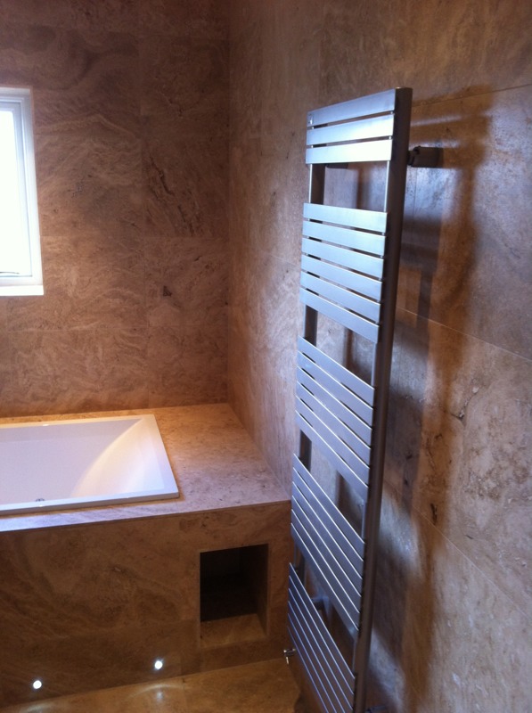

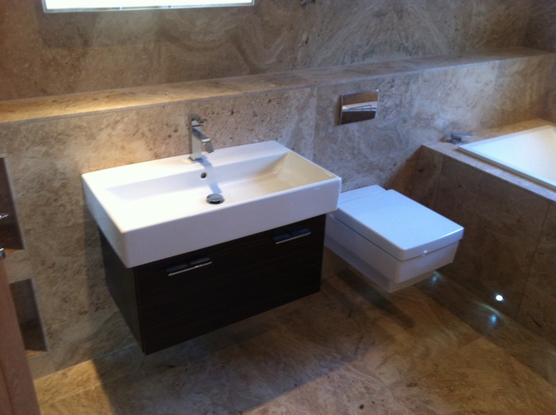

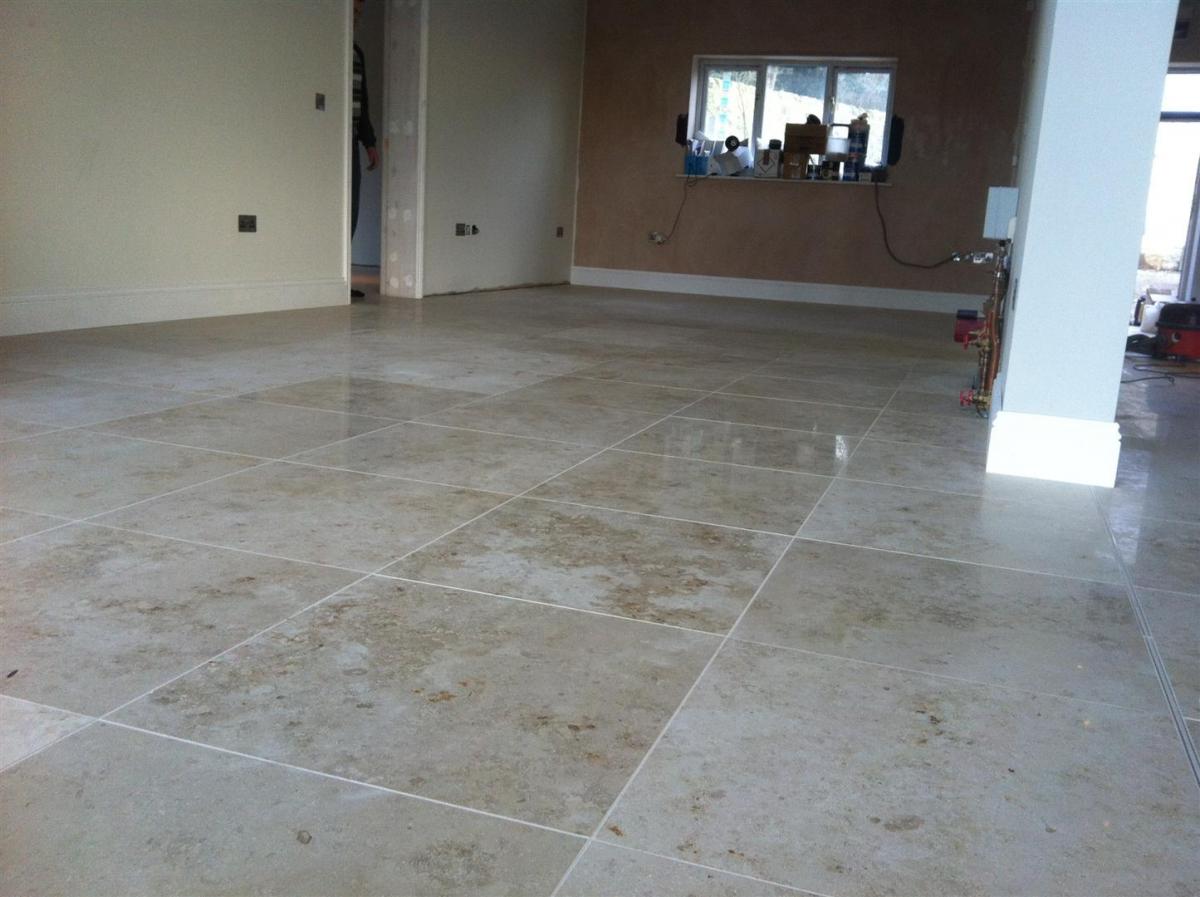

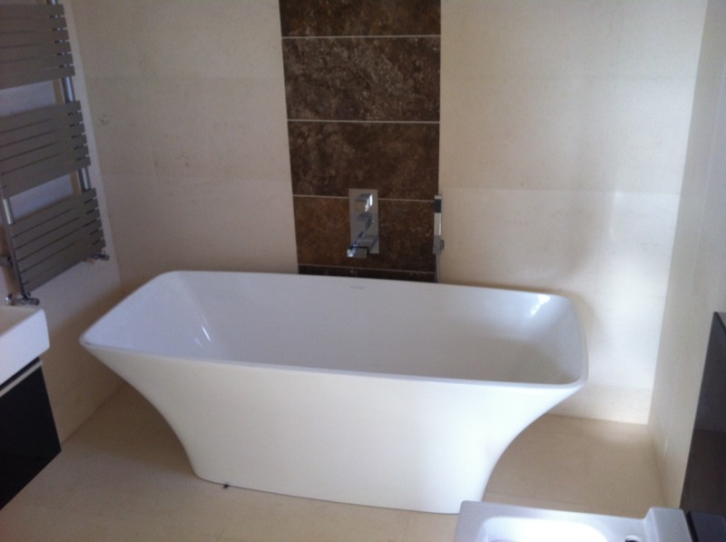

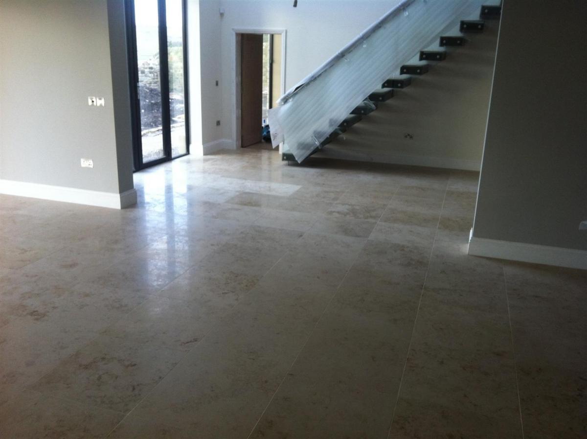

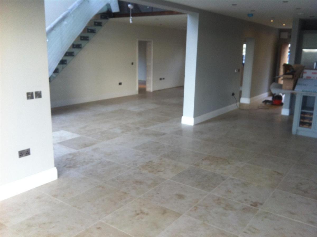

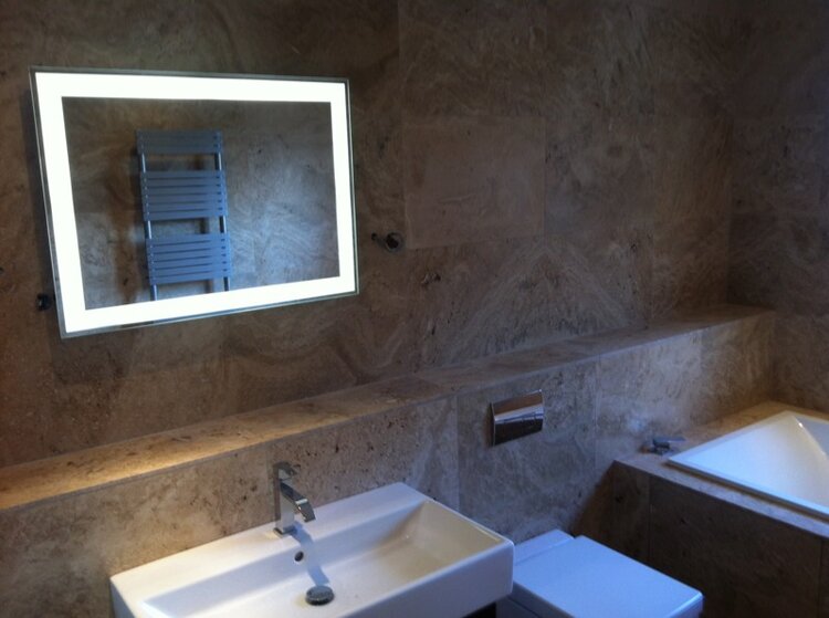

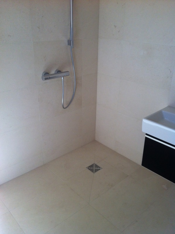

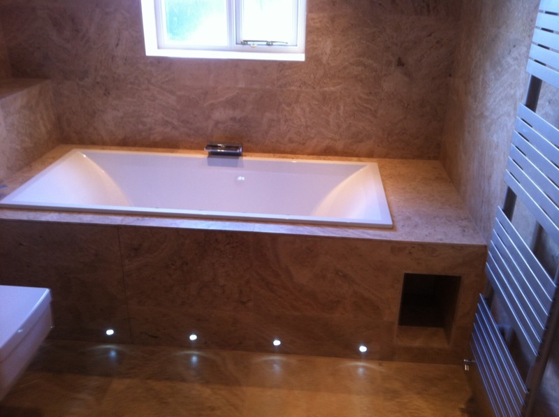

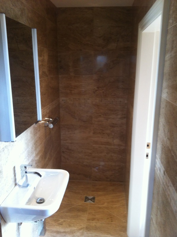

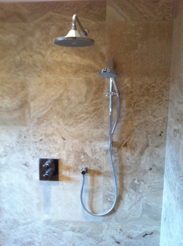

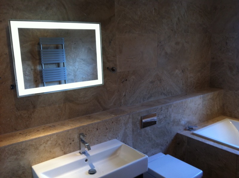

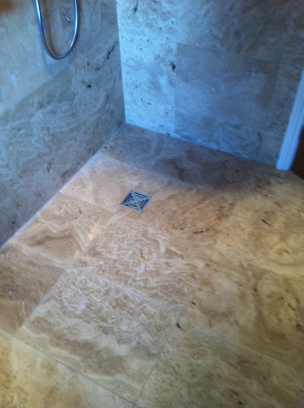

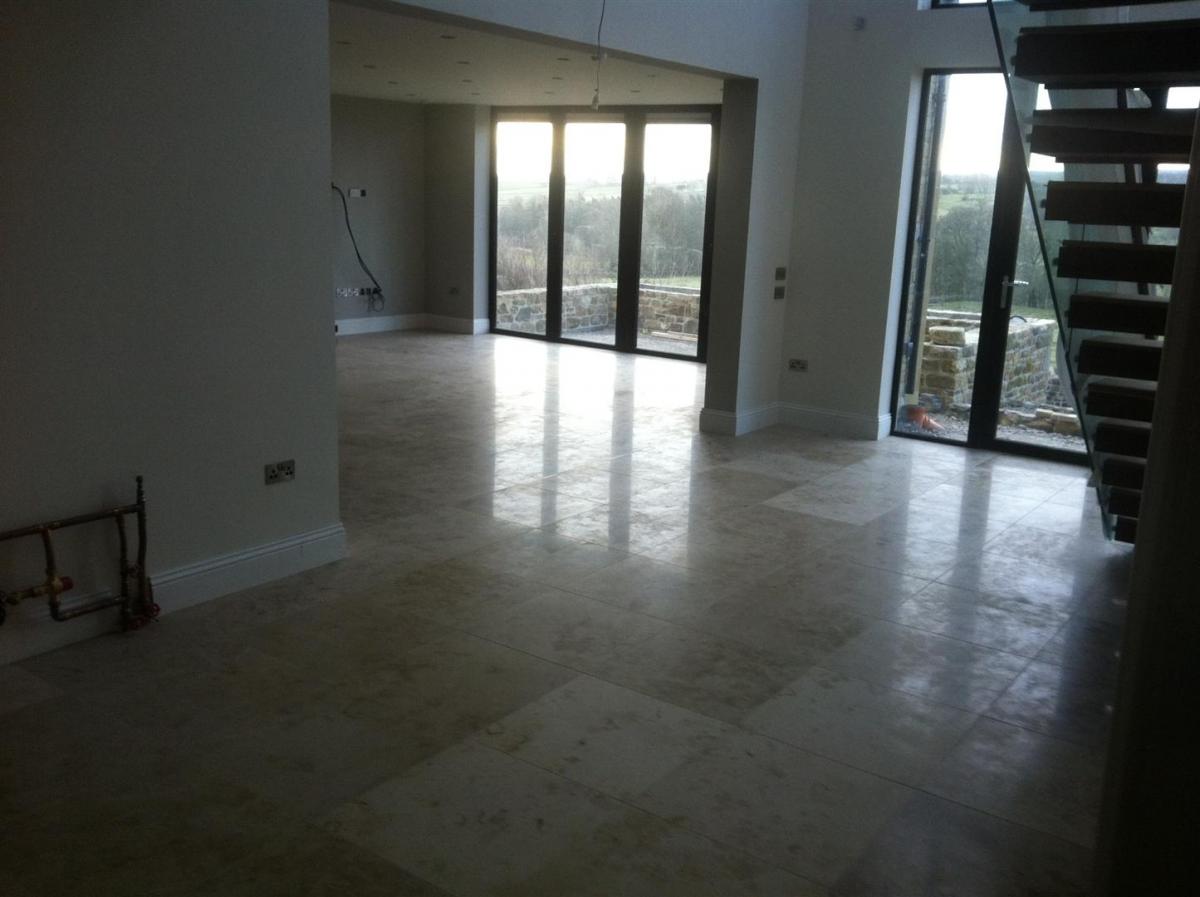

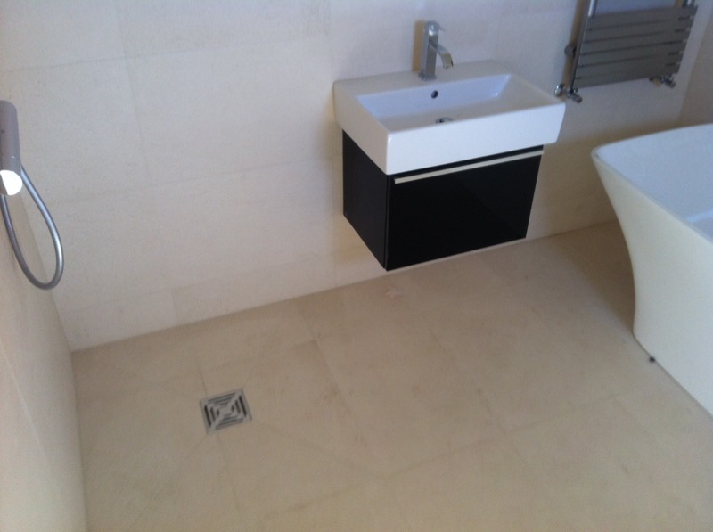

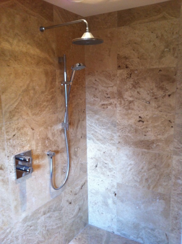

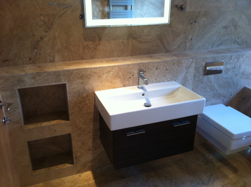

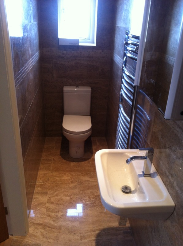

These are just some pics from the job at Bowes village I have been doing.
All walls are onto block work and I had to skim all walls first with addy to make sure they were flattened off, then tank wall areas to keep mould and damp out. Etc etc. ...
All floors are Anhydrite (Gyvlon LL ). Primed and tanked with Dural CI.
A Lot of work before tiling could even commence.
The white limestone was from Mandarin.
The 2 en- suites polished travertine from PHG, one done in landscape the other in brick.
The main bathroom in wooden travertine from Mandarin.
Hope you like.
P.s.. Pics to follow of the 155 mtr Jura limestone floor and the WC fully tiled in black slate..
