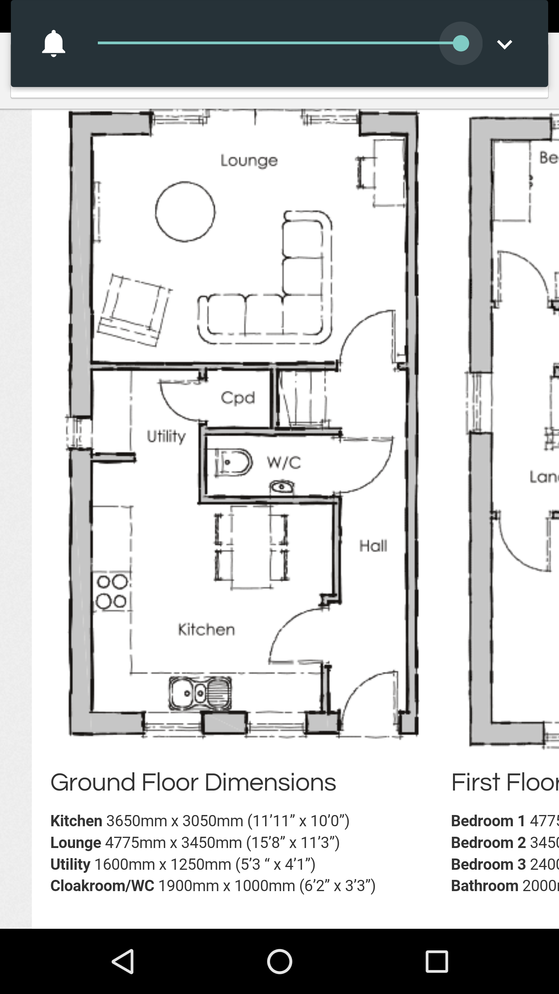

Recently bought 20m2 of 798x798 polished porcelain tiles.
Laying these in a new build property in the kitchen. It will be on a concrete floor.
I will post a picture of the floor layout.

Has anybody got any experience of laying this size tile? Worried it may look silly in this sized room , but think it should look OK. At the price I paid for the tile I originally wanted I compromised on the size of the tile. Or should I not sorry?

Just finished 130sqm running through 4 rooms today with 800x800s..spend as much time as you can with a 6ft straight edge and slc any dips in the floor, also spend as long as it takes to set out floor, don't rush it and leave it to chance, drylay a few then get your tape measure and laser line out, we spent 3hours juggling things round to avoid any small cuts, used a 12mil trowel and skimmed back of tile, definitely get some sort of leveling clips, invaluable for these tiles..
