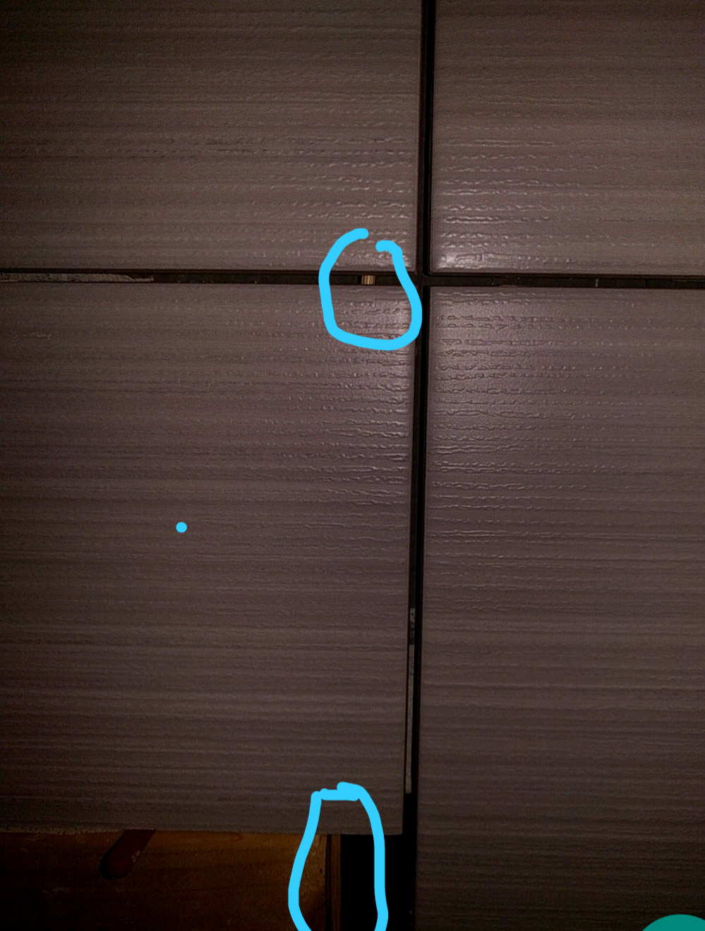

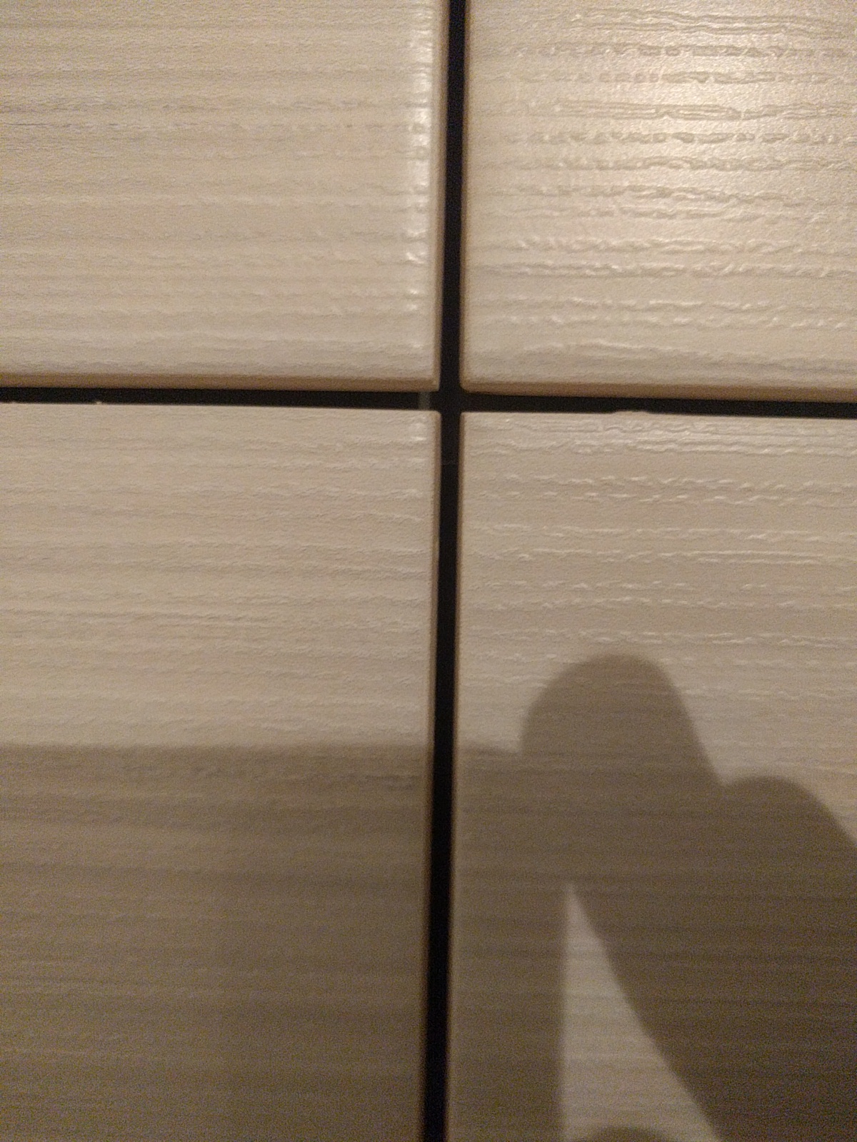

I am in the middle of having my bathroom tiled so tiles are up but not yet grouted. Forgive the silly question, but should tile adhesive be visible between the tiles where there is no grout?

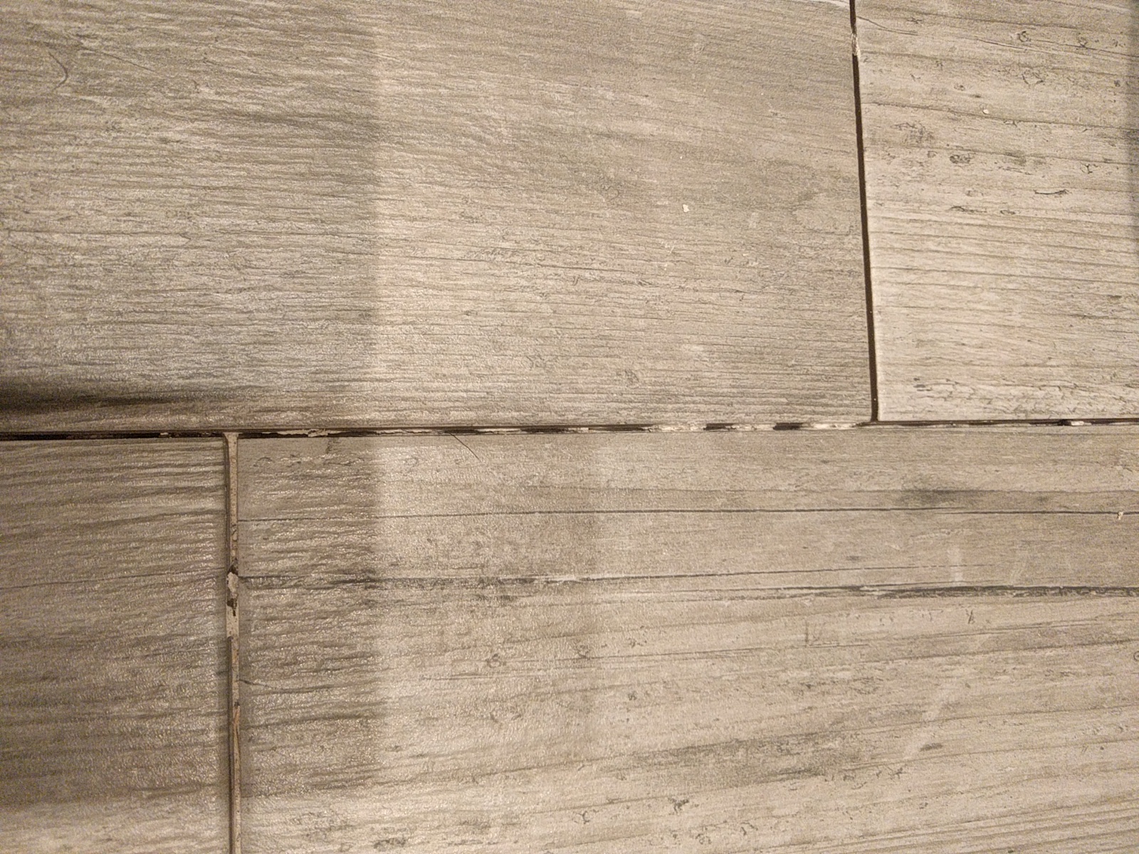

My floor tiles show what looks like a notched adhesive line, however with the wall tiles, in some places I can see the jackoboard - I think I know the answer...dot and dab, but just wanted to make sure.
spoony
The lighting is out at the moment so a bit hard to show but with the floor (wood effect tile) I can see no orange ditra matting, however with the walls I can see the green plasterboard and the black jackoboard

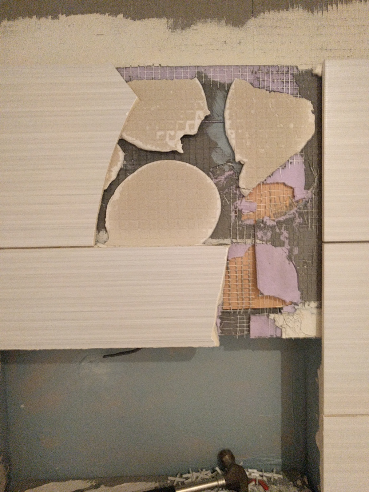

I will ask the tiler outright (too scared to rip one off!)
Assuming it is, what are the implications of this? The floor tiles seem 'correct' which is my main concern given cracking etc. What risks are there with dot and dabbing ceramic wall tiles (especially in a shower?)
I've read about British Standards but what does that mean? Is this a regulation (ie law) or a quality standard?
I'm trying to understand where I stand with the tiler. He seems like a good chap, over 20 yrs experience abroad, so I'm wondering whether he is used to older methods or standards outside the UK?
spoony

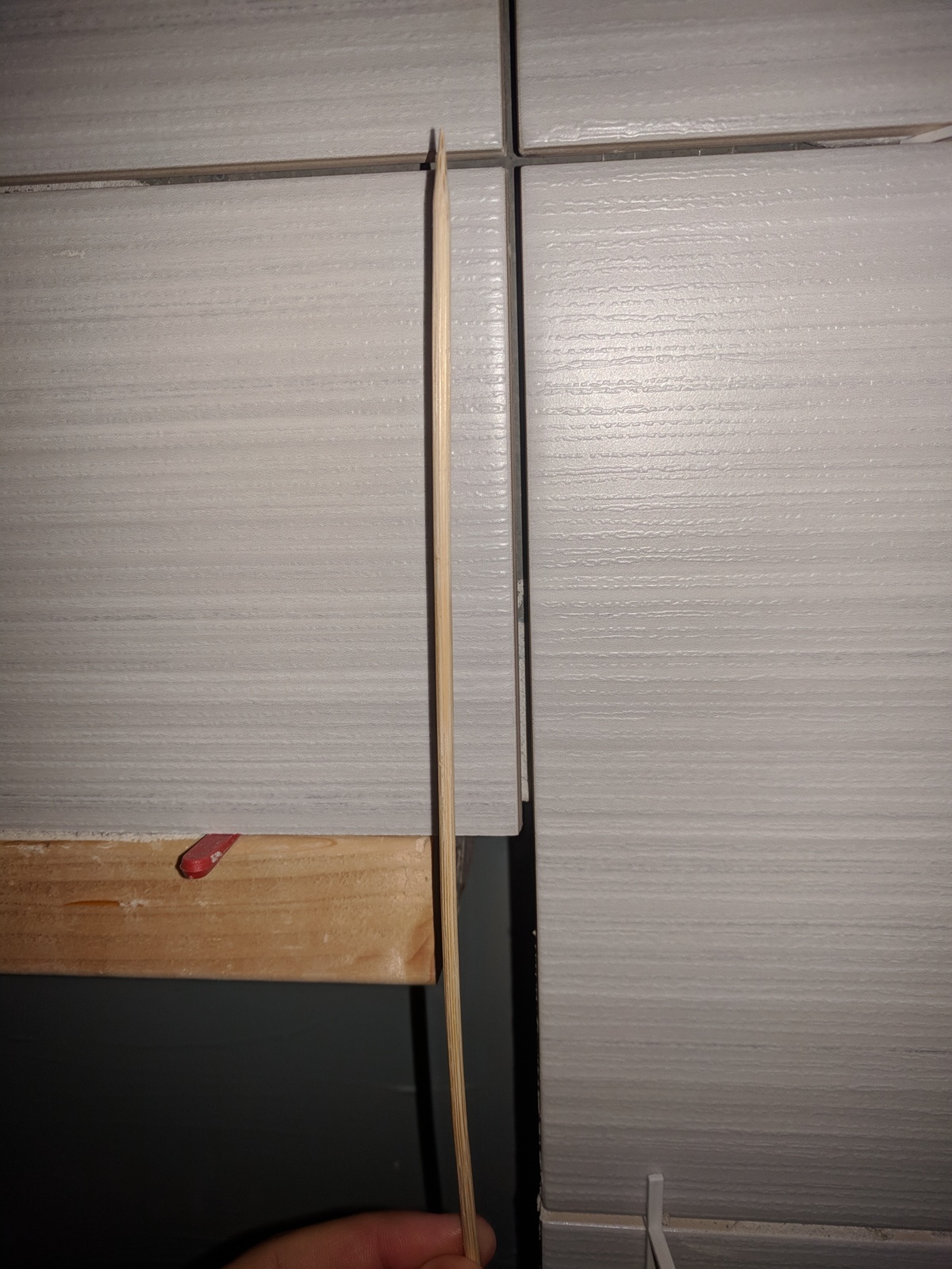

I'm about to go back to the tiler and request, at the very least, the tiles in the shower area are redone with correct coverage (the walls are half height ceramic so as a compromise I may accept these as is).

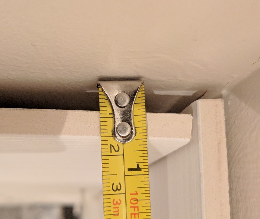

One final Question: I appreciate if a wall is not level you might need to bed out a bit, but what is an acceptable amount? The tiles seem to be up to 1cm away from the wall in some areas (this is where the trim will be and the trim is 10mm)
