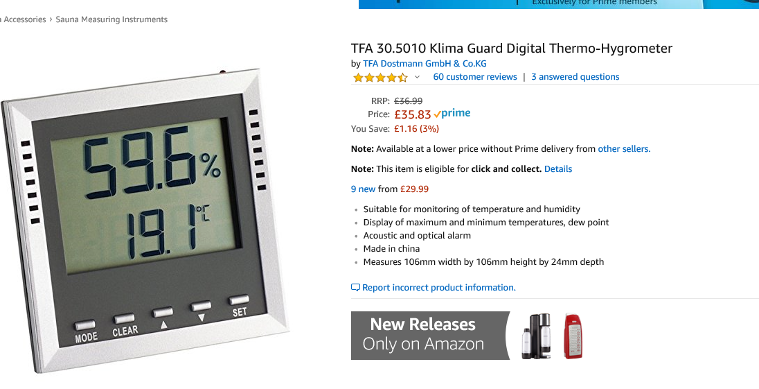

Waluigi asked about the humidity reading before the PIV was installed. Unfortunately, the Hygrometer I was using was cheap and nasty and therefore useless. I think I need to get a proper one and saw this one recommended by Heritage House who are specialist in this area and highly critical of damp proof courses. Their website is worth reading - Controlling humidity in houses - https://www.heritage-house.org/damp-and-condensation/controlling-humidity.html I would be grateful for your views on this product.
View attachment 105093View attachment 105093
I’ve only ever used the Hygrometers supplied with the PIV unit. I’ve seen readings go from 90% to 40% in 3 days. Installed a few of these PIV systems now. All in single skin dwellings where the ‘dew point’ is formed on the inner wall by thermal bridging. PIV’s are a revelation!
