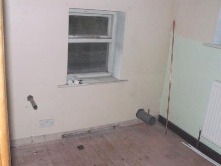

I would like a little advise on setting out and squaring the window. From the photo you can see the waste pipes for wc and sink are centered around the window, ( ignore socket it has been safely removed ) which will take presidence when setting out . I will be using 400x250 ceramic tiles and a 3tile travatine mosaic as a border to finish half way up the window. I want to keep the window sill. I will be using a piece of plastic trim between sill and mosaics and but jointing the mosiacs at the top . My questions are do I cut sill to accomodate tile or cut tile to accomodate sill ? and in which order do I tile ? Do i tile from first full tile at bottom to level on sill, then square window , tile up sides of window . or tack up trim to squared measurement of window and then tile to this , followed by tiles in reveal?
any advise appreciated.
