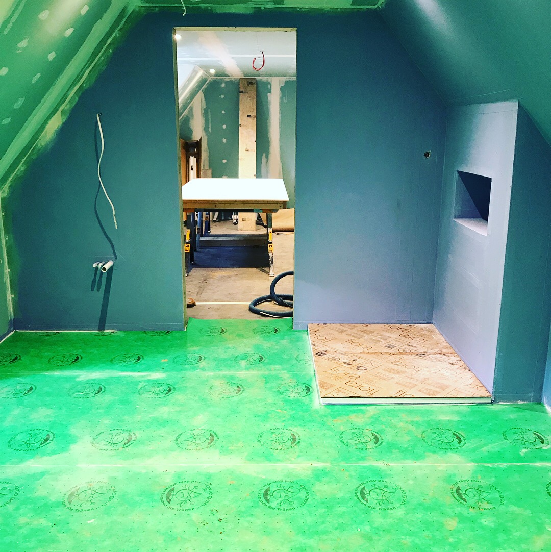

Green waterproof antifracture matting over ufh
95810B95-26FB-49D6-B2C0-470704F8530F.jpeg D9F0DDD5-7A3D-4047-A2F7-5BEA295352EE.jpeg
Ready to be tiled
