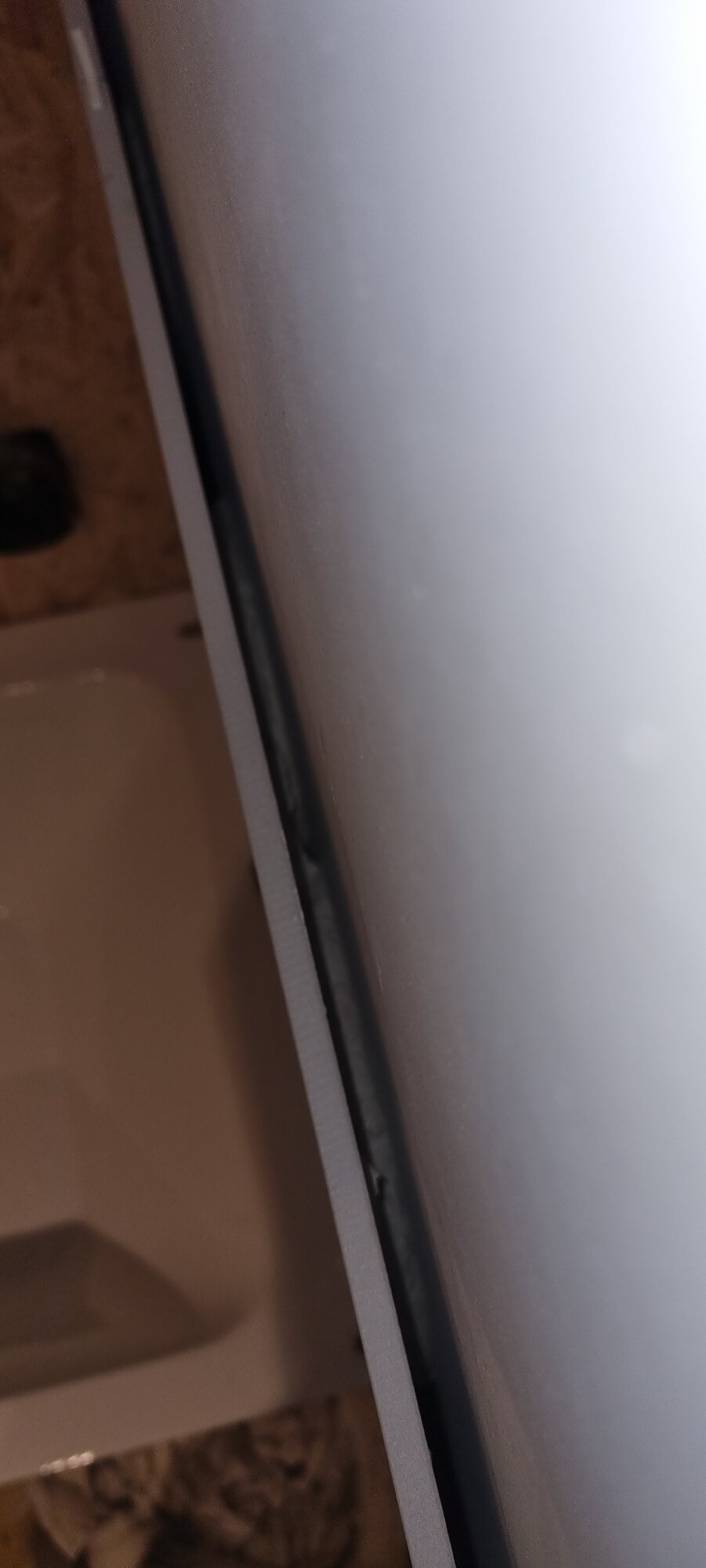

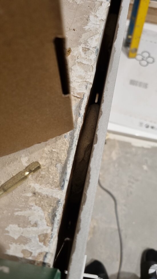

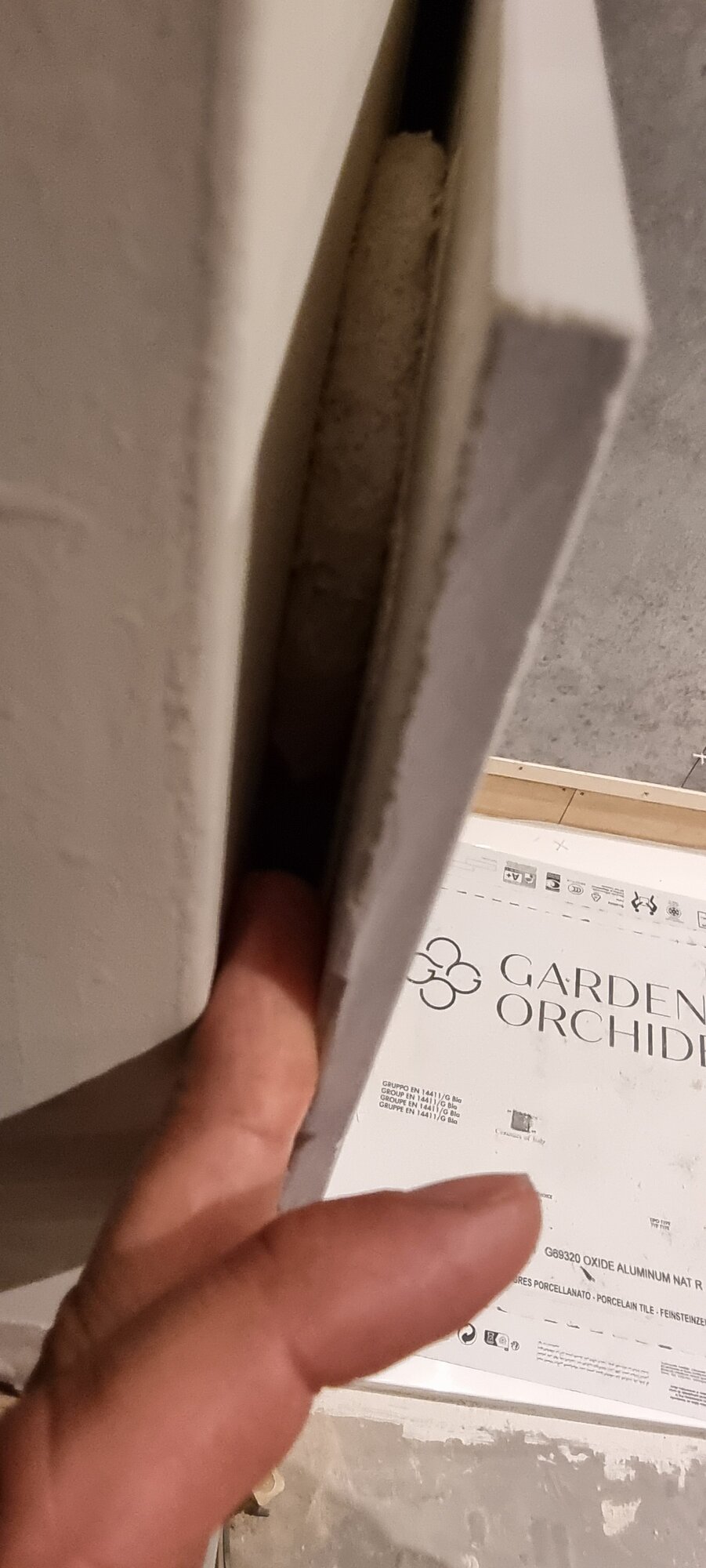

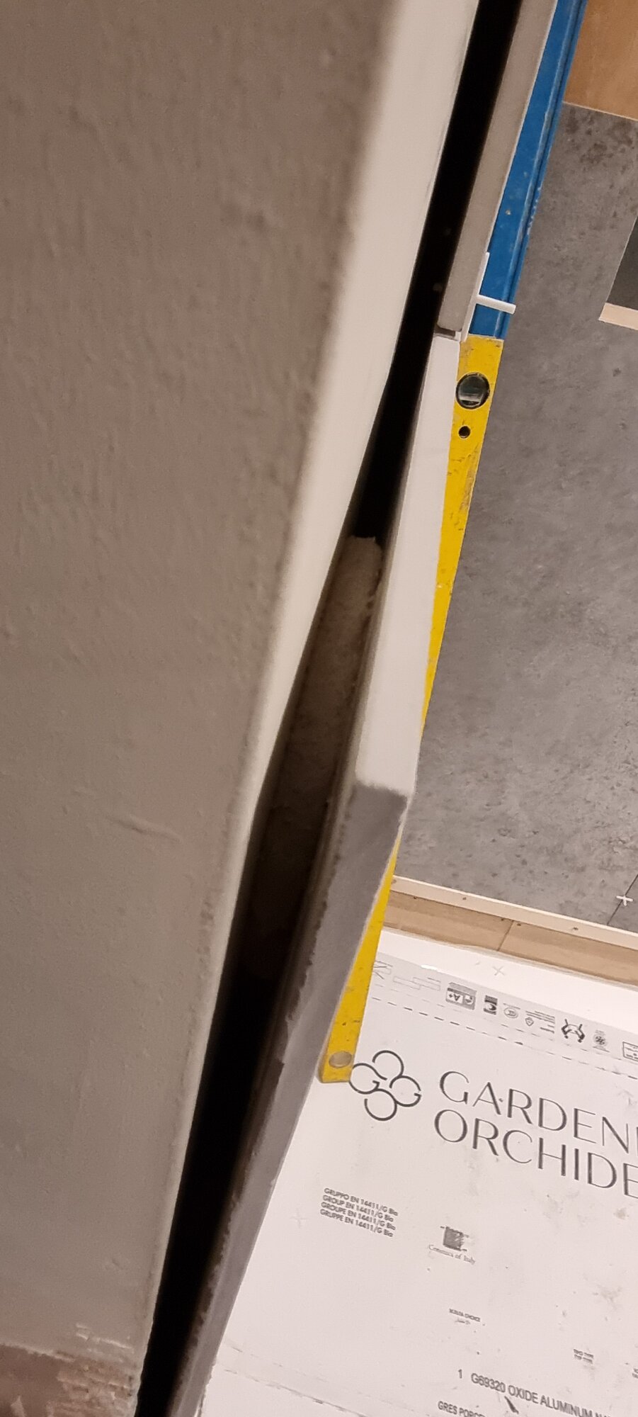

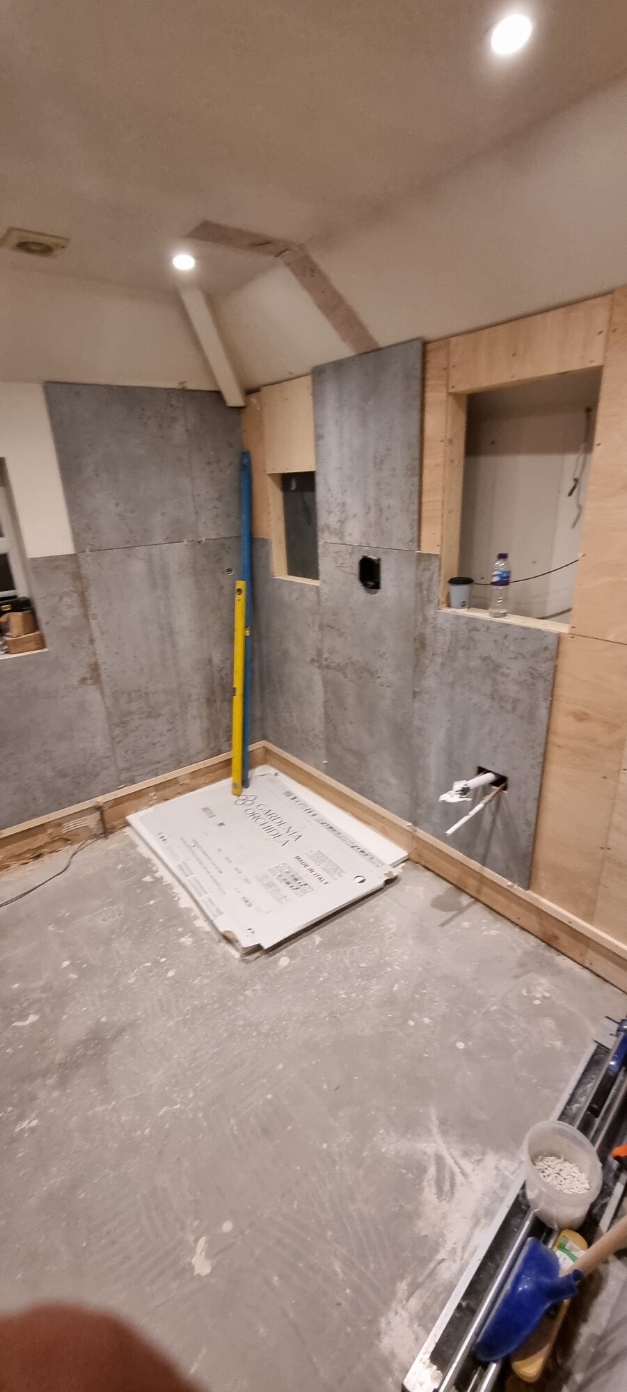

The biggest issue I have, is that he has dot and dabbed the tiles to the wall. 800x800 porcelain at 8mm thick. His excuse was that the wall wasn't level, which is no excuse really because surely he should have leveled the wall before tiling. I called him out on it, he told my Dad it is perfectly fine.
He then proceeded to dot and dab the tiles onto the new wall that he built, which presumably is flat and level. Although he has done it in ply, which to my understanding isn't a suitable substrate for a shower wall?
There is no tanking on the plywood shower wall or under the bath.

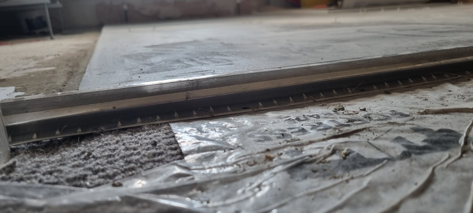

I then came back yesterday to find the bathroom floor is about 16-18mm higher than the hallway carpet floor, which means a massive lip.
To top it off, it looks like the floor has been dot and dabbed too.

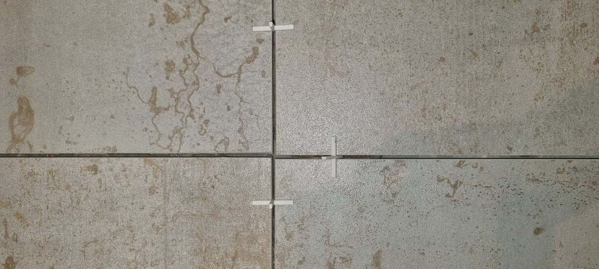

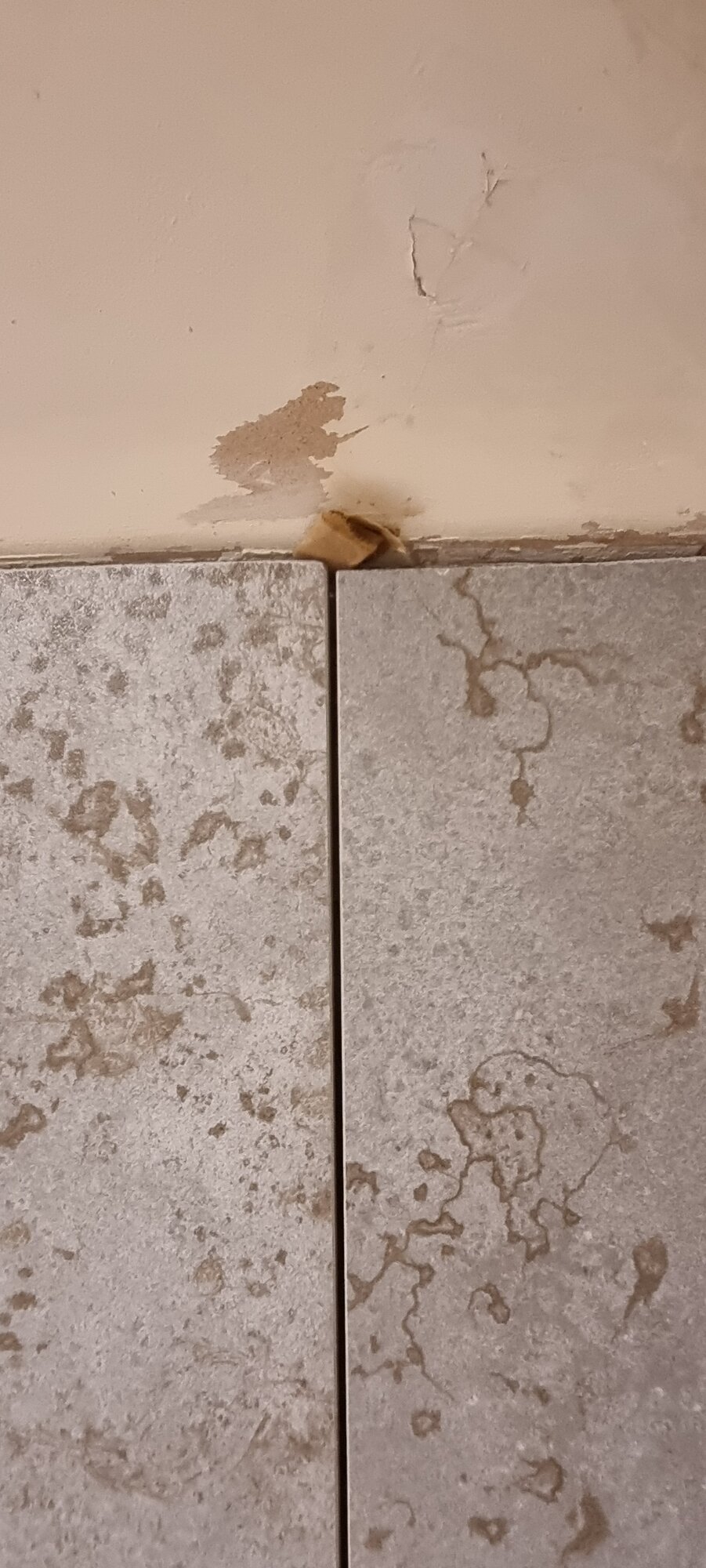

Some tiles aren't lined up properly or grout lines are different widths. Not big discrepancies, but considering the size of the tiles and there are only 6 tiles laid, seems a bit pony to me.

He installed took the tiles off and installed tile backer board...then proceeded to do a bad job.
I told my folks to sack him off, unfortunately they didn't listen. Now he says they're just being fussy, thankfully they withheld the next payment, so there is that. I will post some photos of the mostly finished job.
Also no tanking or anything under the bath.
Oh and where the tiles aren't cut level.with each other, apparently that is ok because they will mask it off and paint over the tiles 🤣🤦🏻
