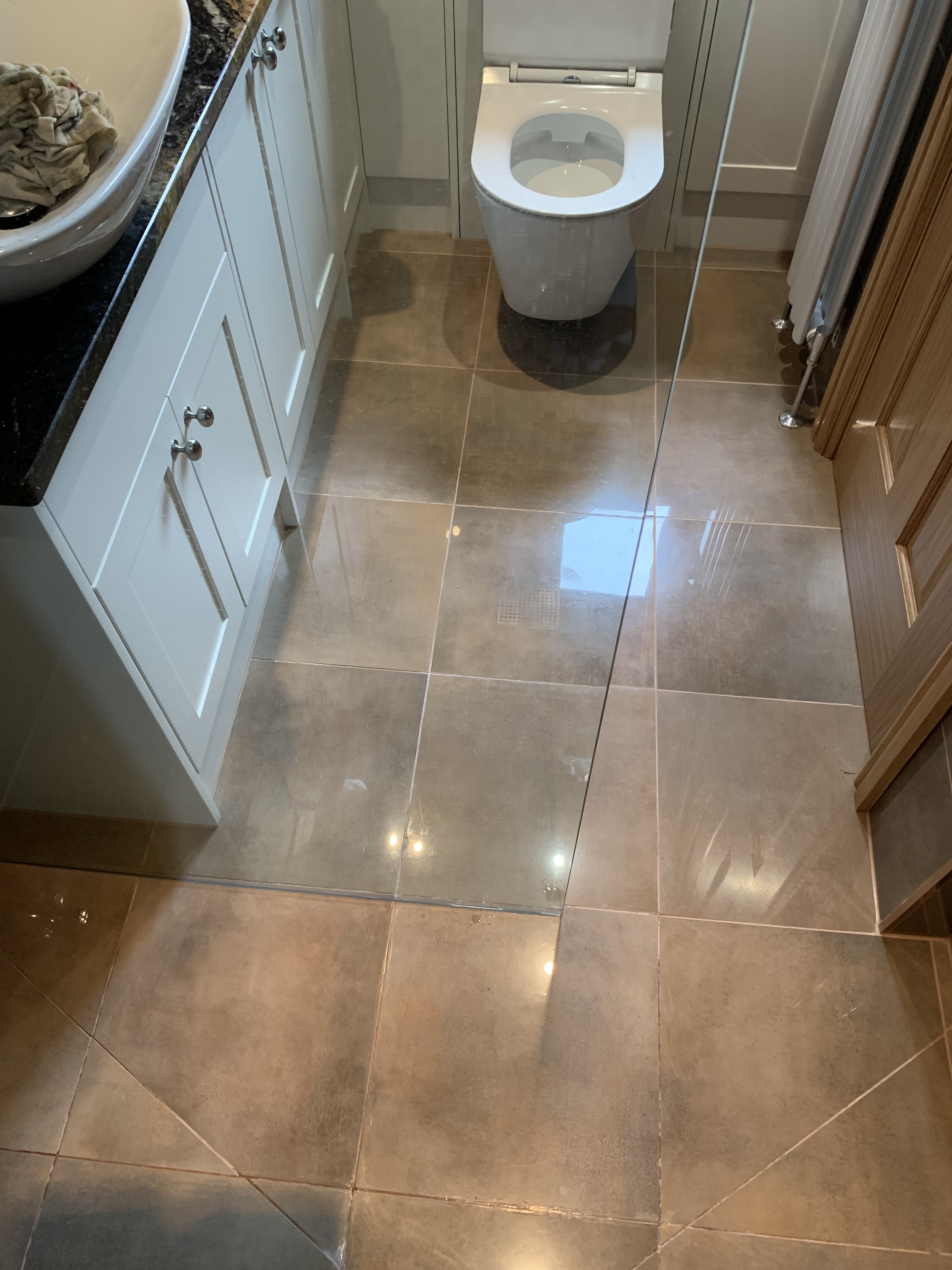

We had our bathroom completely re-done last November. We hadn’t even started to use the shower before the grout (Mapei) had started to crack in the shower area. The tiles in the dry area have also cracked and move now.
This is an AKW tough form (fitted straight into the joists with extra noggins) with a Norcros wetseal tanking kit tape and liquid. The tray was 60 grit sanded to give a key and tanking liquid painted all across the tray and 1m up the wall and 500mm onto the plywood dry area.
Here’s the first problem. AKW said you only paint the taped areas as it won’t stick to the tray. Norcros said paint everywhere .
12mm ply was fastened correctly over the floorboards (not glued though) and tile primer used before tiling with a ultra pro flex rapidset adhesive.
The tiler can’t understand why it’s done it and neither can the Mapei rep when he came to look. He just said we must have movement.
The whole floor has to be removed and redone. The hard part is who is to blame? The tiler has offered to re-tile it for free if I buy the tiles(porcelain) etc. The work on the walls is great.

Most if not all ply now is rubbish. Very thin veneers of hardwood which delaminate with the water in the tile adhesive as it tries to bond, and often contaminated with agents to prevent sheets sticking together.
Tanking liquid painted all over the tray you say?
So an SBR (maybe water-based) liquid onto a sanded composite.
Probably hasn't bonded well at all. Then the tile adhesive which will bond very well to the tanking liquid has probably also helped "pull" the now-dried tanking further off the tray.
I always fix a waterproof membrane like Kerdi or Mapeguard WP to trays using something VERY sticky like Ardex WPC or Kerdi-col. Never had the problems you have here.
The blame is with poor advice first from your supplier but also really with the installer who should know better, or have checked.
...I just checked, the Norcross tanking kit is water based so it's never going to stick well to composites.

Its a hard one to put numbers or a remedy to, I would think that once the floor tiles have been removed, the tanking system may well be compromised, or at the very least its life span shortened. I also would look at removing the first course of wall tiles. Once removed, carefully inspect the system, if you are happy do a flood test for 24 hours, if you are lucky, and all you Christmases come in with the Derby winner go for it. If there is movement on the outer floor, strip it out and go again, Dont skimp, you have been there now. In fairness I would not expect the tiler to be responsible for all this work though.
So can you lift a tile in the dry area? This will tell you if the water has leaked into this area and probably warped the ply causing your loose tiles.
The grout lines are not your problem to be causing the leaks, it is what is going on under it, i think @impish is probably bang on and your tanking liquid has de bonded from the tray taking the tiles with it. You haven't mentioned adding a membrane this time which is the main advice being given so add that to your list. Remove the 12mm ply and replace with a backer board something like 12mm Jackoboard which is waterproof also. CTD sell it if you have one close and for the size of area you need you won't be spending much more than ply.
Paul is also correct that you will most likely need to remove the first row of tiles as all the taping/tanking seals will most likely be destroyed during removal so it would be best practise to do up to this row again.
You can do the mosaics no problem but yeah go for Epoxy, belt and braces this time!
