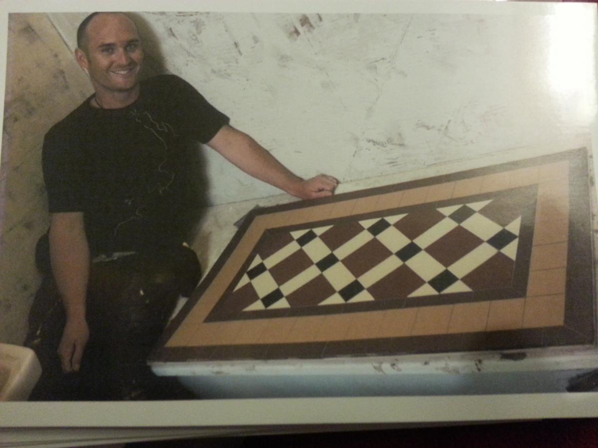

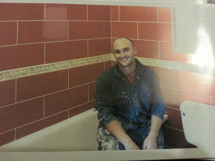

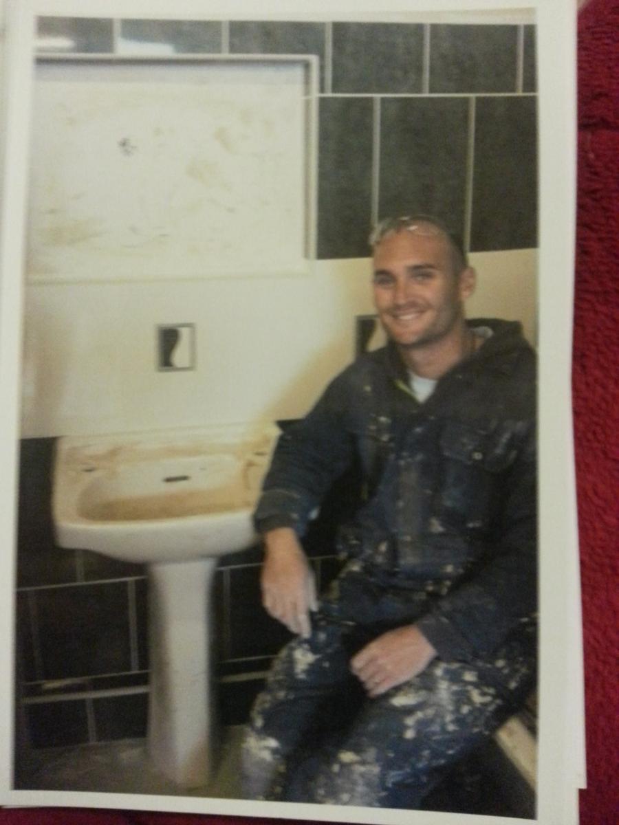

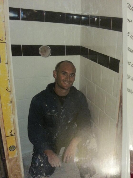

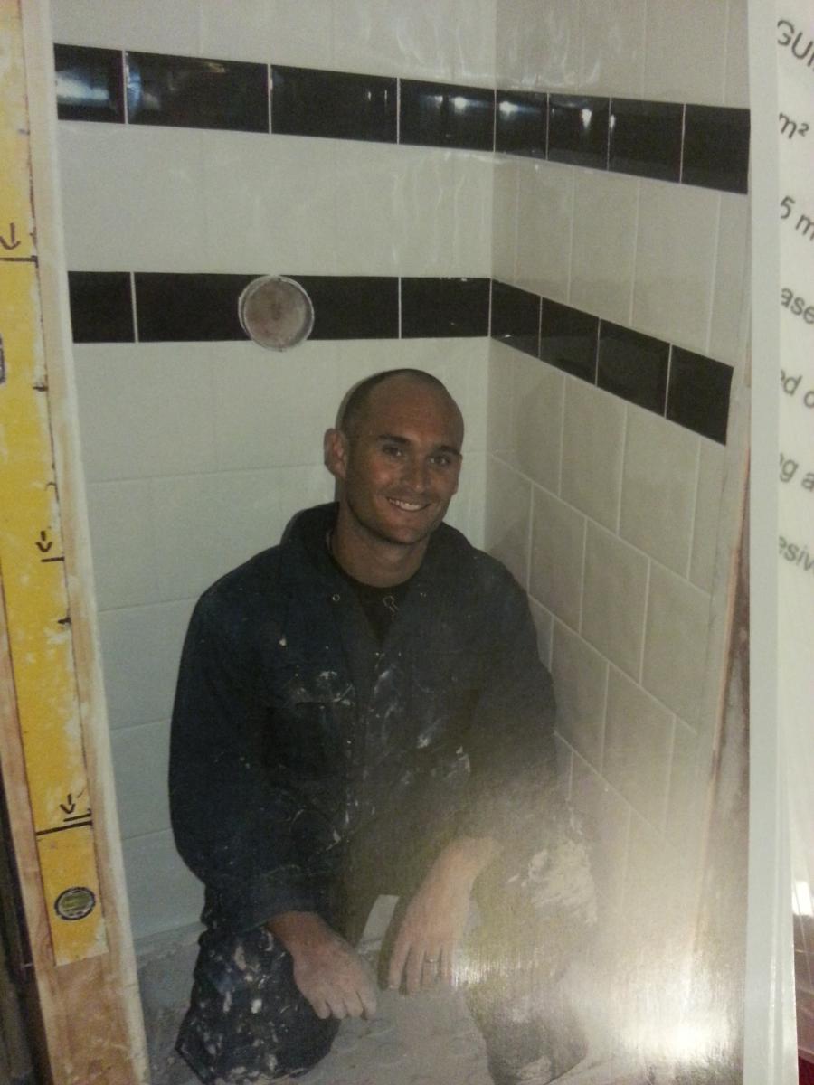

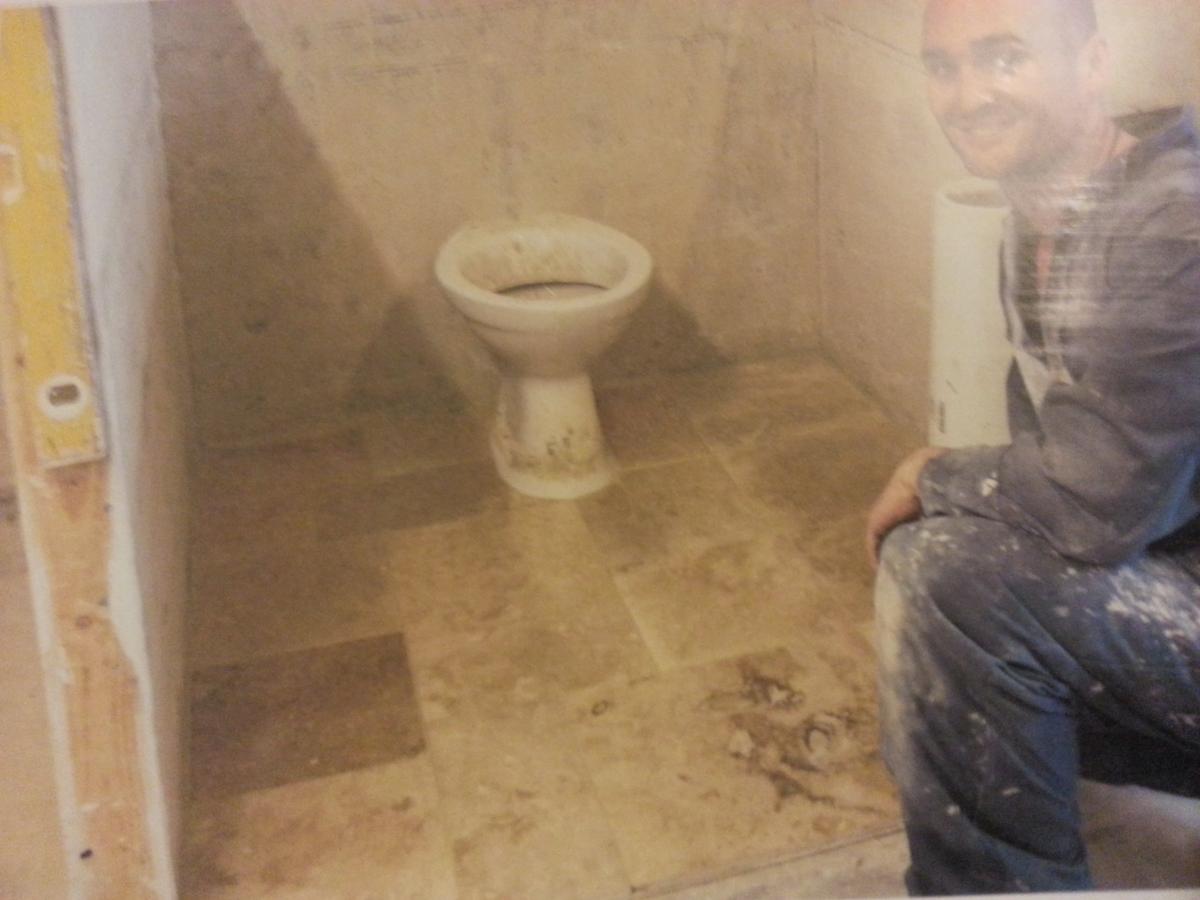

These are the photos, but they are pretty poor quality as i have not got a scanner. so i have had to take photos of photos
View attachment 50523View attachment 50524View attachment 50525View attachment 50526View attachment 50527View attachment 50528View attachment 50529View attachment 50530View attachment 50531View attachment 50532
the next picture is travertine tiles which layed, sealed, grouted, sealed again and then polished

i am Sorry to say that non of the pics are any good as evidence for an NVQ portfolio the pis are all of you standing or sitting next to some tiling there is no evidence there to assess. You need pics of you actually working on a wall or floor, and all the work is in a training centre the pics that you need are of actual jobs you have done out in the world. My advice to you is go and talk to a college that dose tiling and get yourself enrolled on an NVQ and start to gather evidence that this is your day to day job.
The evidence will need to paint a picture for the assessor he will need to see that the work is genuinely yours and it covers the all the relevant criteria. It is no good having a pic of a bath wall with a nice pattern on it if the unit calls for evidence of you tiling around a window.
To be honest you really need to see the units that need to be covered for an NVQ then you will understand how much more evidence you need to produce.

I must say that from an assessment point of view the pics as they are even if they was site based are not usable evidence as he is just stood next to some tiling there is nothing to lead the assessor to believe it is his work. And if you study the pics some things start to pop out that may make an assessor require further evidence.
Even site based evidence has to hit the criteria and be shown to be authentic.

The things i would pick up on in the pics you have posed are more to do with what you are wearing than your tiling.
in 1,6 and 12 you have on a red t shirt in 2,7 and 8 you have a black one on in 5 and 13 it is white and you have protective glasses on your head.
For me it is things like that that say the pic was staged as you did not do all of that in one day and if it was staged was it even your work.
you have to make the assessor have no doubt in his mind that the work in the pic is yours where ever you can have pics of prep work and setting out. To an assessor a pic of a half don job with you fixing a tile or spreading the adhesive is worth more than a pic of a lovely finished job and you stood next to it.
No I am just pointing out that it looks like those pcs was took on the same day or two or three of them was and then another two or three next time and that makes me doubt the evidence so I would have to ask for more and in order to complete the NVQ quickly with the minimum fuss the evidence needs to be beyond question. cover all the criteria you can in one pic rather than having to keep taking pics of the same task.
As I have said I am not knocking him just trying to help him see things from an assessment prospective.
