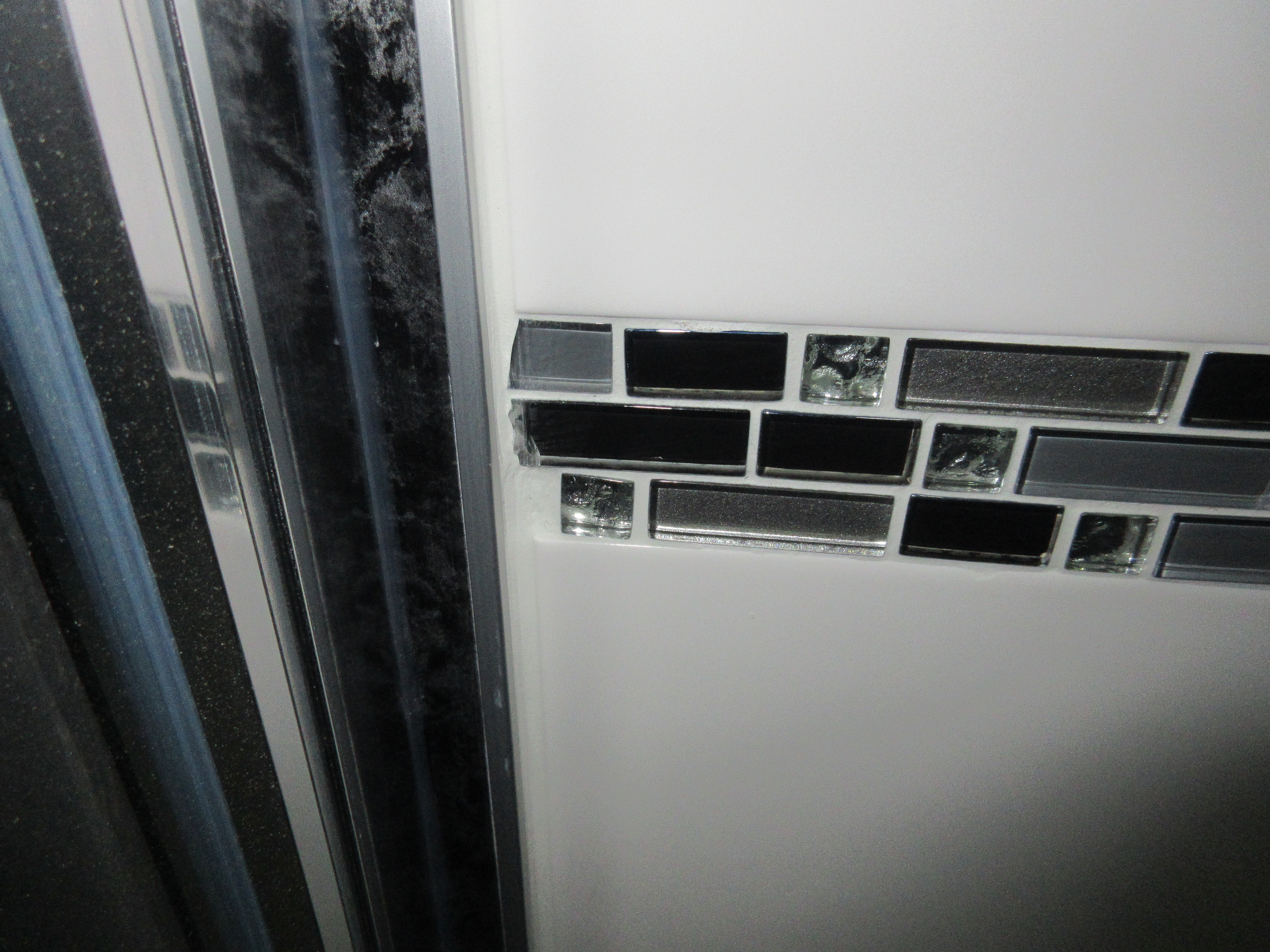

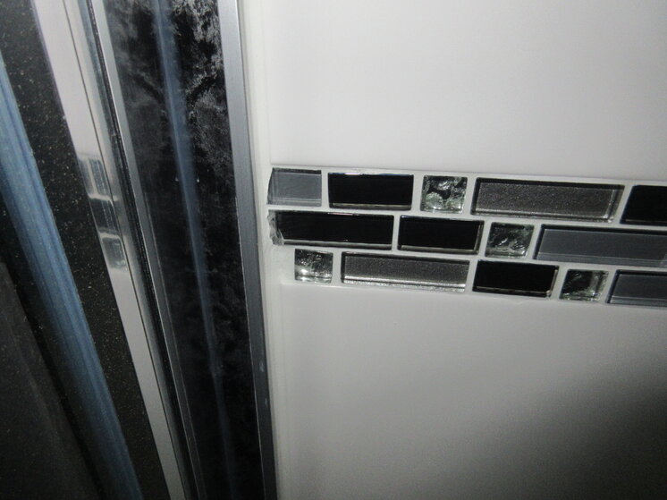

To me, it looks like a decent DIY finish, but not a professional 'luxury' finish that we were promised. I've attached some photos, but the main problems are:

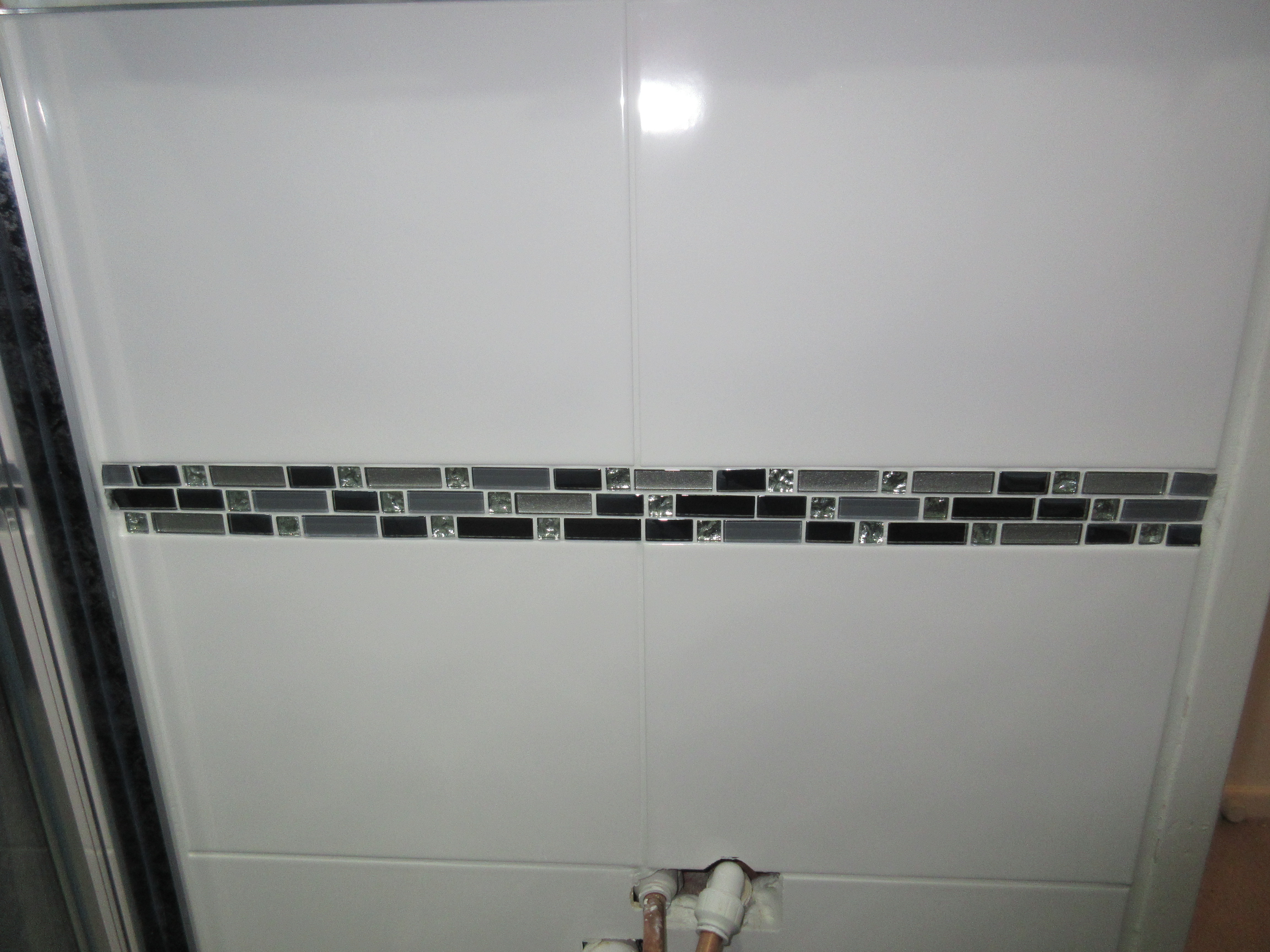

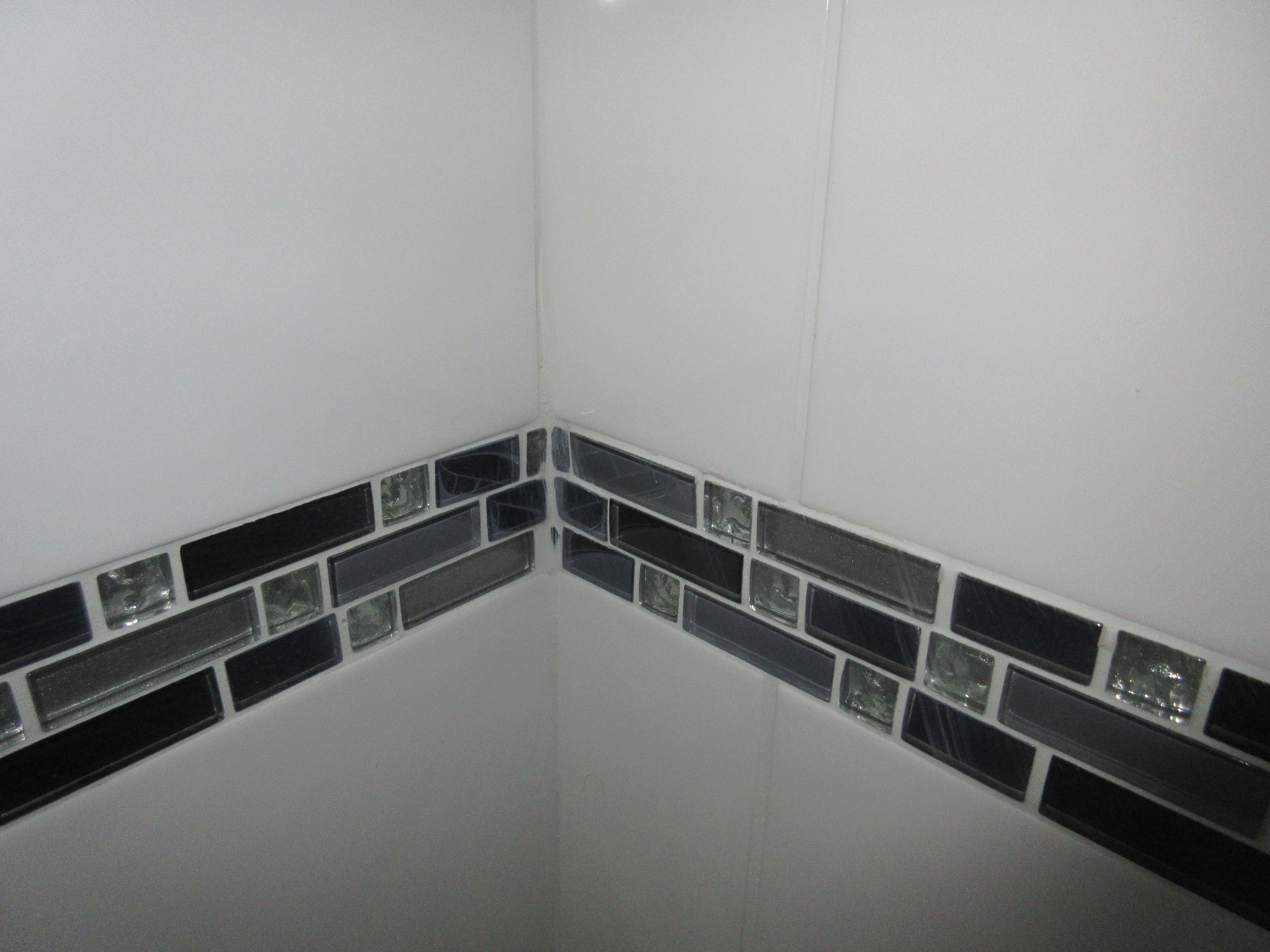

- mosaic tiles do not end in a straight line at the end of walls.
- the wall behind the sink is just about 68cm wide. The tiles are 33cm wide. They've used two fill tiles to fill this space, which means we have almost a 1cm fill of grout down the side of the door frame.

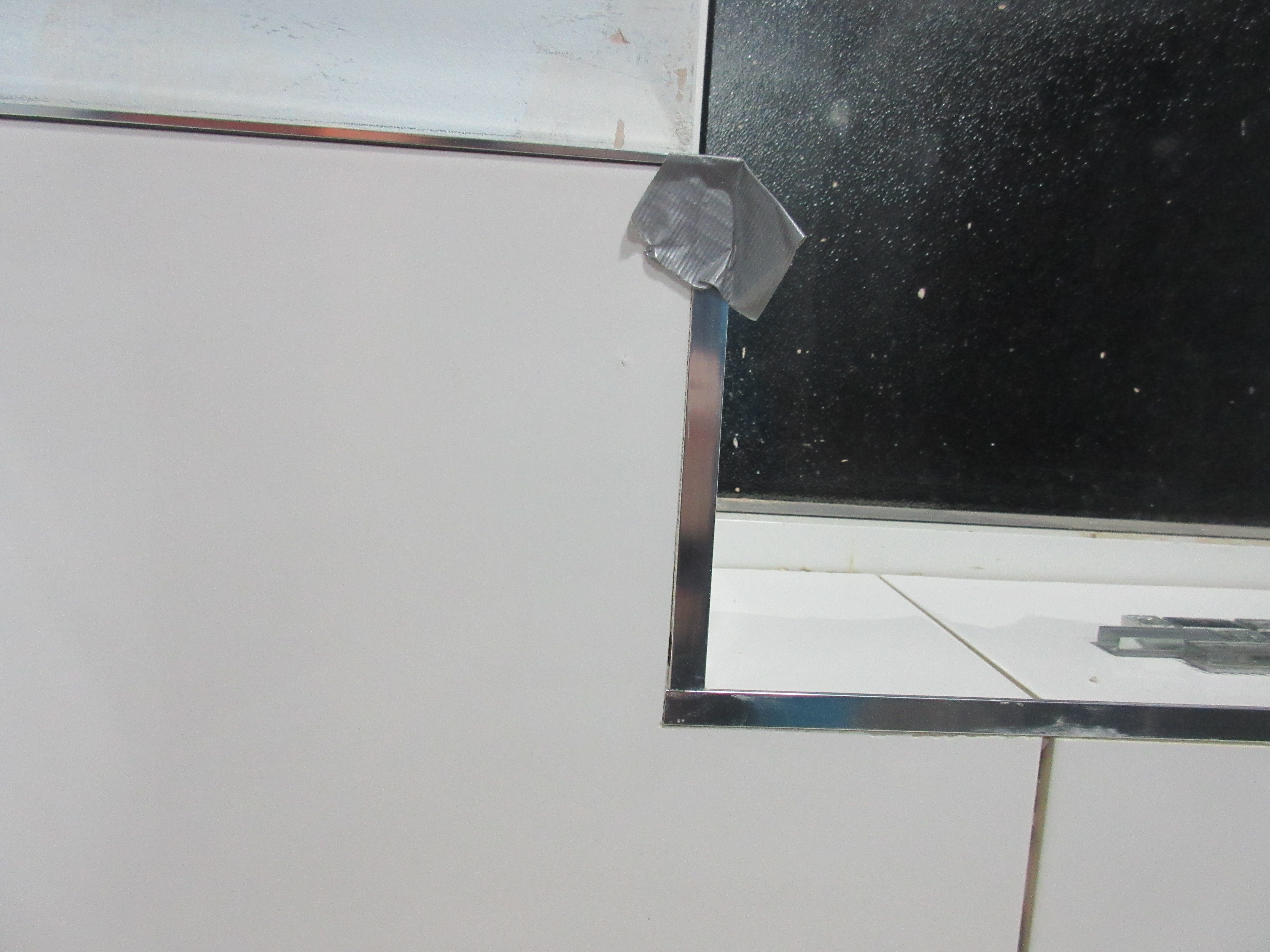

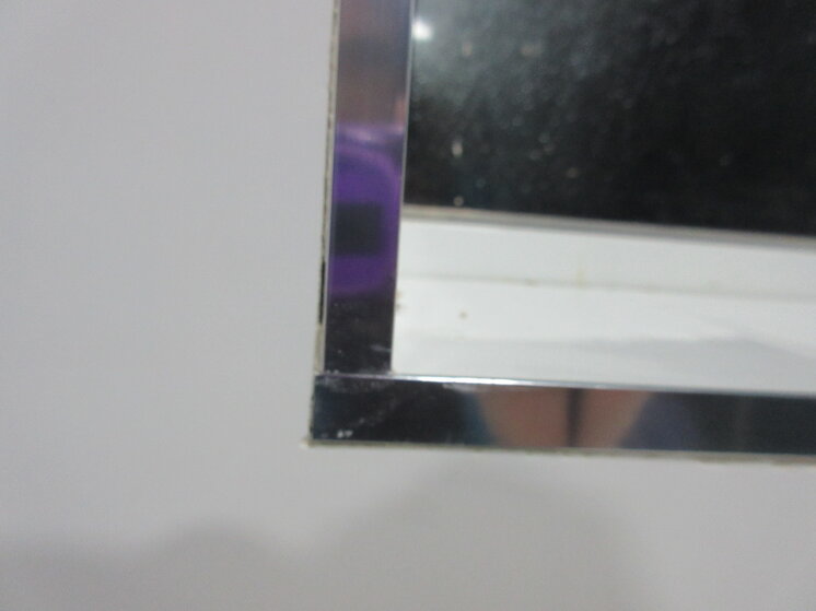

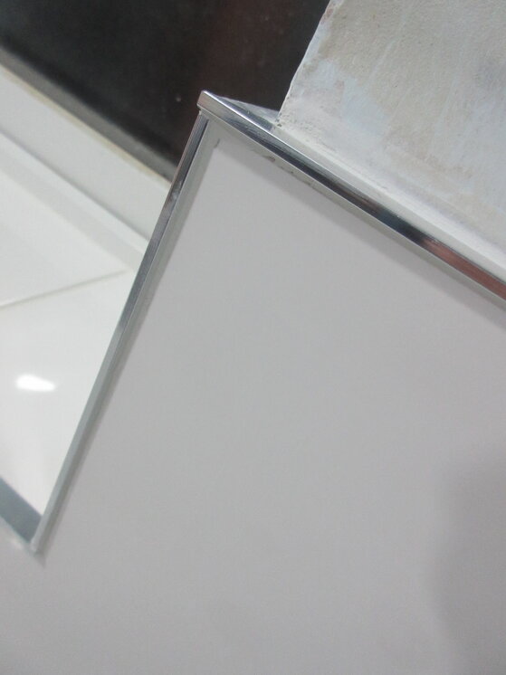

- They've used 1cm chrome tile trim on a 7mm tile. This means there is an overhang, and where the corners around the windowsill are mitred, there is a very sharp (dangerous!) point. They have filed this down, but its still sharp and sticks out.
- The corners are mitred (they weren't to begin with and I had to get them to do it again) but they aren't very accurate, with the gaps filled with grout.
- some tiles are irregular.

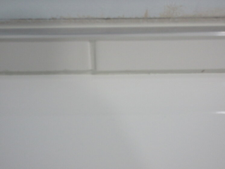

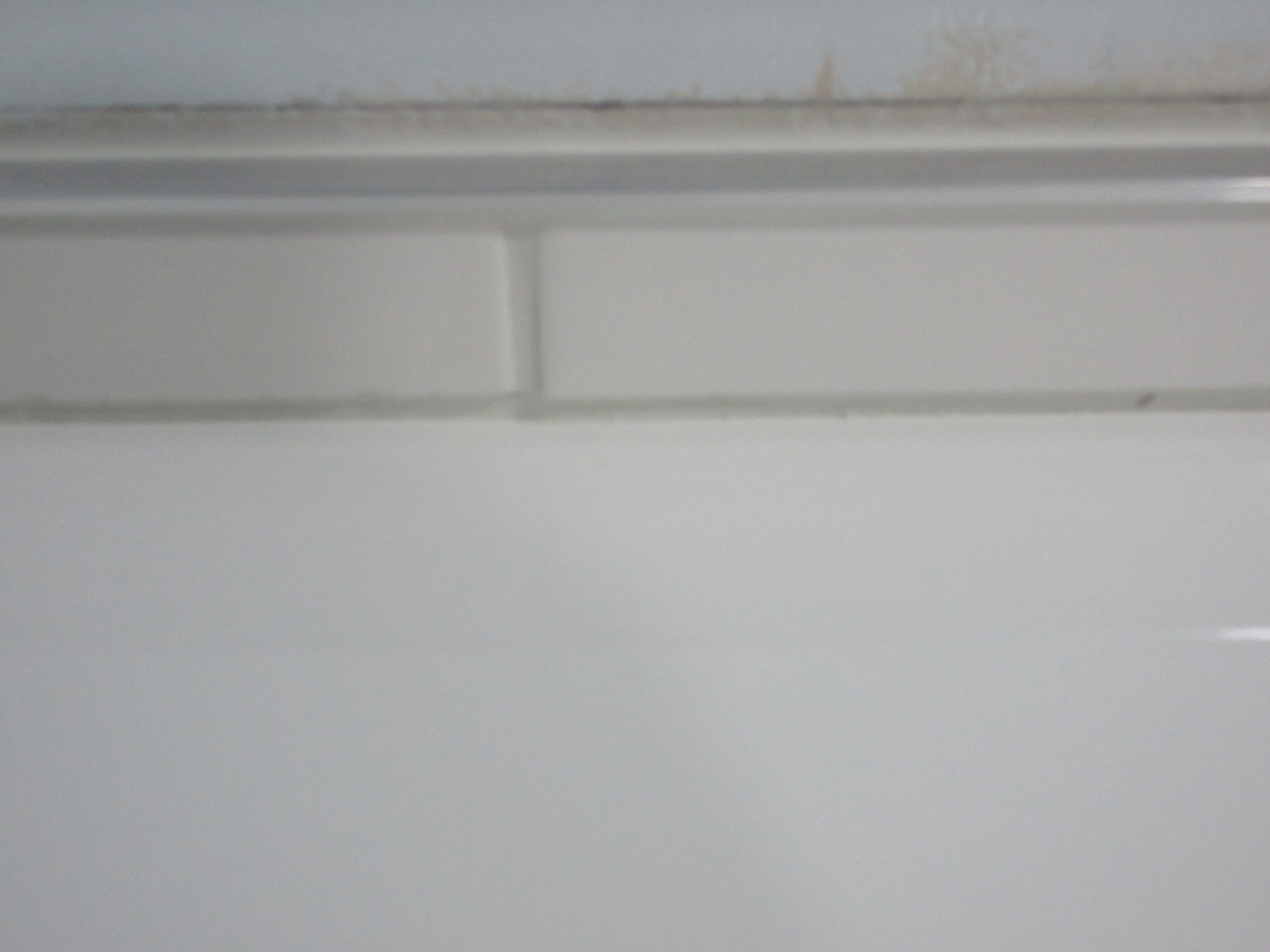

The top picture is a bit out of focus, sorry! The tiles aren't cut to the same size, so they don't line up. This is right above the cistern cover.

from your first post concerns:
mosaic in corner is poor and should be corrected;
the two tile wide wall probably looks better as two tiles rather than a centre full tile and two equal size (slightly bigger than half tile) cuts. New architrave slightly wider or moved over is a possible fix to loose the wide grout joint;
Wrong size trim is not acceptable If it causing overhangs/lipping;
Sharpe corners on trim (or anywhere) are not acceptable;
unsightly gaps in trim joints should not occur.
Changing the trim will be difficult as the tiles under it will probably need taking off (they would if I'd fixed it). I also note that the way the trim is fixed around the window is not the way I'd expect most professionals to do it - well the ones I've worked with but others may disagree.

Thank you SJPurdy. Can I ask, how would you expect the trim around the window to go? He did it the other way around to begin with and it looked awful ('ll find pics and post in the next post)
Interestingly, I spoke to another tiler today, as I am looking for a local independent opinion. He knows the person who walked out (by name/reputation only) and said it was because he will only tile on smooth, plastered walls. Is this a good or a bad thing?
I've tried around the walls with a straight edge. Under the sink - where it was dot and dabbed - the tiling is noticeably bowed forward at the join of the tiles. Is this a practical problem (ie. is the sink likely to fall off the wall?!) or an aesthetic one (ie..e no one will notice unless they are having a bath with a spirit level)
And thank you, I really do appreciate the time you guys are taking to answer my questions 🙂
Freda42,
Yes that is the way round that I would have instinctively done the trim unless requested to do it the other way. I again think it is not jointed very accurately which detracts from it. I can see that you may prefer the look from afar done the other way as the thin silver line would match that on the top of the tiling. This is a caution to other prospective tiler clients reading this to specify/check how things will be done.
