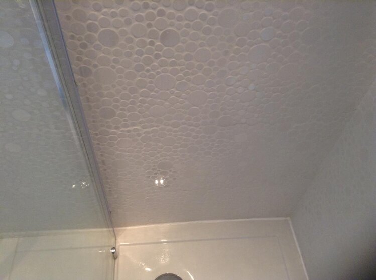

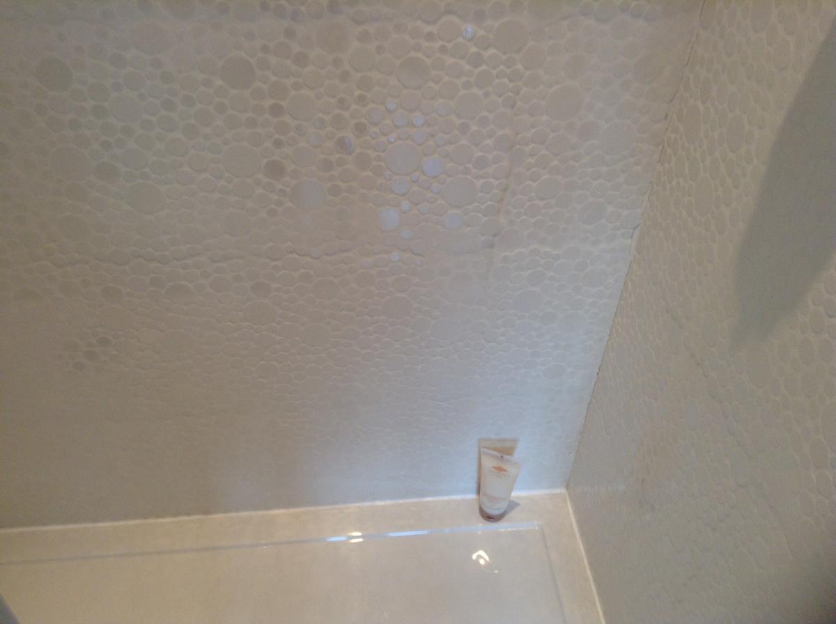

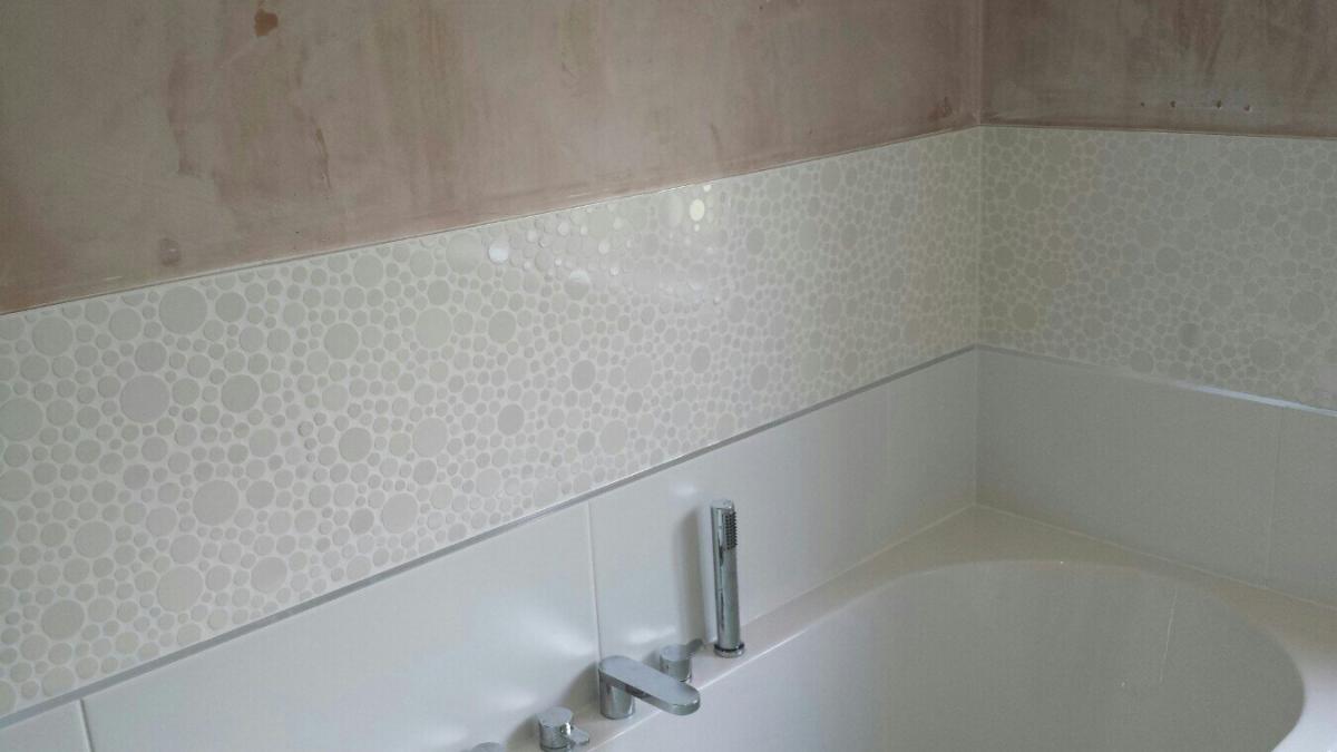

This was done by a tiling company based in wilmslow!they blamed it on poor lighting? Joke!! these are from Porcelanosa

BSI 5385 4.2.2 Lighting on site
Lighting on site should be of similar type, direction and intensity as
envisaged for the completed installation. If this condition is not met,
then the appearance of the finished wall might be different from
that originally intended; it should be appreciated that serious
consequences might then result, including the necessity for complete
retiling.
