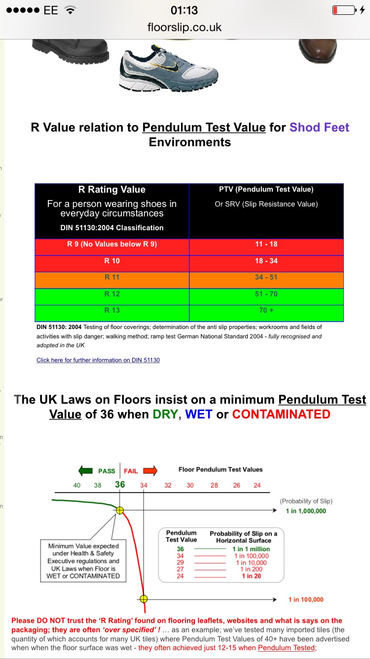

Just wondered what peoples thoughts were on using R9 rated tiles inside a shower enclosure?
I'm a sparky who has done a bit of tiling in the past but I'm not attempting it this time as I want a proper job doing.
We've chosen the tiles and I've checked with tiler if these are going to be ok and his response has been that they should be but if they are too slippy then we could always put down a non slip mat.
Just wondering if it might be better to go down the shower tray route.
Any thoughts appreciated
Thanks
