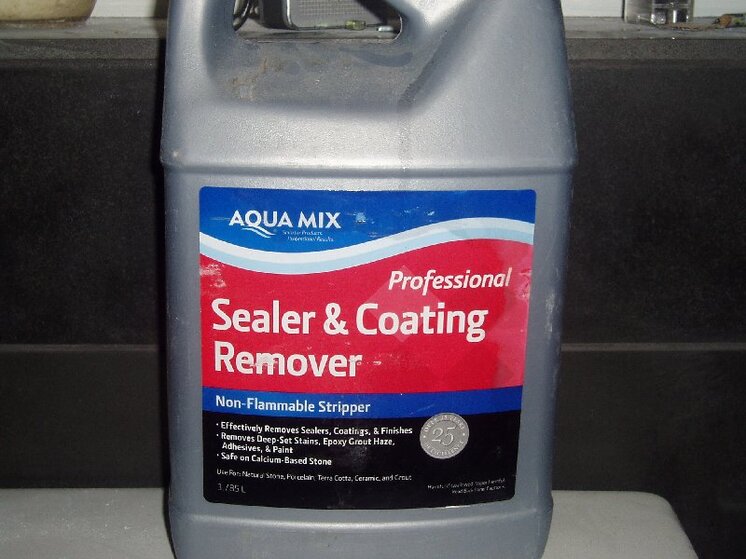

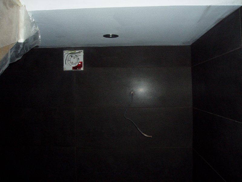

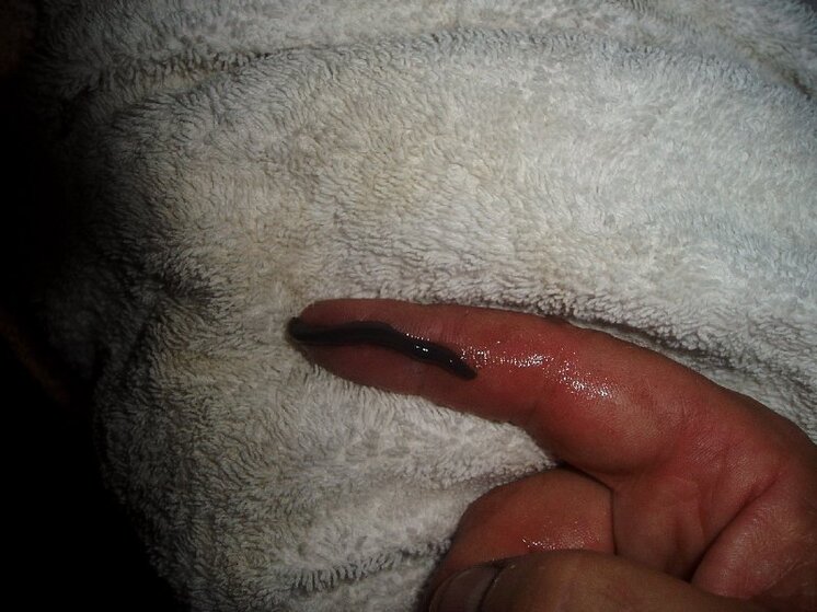

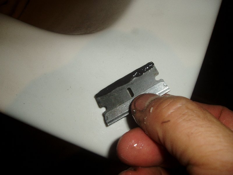

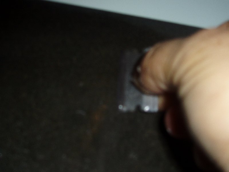

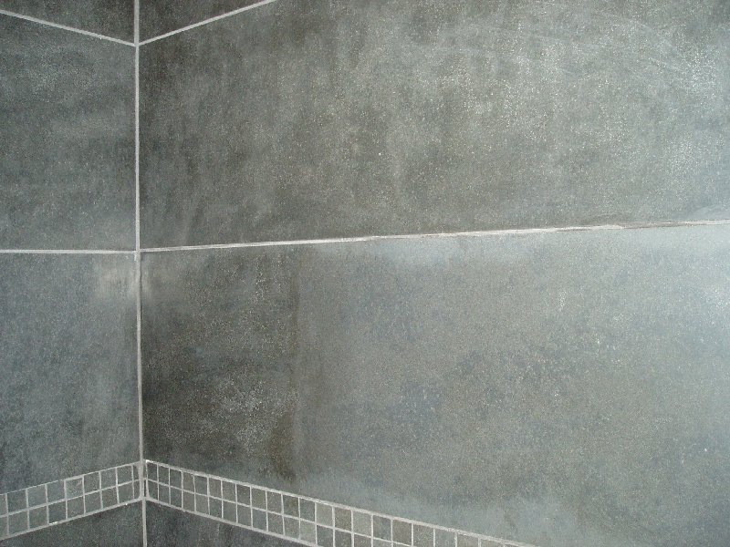

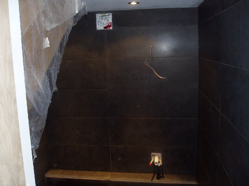

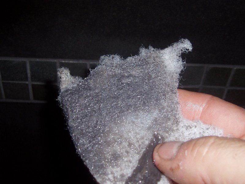

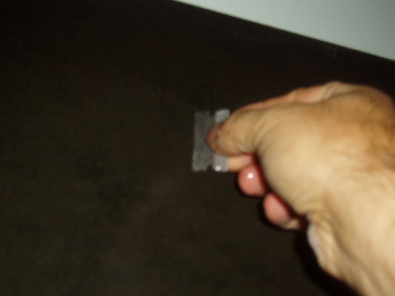

Been on a job this week where the tiler was thrown of the job due to poor tiling...There are 4 bath rooms and he had tiled three and i have finished the last one...Now i have to fix the other bathrooms, cracked tiles, remove grout where there should be silicone etc. But the main bathroom has black Basalt tiles on the wall and the client wants them removed due to the sealing problem. So i got some Aqua Mix Sealer & Coating remover out of the van...Put some onto a tile on a wall tile and waited a couple of minutes..then scraped with a razor blade and the sealer came of in thin strips :yikes: I think i can save the job being ripped out as the client was happy with the results. Poor Knowledge on sealing i think!!! Will try and get some pics of removing the sealer next week.
