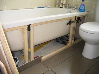

No matter what backer board is used (cement board good as any) it needs to have a small frame work built between bath lip/sides and floor. Board should be at min 12mm thick and screwed to batons, best primed and when dried use flex adh and grout. Silicon edges all round to give flexible joint and seal

it needs to have batons running down the frame not just a square frame. should look like a stud wall. hope this makes sense.

Yes as peps say not plywood but also plasterboard can be used i always put board flush with the timber frame and cut slots out where the metal frame for the legs are so the tiles go under the lip of the bath stops any water damage or unsightly tile trim then cut a hole 10mm smaller than a tile for the access panel so that the tile just sits against the panel and Silicon the joint which can easy be cut out if ever needed 😛ete
This is what I do:
Neat work macten !! good pic

Thank you everyone this is a great help ,especially pictures as I know what to look for !!! I will ensure that he does this and check all he does ..

A frame like Macten builds and 12mm aquapanel which you can pick up in the likes of B&Q warehouse.
