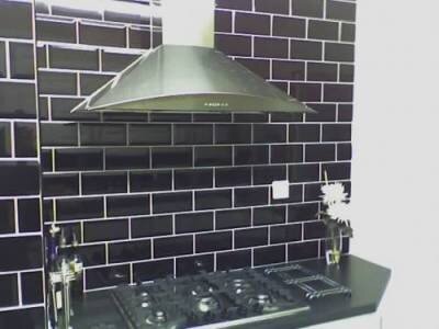

Well this is white would look like
Colour Republic
Thanks for sharing that - they look lovely!!, can't wait for mine to go up now! Oh you have me in two minds now.... but then again these are against a White Kitchen, I am having darker cupboards, do you think it will make much difference??
Does that mean your having a two tone kitchen? base units a different colour to the wall? If so what colours?
Colour Republic
I'm having off white walls with Walnut cupboards and black worktop and obviously the black tiles. The kitchen is very bright, massive window.
I just thought the white grout worked better with white cupboards, Oh I don't know I am all confused now lol.
Ok so if I'm reading that right, the units are white but the doors will be walnut? Why are they not using decor panels on the cupboards or colour coded units, or are you going for white decor panels?
grumpygrouter
Trouble with black grout against black tiles is there could be a shade difference resulting in the grout looking more grey than black IMO. I stand by my opinion that white would be my choice.
I Agree with Neale. If it was my kitchen I would go for white. You will lose the effect of the bevel and the brickbond if the grout matches the tile. If you are looking for a "slab" effect wall, you would be better with flat tiles and the matching grout in my humble opinion. :thumbsup:
