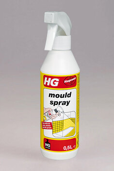

"HG - Mould Spray, will effectively remove black or brown mould/fungus/algae spots from Silicon joints and plaster. Will also remove coffee/tea stains from plastic worktops.
Suitable for use in the shower, bathroom and kitchen.
Suitable for use in shower, bathroom and kitchen
Removes black/brown mould, fungus or algae stains
Removes coffee/tea stains from plastic worktops"
THATS THE ONE I USE nICK,GOOD STUFF BUT OPEN THE WINDOWS AS ITS VERY POTENT.
Nasty stuff : As you know this is only a temporary measure as the black mould will keep coming back until the root of the problem is addressed.
