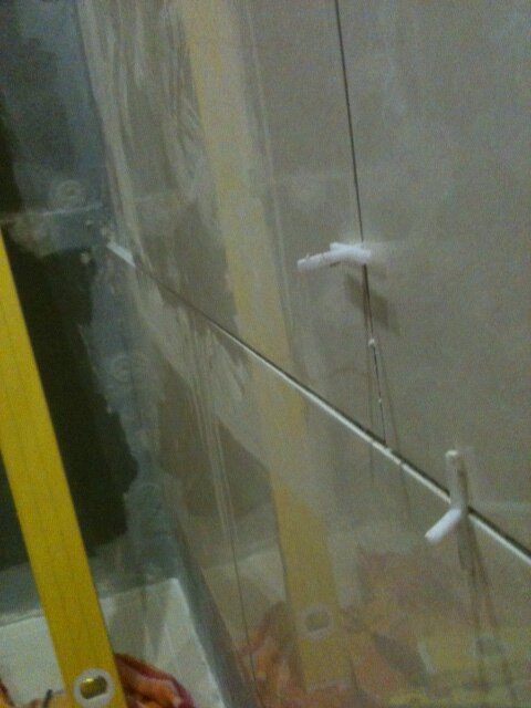

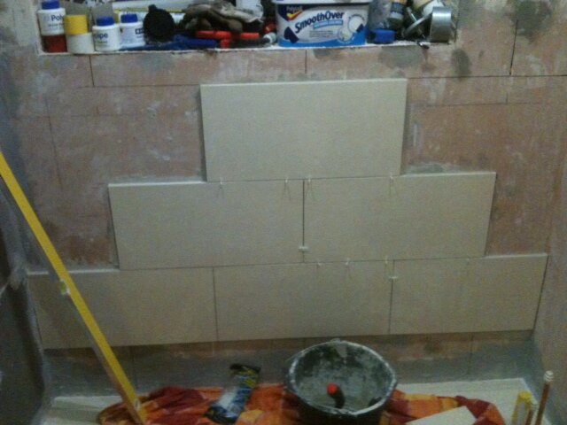

However, I've started on the walls. I'm using 600 x 300 tiles. The walls are not very straight, but I can compensate for this by using varying depths of tile adhesive. I'm well practiced at this after doing the floor. It's slow progress but worth spending the time on. BUT, after setting the first row of tiles, when matching the 2nd row of tiles up correctly horizontally and vertically, they edges bow in/the middle bows out!:mad2::icon13::censored:
Have I just bought cheap cr@ppy tiles that bow? Or is this a common problem? Any ideas of how to best overcome/compensate for it? The one's I've set so far I've had to compromise the gaps at the edges and the middle.

I worked out the best cuts to not leave slithers around the window, and the least cuts in total. This meant that they were not centred to the centre of the window. But I guess all that can go out of the window (no pun intended :smilewinkgrin:) if I were to stack the tiles. So, now I've just got to convince the Missus!

The only way to disguise the bows in the tiles is by stacking and I would say that this is a more modern look.

This is how bowed the tiles are:
So I'm going to stack them - thanks for the advice chaps, and yes I agree it looks more modern that way.:icon14:
But, I'm not sure about centering them to the window. :confused_smile: When stacked, do you centre the middle of the tile to the middle of the window or the edge of the tile to the middle of the window. And does it matter if that then leaves a small 60mm tile on the RHS?
I've used a notch trowel bed and then packed it out with extra adhesive where necessary to keep them vertically straight. Is that the best way to do it?
I've not a clue about the weight of them so I'll check later. But yes, I'm going all the way to the ceiling. Worst case what might happen? Anything I can do to prevent that happening?

if there to heavy, worst case they will fall off, damage the bathroom suite, or give you a headache, so before you continue i would check the weight of the tiles, are they porcelain tiles or ceramic? it should say the weight on the box and if they are packed in 1m2 per boxs, if not weigh one tile and times it by 5.5 the number of 600x300 tiles in a square metre..
