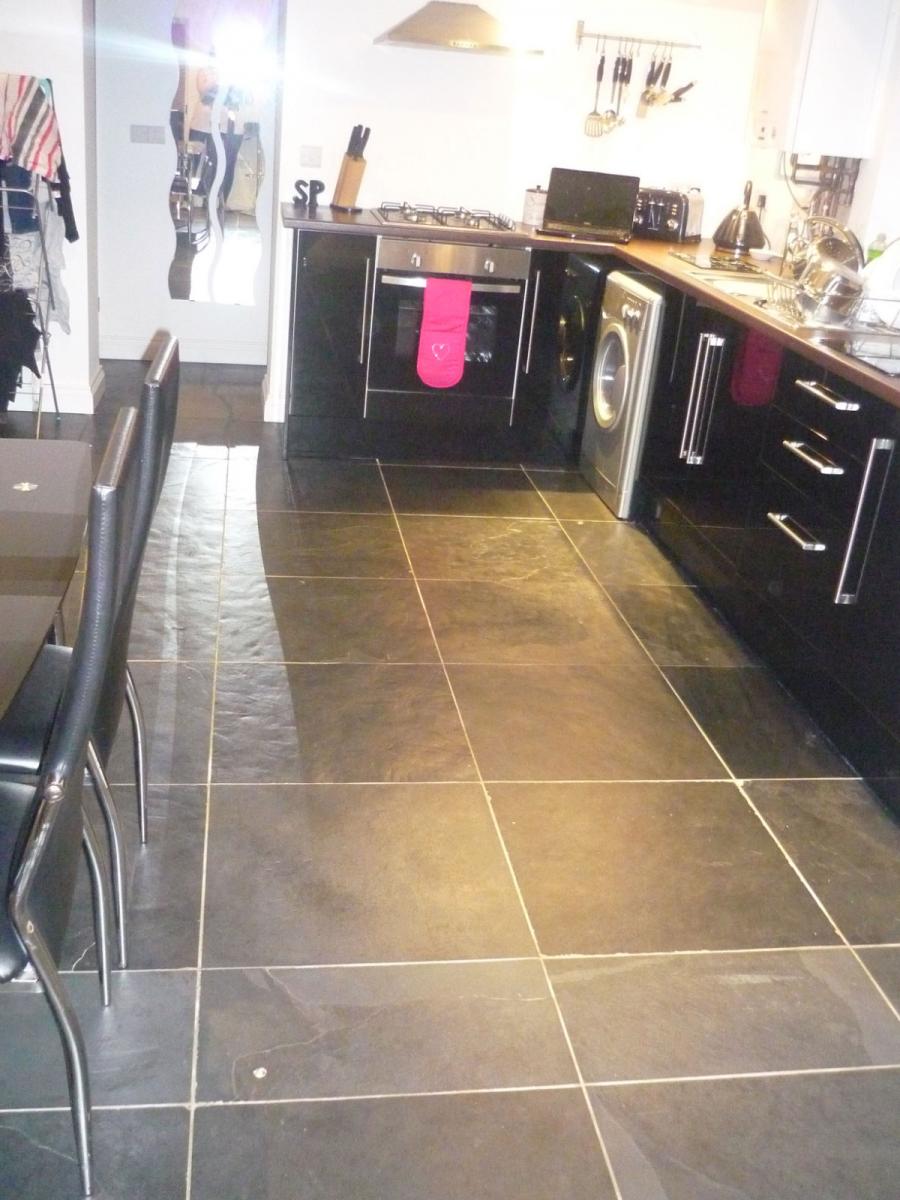

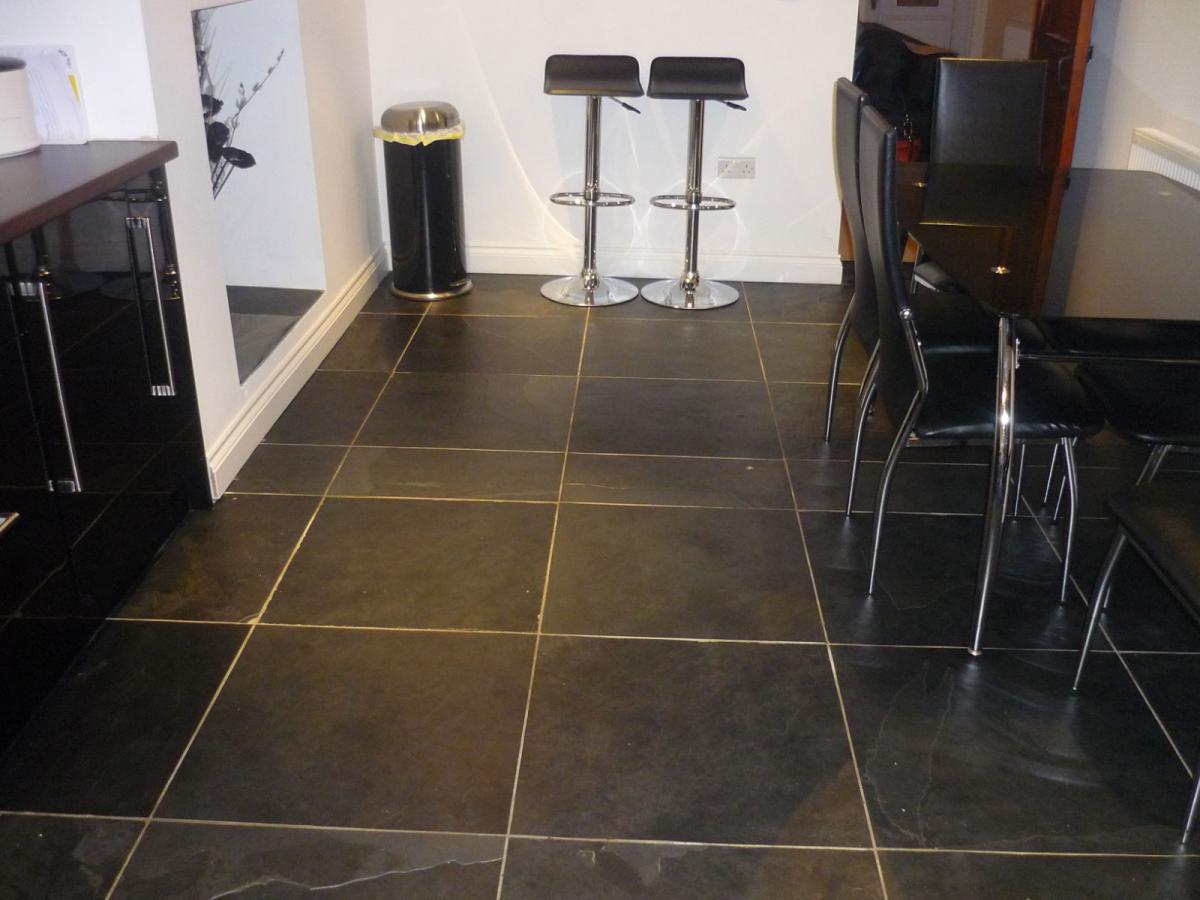

love your floor. Is that white grouting? we were going to go for a grey grout but not sure now.
hi mate,not white,it was mapei,gray i think,it is quite light though,some bleach i think by the daughter mopping up aint helped :)

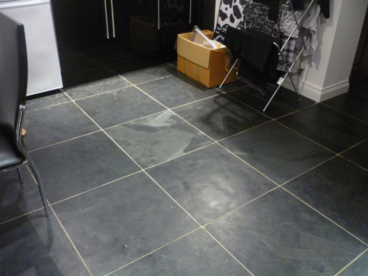

also i laid the left over tiles today from that floor last year in a little gite,and they defo differ in thickness,more than a few mill.
also,when you lay,you will get lipping if the tiles are riven,sometimes with these tiles it can't be helped,but if it looks to much in places,you can spelch it off a bit with a small thin chisel,after its set solid of course. hope all goe's well with it
