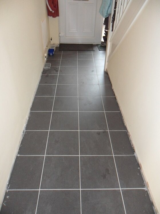

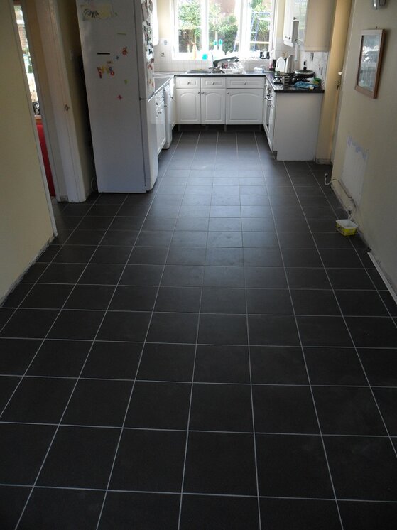

Looking at the pictures below, does anyone see any issues, faults, problems with the floor tiling.
I don't think image 5 has taken too kindly to being resized, and please ignore the dust. But other than that, anything jump out at you?

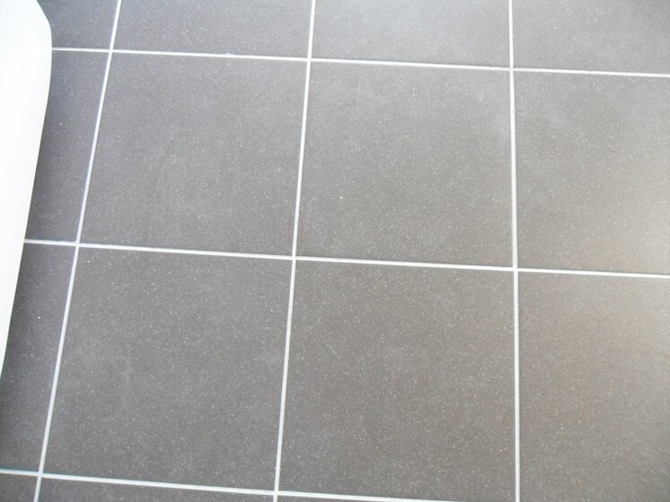

pic 3 front of unit is not a full tile
The last joint infront of the units is where the kickboards were. The small slither have been added in afterwards. Kitchen is being replaced next year and the plinth was in such a bad state that trimming them down after tiling under the feet of the units would of destroyed the plinth.
Grout was there choice, tile i picked, left a sample with them for 3 weeks before the job so they could mull it over. 3mm grout joint, concrete sub and durabase throughout.
The slithers under where the plint will go were put in on request of the customer by a subby i employeed whilst i was on my holidays. I had orginally explained the state of the plinths and it was agreed as they were replacing the kitchen at the start of next year that tiling upto the plinth was acceptable. As long as i over ordered enough tiles to go completely under units to the walls when "i" do the kitchen install next year.
They were very happy with the tile. In particular the matt finish.
Let me also explain what the pictures are:
1) Is looking from the dining area down through to the kitchen.
2) The dining area floor
3) Kitchen area
4) Close up of kitchen area floor
5) End of hallway, at door entering kitchen/diner
6) Same position as 5 but looking down hall to front door
7) Front door looking down the hallway.
Anyone spotting any issues with setting out?

Welll I assume that because there is more than one photo we can say it is shown in pic 4 closest ?

My customer has just delayed by half an hour so i try and quickly explain now.
They had a wall between the kitchen and dining area. That has been removed and they wanted the kitchen, diner, hall and cloakroom tiled.
When setting everything out it became apparent that the staircase was "at an angle" Making the kitchen/diner all square etc was fine, but to lead this into the hallway in a continuous fashion would of ment having tiles down one side of the hallway differing by 1" 10/16ths down the length.
This was explained before the first tile was set in. 3 times in fact. To the husband, to the wife, and a third time when they were both avaiable.
The reason the hall is not centreed is also to avoide any slithers. Which is how it was previously tiled. So i explained a few different options. And what with the tile being full bodied porcelain it was decided that the best thing to do was to set the hallway and cloakroom out independently to that of the kitchen/diner. But cut the tiles to have a grout joint in the doorway between the two.
Now it was explained that this would leave what is shown in the picture i'm going to attach to this post. But it was also explained that once the door is fitted and the door to the cloakroom this would be barely noticeable. This WAS accepted.

when im tiling jobs like this , i always try and start full tiles in the middle of the doorways and square off hallway as this tends to be the main focal piont, however this is not allways possible due to slithers,walls running out miles ect, i then do as you did and run through opptions with the client, lay tiles out, show them the different ways the job can be done, and suggest the way i would do it if it were my tiling, but make sure they are fully happy with the lay out before i start..

Image 1? No i think it's where the light is coming through the window. 3rd picture is a closer picture of this area.
