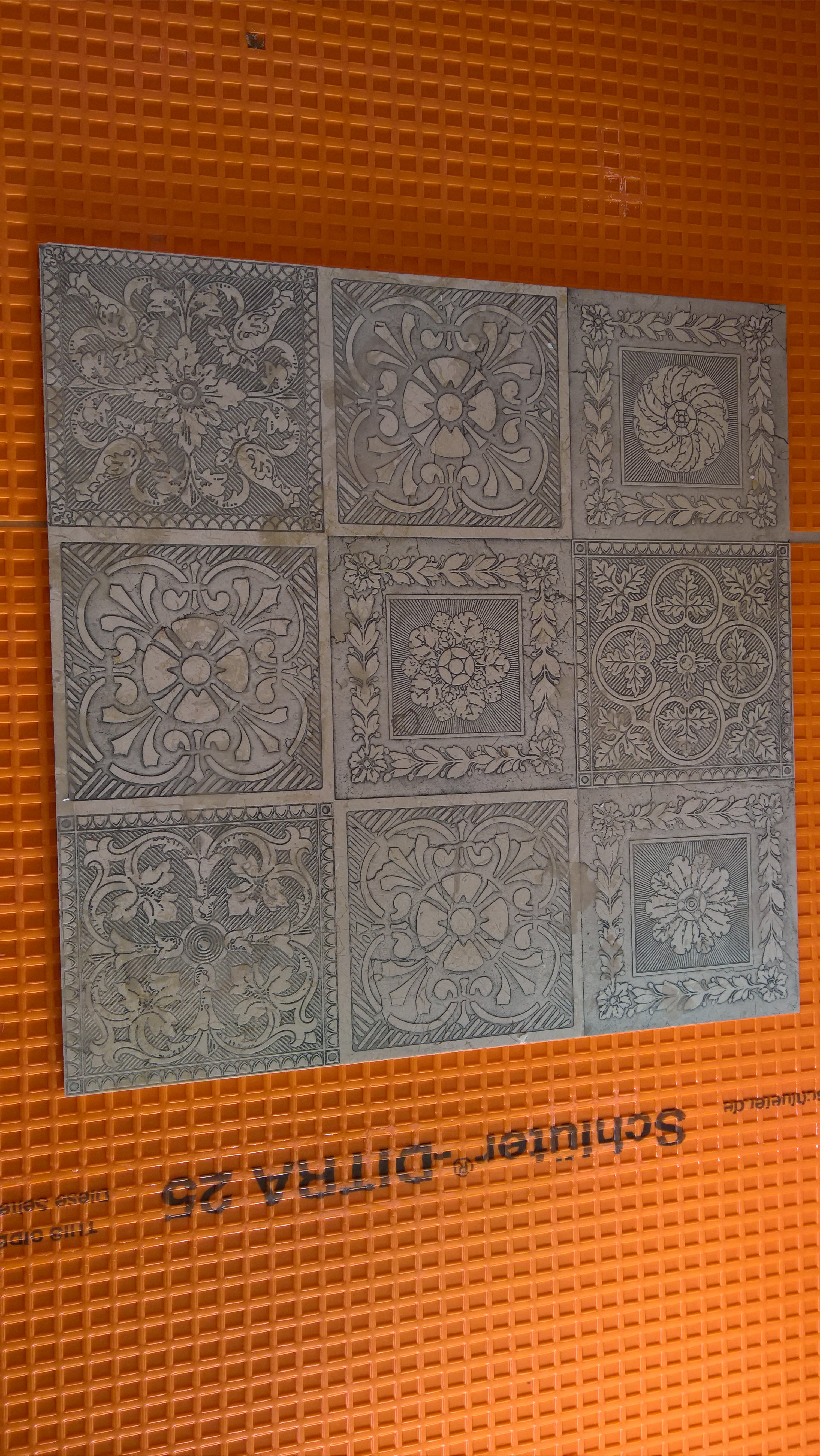

Present job the customer has chosen Caspari Antiqued Silver Caspari™ Antiqued Silver Tile | Topps Tiles - http://www.toppstiles.co.uk/tprod46565/caspari-antiqued-silver-tile.html
nice looking tile, better then the website photo.
my question, how would you fix them?

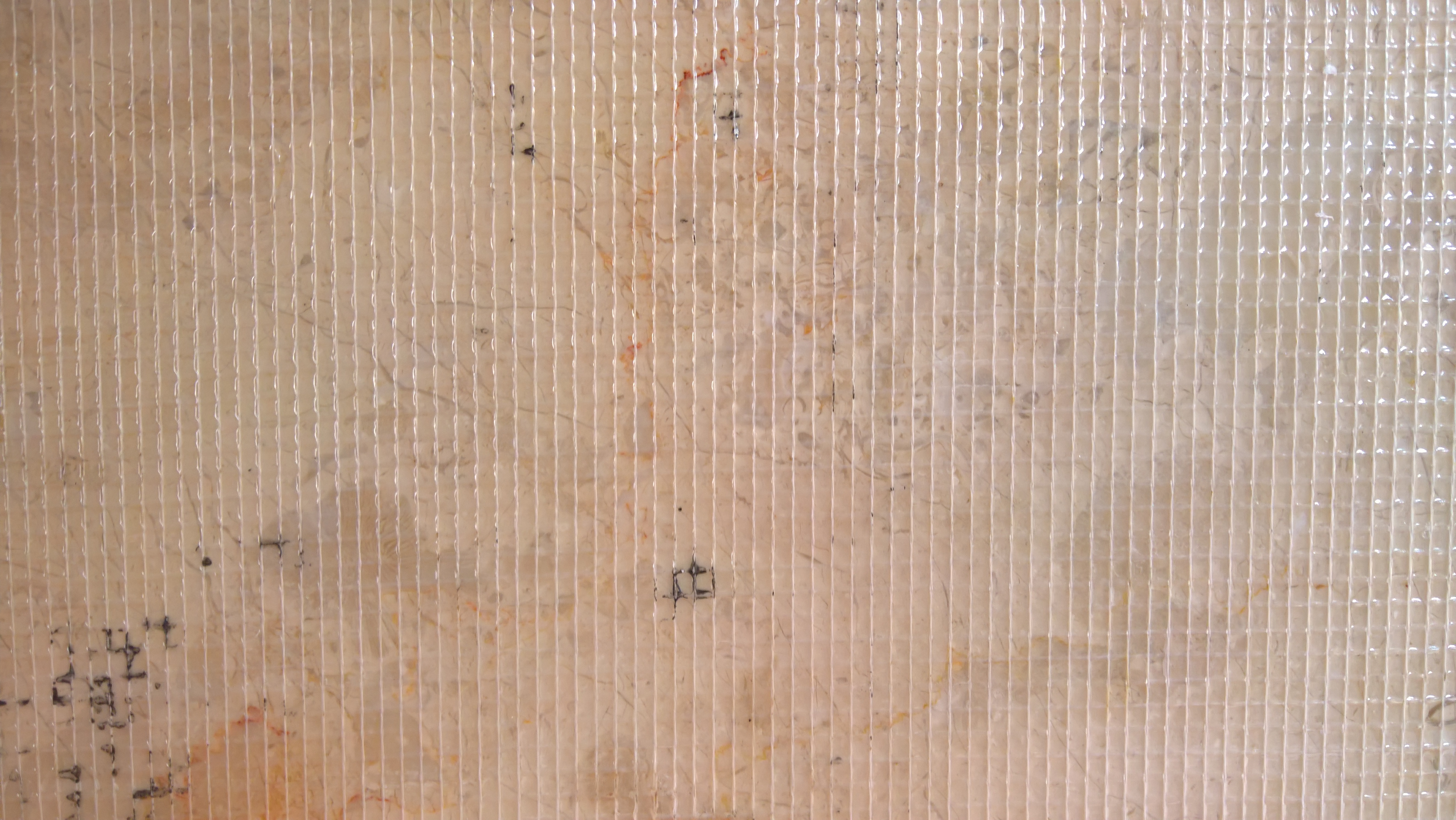

What it doesn't say on the website is there resin and mesh backed
I plan to use a bottle and bag mix to back butter the stone and normal mix on the floor and walls.
Would anyone think I should abrade the resin ?

So will have a go at removing the resin and mess tomorrow but will use an admix as well anyway.

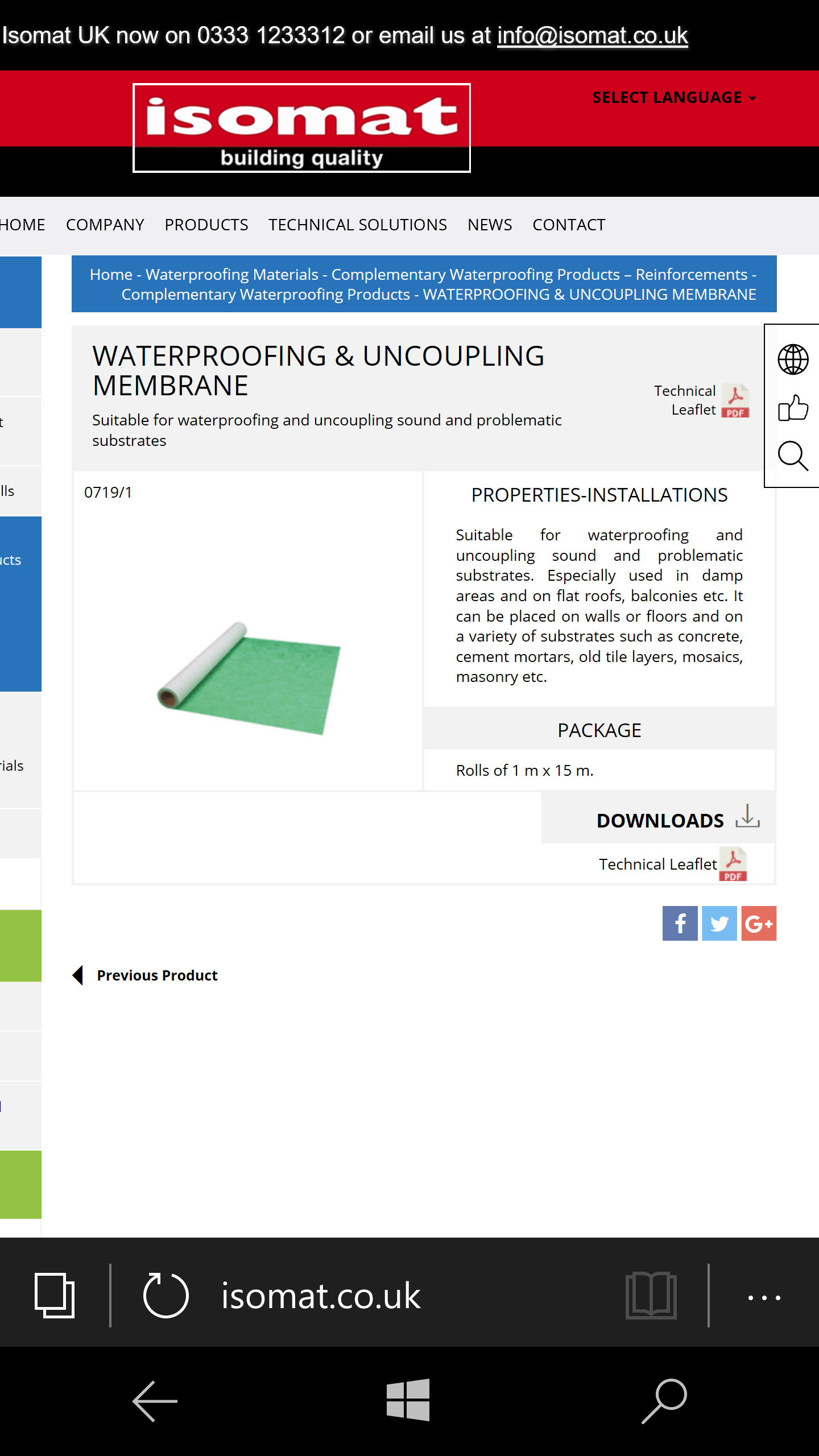

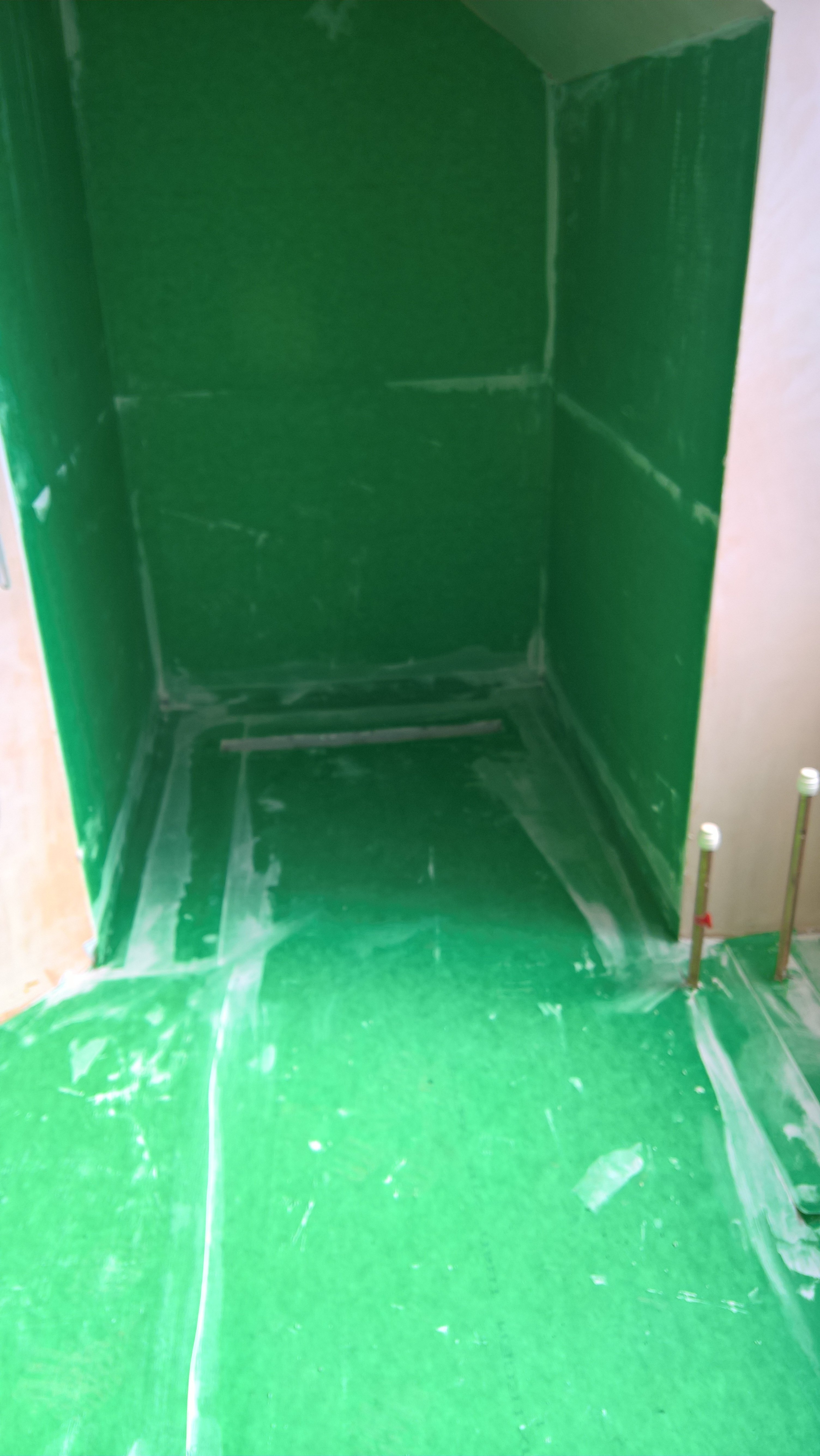

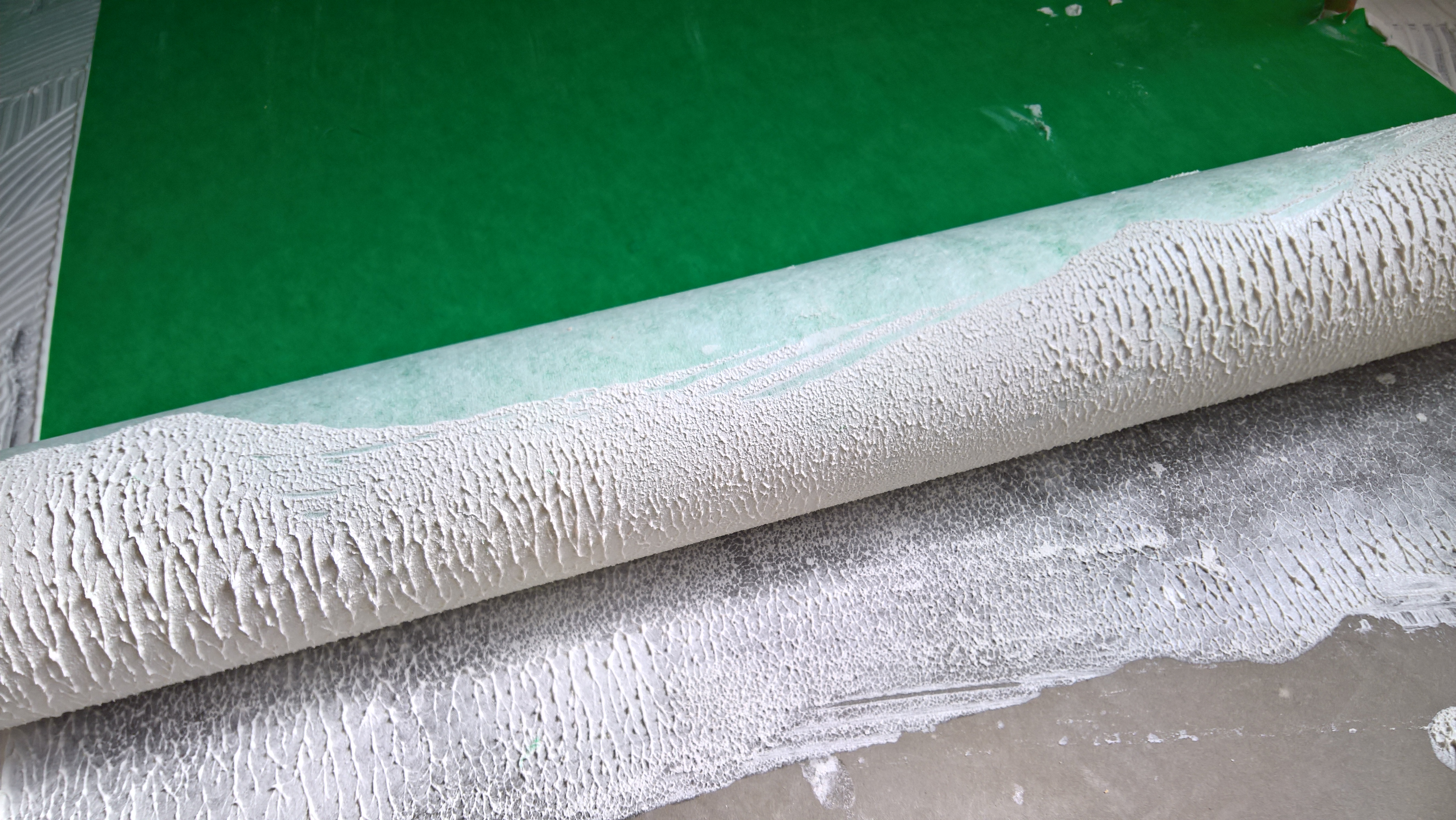

Used the Isomat waterproofing and uncoupling membrane today to prep shower walls and floor in the room where these tiles are going and used the Isomat AK22 adhesive for the first time, and have to say both were a dream to use. Highly recommend them.

Just looked on web .you need to find out what type of resin is on back there is 3 types all need different types of adhesive Good luck.
Didn't tell me .but you did you were going to remove mesh that was put on for a reason. The tiles are weak they need the mesh .you need to find out what stuck the mesh then find right adhesive
