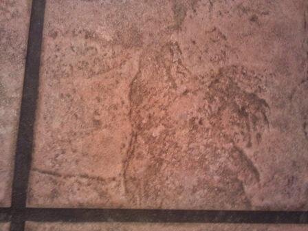

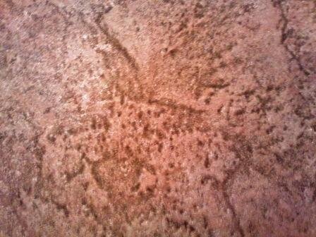

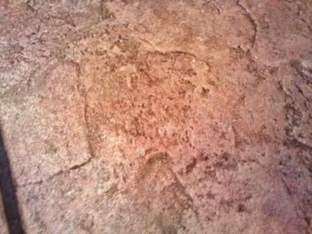

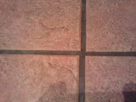

Thanks guys - photos attached of my problem .... its pretty bad eh :thumbsdown:

iggy
guys - i'm in blighty in cheshire - but like I said a virgin DIY'er - so sorry if I mislead you with terracota trail .....:oops:.... i was so adamant as my missus told me they were???
Do I still go with Enduro's advice?
Or it best to use another product for ceramic/porcelain variety?
thanks again for your continued help ....
Iggy
E
enduro
Iggy
Yes you can, except you don't need to seal them if they are ceramic.
