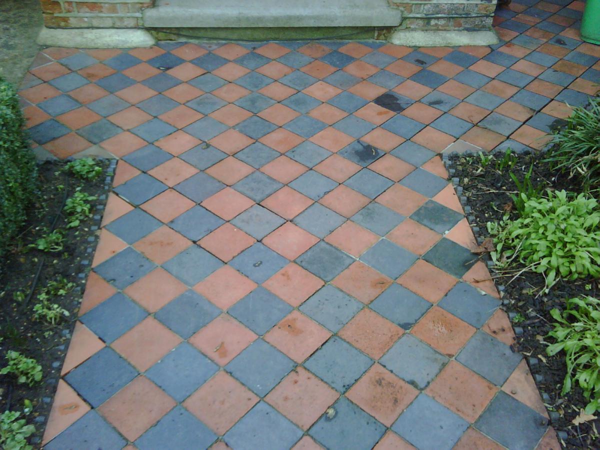

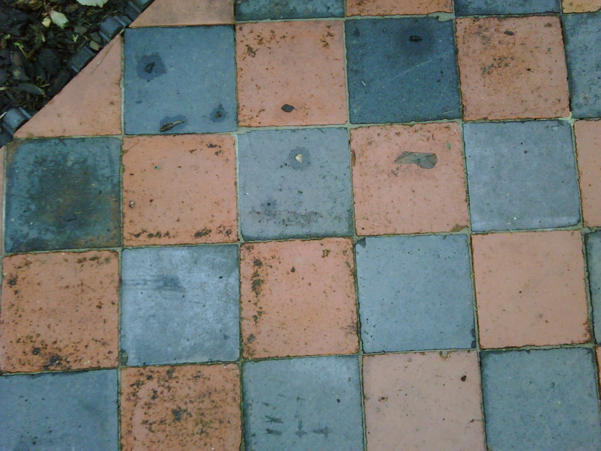

Can anyone please advise the best cleaning process / solution for an old victorian (?) outside tile path. See pictures attached. i have power washed it to start, but the path has not had a proper clean for some time.
is there a good solution to get the deep grime out? once done how best to seal the tiles and give them a shine?
many thanks

Aqua Mix Heavy Duty Tile & Grout Cleaner and Aqua Mix Nanoscrub will sort that for you. Available off tradetier.com or off E Bay. Wet a small area of the path preferably a bad bit then apply the HDT & Grout cleaner and allow it to dwell (Sit) for 15 minutes make sure you keep it wet then add a little nanoscrub and work that in. (All this is helped if you have or you can rent a low speed Rotary Scrubber fitted with a medium scrubbing brush and a good wet Vac) Then once you have allowed it to dwell rinse it off and vac dry. Then I bet your next thing will be to say they look fantastic wet but a bit jaded and dull when they are dry! If this is the case you can seal the whole lot with Aqua Mix Enrich and Seal Penetrating Sealer and your good for 15 years.
Terry, dwelling a sodium hydroxide based cleaner is doing nothing more than bleaching the tile, giving the appearance of cleaning and causing damage. Surely you wouldn't advise using an acid on a calcium based stone? Sodium hydroxide and clay is the same thing.
I know this is what they teach on the Aqua Mix tupperware course, but it's only to compensate for their products lacking any decent ingredients and relying too much on old tech and builders.
Sorry but in the 'real' restoration arena these dwelling practices and their results would get you sued more often than not. A large majority of our work is repairing these 'following the label' blunders.
