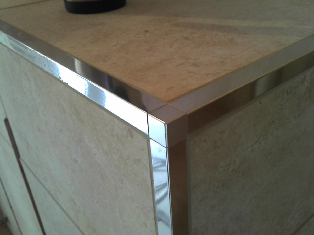

do any of the trim manufacturers make a corner piece for 90 degree trim? it has to be 3 way. the reason i could do with it is for a tiled bath panel and i want to avoid the sharp corner if possible. i've never found the need for them before. cheers :thumbsup:
Something like this Mike in metal, I know its not rounded but it looks the biz

These are a solid cube that slot into the trim, no mitre-ing just straight cuts, you might be able to file a rounded corner and then wet and dry and polish up
