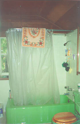

I'm quite proud of my bathroom. I would decribe it as retro-kitsch.
Grace'sDad
Sorry Wagglerman! Didn't mean to hijack your thread by being stupid with the green bathroom! :lol:
