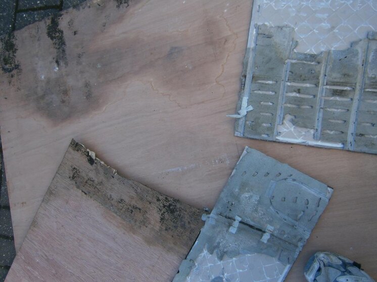

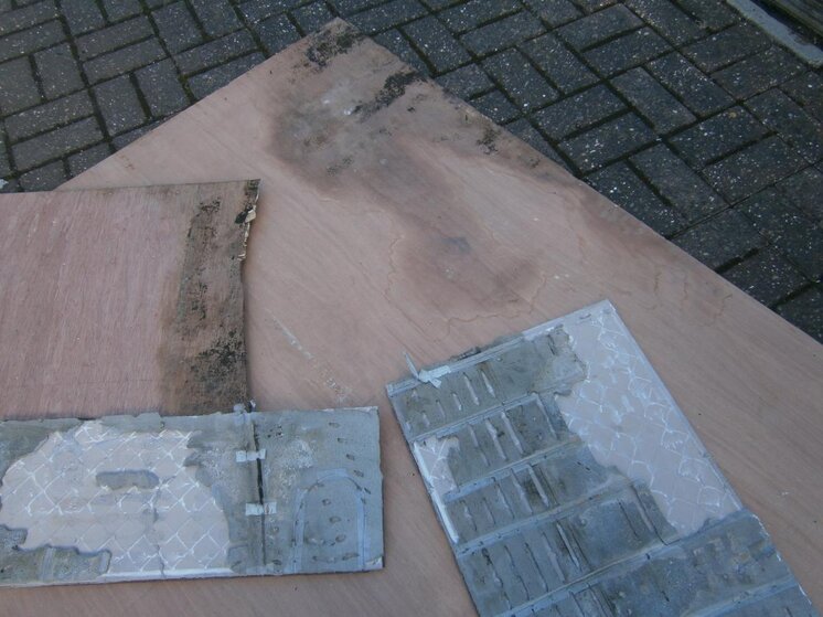

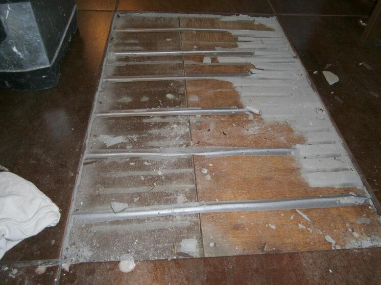

right ive been and had a tile up today, 2 thirds of the floor has cracking grout,one third is fine
lifted a tile ,which didnt want to come easy[topps rapidset flexi]
i think its movement in the floor ,which i didnt think was as bad when i jumped up and down next to a glass water,when quoting
the addy seems to have come away near ply joints,awway from joints its stuck good on tile and ply,not just one or the other, warmup loose wire ,with their own green primer
im taking the whole floor up next week,and am probably gonna have to fork out over £700
i was hoping for thermal shock signs ,not that anyones going to admit to bad commisioning anyway
DAVE , u asked if it was onto joists , be interesed to hear yours or anyones views mate
im gonna takit on the chin ,[18 months into my career at the time] and put it down to expierence i reckon
DHTiling
This is why i do not like tiling direct to ply... too much cheap ply in the uk market and it can leach resin and this results in tiles de-bonding... you can see on pic 2 where the ply grain is embedded into the adhesive but de-bonded.. this is typical of cheap ply and UFH...
IMO you need to use a cement board to get a better bond... cover the UFH in SLC suitable for timber floors and then solid bed fix onto that.. making sure you back skim those tiles as well to create solid bed..
