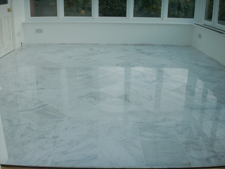

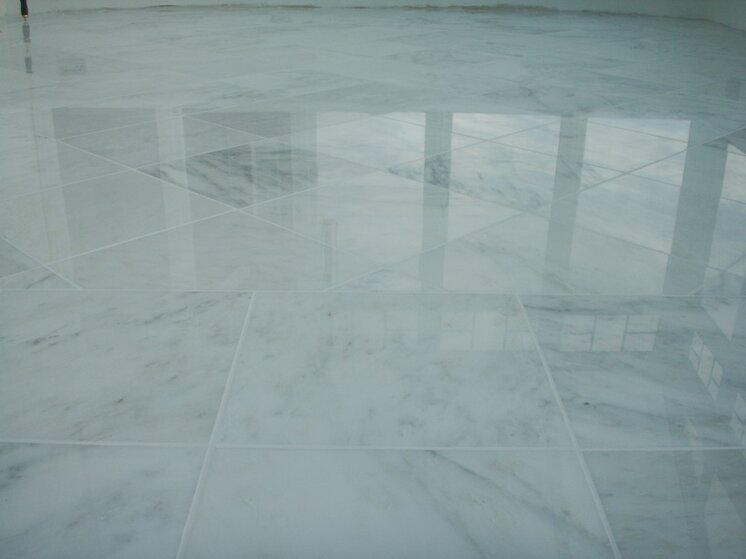

This one had to be centralised to the room.
I dry laid the centre first to get best cuts. Then I laid outer area and border. Then laid center :thumbsup:
Still cocked up slightly and had small cuts on the corners :yikes::smilewinkgrin:

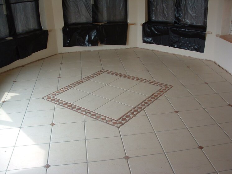

JB
I always set the centre design first and fit a border/perimeter to it!
You have to have a full/half tile up against the border and it should be symetrical around all edges.
However if the centre feature is only a panel as per other examples then I would allow the border to be the main feature and cut the tiles at the diamond to fit!
:thumbsup: Nice one John................I think I would get spaced out on that design mind:smilewinkgrin:
