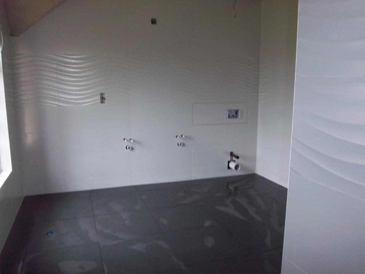

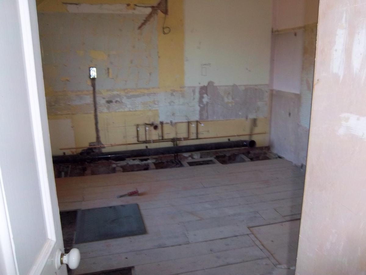

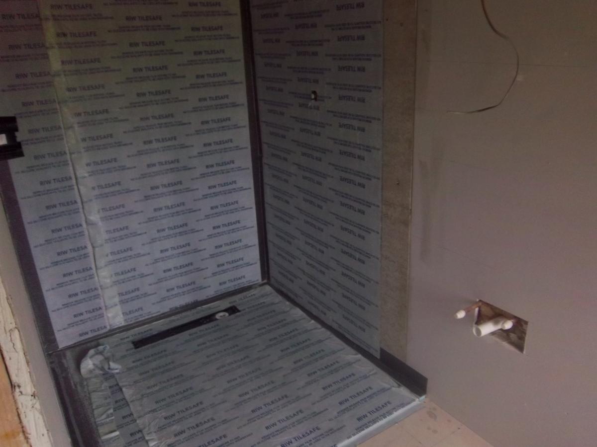

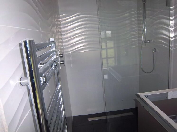

Used Dukka board a lot in commercial shower areas because its so quick to install, 100mm boards to use on the floor create instant falls to full length drains. 20mm on the walls as CJ says using the screws and washers that come with the boards.
Is that tile safe membrane on the walls? When I did my impey training we were taught to do it that way. Then the company sent out a letters asking us not to.
diamondtiling
How else could you do it? It is a great product (expensive) but it did the job. When I fitted it I had reservations because after 3 hours I could still peel it back, the next day though it was stuck and was not coming off at all.
What were the reasons not to fit it this way?
