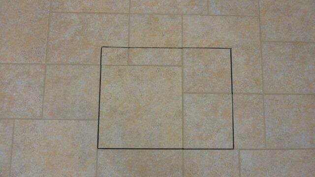

It sounds like you might have to make your own with backerboard. The attached pictures are of a manhole cover, but my customer did not want it to look like a manhole cover. Access is gained by knocking in the two bits of tile that I have covering the key holes. They are just held in place by 2 springs made with cardboard! I went around the outer edge with ivory Silicon. You would never know that the manhole cover was there. All you would have to do is tile around your existing covers and make a removable cover with backerboard and tiles. Good luck. Sean
