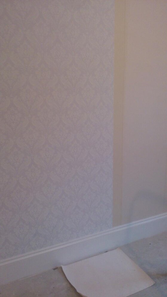

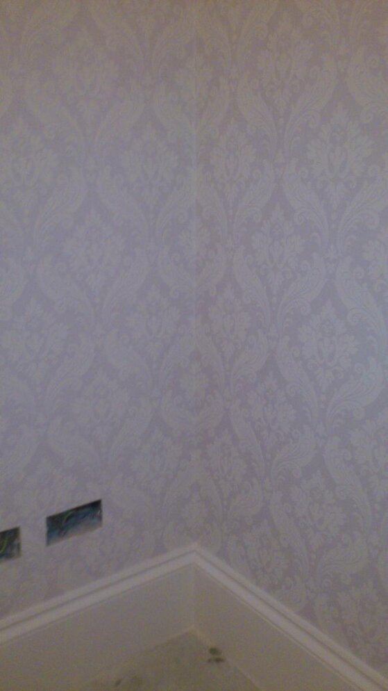

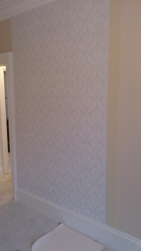

Hi all, could't find thread, we were talking about easiest trades :incazzato:. Anyway here i did some work today (not tiling) :8:.
Prepare walls, prime with wall paper adhesive and let it dry.
Hang lining paper and let it dry
prime walls (on top of lining paper) and let it dry
mastic all internal corners
hang wall paper
:thumbsup:
DSC_0839.jpg DSC_0840.jpg DSC_0841.jpg DSC_0842.jpg DSC_0843.jpg DSC_0845.jpg
on last picture, internall corner was soooo bad (about 35mmm out). And hmmmm ..... no mitred corners :prrr:

i used "solvite" wallpaper adhesive (allways used it i know it's good and don't want to try any other). If you didn't prime walls before lining, when hanging lining paper, walls would suck adhesive inn quicker then it would sink in to paper. ( so most likely you would find liningpaper on the floor the next day) . I know some decorators don't do liningpaper before wallpaper, but to me it's wrong. :thumbsup: And i love doin wall paper, as you need skill for that. I have five bedrooms to do in this house. And i tiled all bathrooms there too ( posted some pictures some time ago)
Colour Republic
So you sized the walls with watered down wallpaper paste instead of primed them. If you had of primed them with a dedicated wallpaper primer then you could of achieved the reduced draw of the wall but you also would have made it easier and cheaper for the wallpaper to be removed at a later date as the primer would have protected the wall and you'd have a much better chance of being able to remove the wallpaper paste completely so it could be painted again in the future without the need for extensive prep.
Your choice of wallpaper paste was because you'd used it before without problem (was is powdered solvite or ready mixed? if ready mixed yellow or red lid?) and I assume wasn't to do with consideration of the type of paper you were hanging, so the stength of the paste, its water content, it's PH value or the fact it could have been cellulose/pva/wheat... based and how any of the factors could have reacted with the type of paper or the method it was printed by.
Still not sure your reasons for lining, was it because it was a woven paper rather than a non woven? Did you use it to sort out lumps and bumps in the wall or did you line the walls to combat seam shrink? Or maybe you used it to give the wall a uniform colour to stop strong colours showing through the wallpaper? Could it be you used a liner because you wanted it to draw away the paste moisture away from the finish paper so the delicate print didn't stain? or you used it to reduce surface tension on the substrate you were papering so the wallpaper stays in place far longer and doesn't curl at the seams??? It could have been for any one of those reason, a few or all...
Colour Republic | Why use lining paper | Wallpaper
Without knowing the type of paper it was printed on, the method of printing and the type of ink used to print it's hard to say if you've done a good job or not. It certainly looks good enough even though in your last picture the right hand wallpaper is 10-15mm higher than the left wall ;)

it was powder solvite. And there is many reasons for lining paper. And my wall paper is not higher :lol:, i used laser level to start and on the corner. I took that last picture from closer, so you guys would see that walls are out one wall by 15mm, other by 35mm). House is very old (used to be pub) so ceilings and walls are all over the place.
