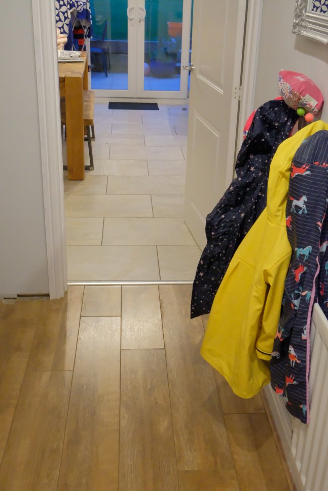

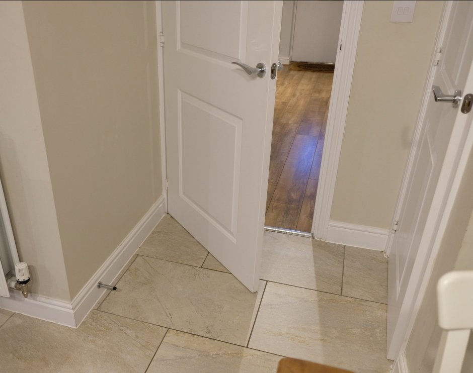

Just looking for some thoughts regarding extending an existing tiled are if possible please? We are in need of new flooring in our hallway and under stairs which has recently been knocked through to make use of the space, and ideally we would like to extend our existing kitchen tiles through into this space for continuity - we currently have laminate in the hall, carpet in lounge, and two different tile types in the kitchen and toilet, so it feels a bit disjointed!
However, whilst we can source the same tiles I'm just concerned about how the existing laid pattern may look extending into the hall, given there is a slither cut of around 2.5cm from the skirting on one side. If the walls aren't perfectly parallel, this would perhaps exacerbate things further. Wondered if a border of sorts might be the way forward? The existing tiles are 435x659mm, but are also available as 316x592.... not sure if a drop in tile size might work in the narrower area or just look weird where it transitions!? Have been scratching my head for a few weeks - any thoughts/tricks/workaround ideas would be greatly appreciated!

Hi. It’s always a choice between the lesser of two evils type thing. If I am understanding it correctly I would use the same tile and just have the sliver cut. Changing the tile type will change the area giving it a divided feeling. The only reason to divide the area is if your hallway tiles were purposefully intended to be a feature. Victorian tiles, encaustic cement patterned tiles or similar.
Thank you, much appreciated. Just obsessing over the sliver cuts running up the length of the hall, but guess there is little option but to accept this or go with something else entirely.
WHat did you decide to go for?
Couldn't guarantee the sliver cut wouldn't get thinner still working up the hall, and couldn't face shifting the pattern... So, after much deliberation, we've gone full circle and going for a different tile and pattern altogether!
