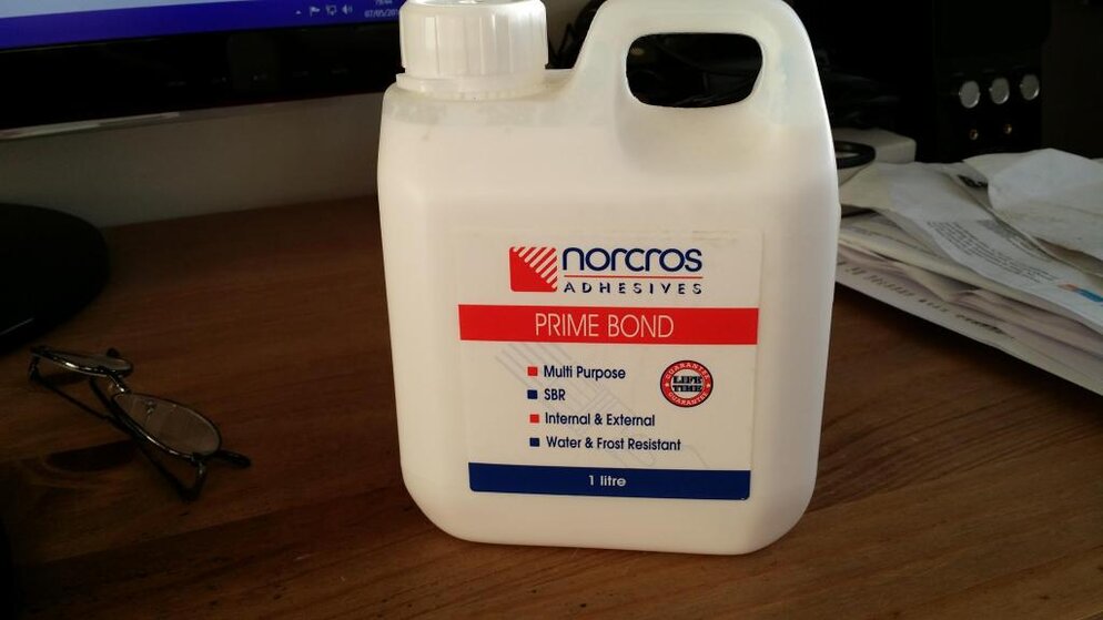

Hi all thanks for the replies,
Today I bought a 1Ltr of Norcros prime bond from a tile shop, it is water based and he said you can use it neat or diluted,
1. multipurpose
2. SBR
3.Internal & external
4. water & frost resistant
have I bought the wrong stuff ? (he said it was correct for over bitumen residue) 20140507_194447_zps3b3f913b.jpg
1. multipurpose
2. SBR
Your'll be fine with that....
