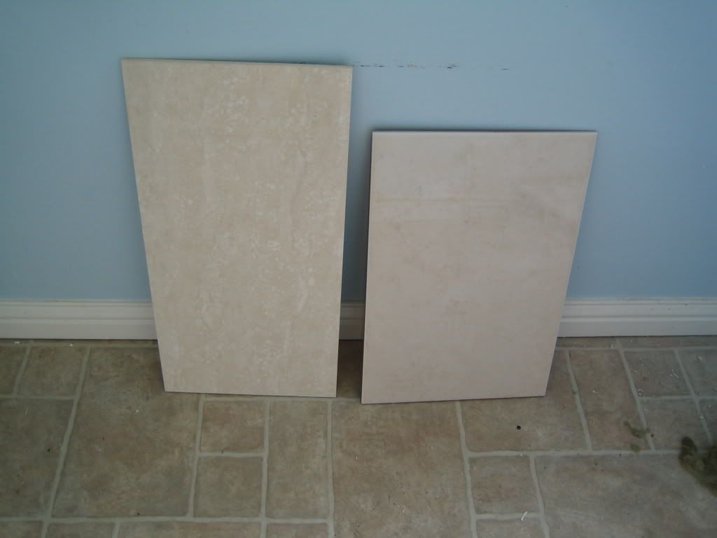

Hi Big Al and :welcome: what size are the ceramics?:thumbsup:
Errrm, not sure, pretty big though (left) -
Scott
Big Al im afraid they look like they will be too heavy for skimmed plaster or skimmed boards. You will have to overboard with new plasterboard or preferably cement backer boards for them to be strong enough to take the weight of the tiles. They look pretty big. If you can measure them then we can give better advice on teh weight issues
BigAl
They're 30x60.
The are will all be new plasterboard apart from that wall. Can't I prime the plaster?
