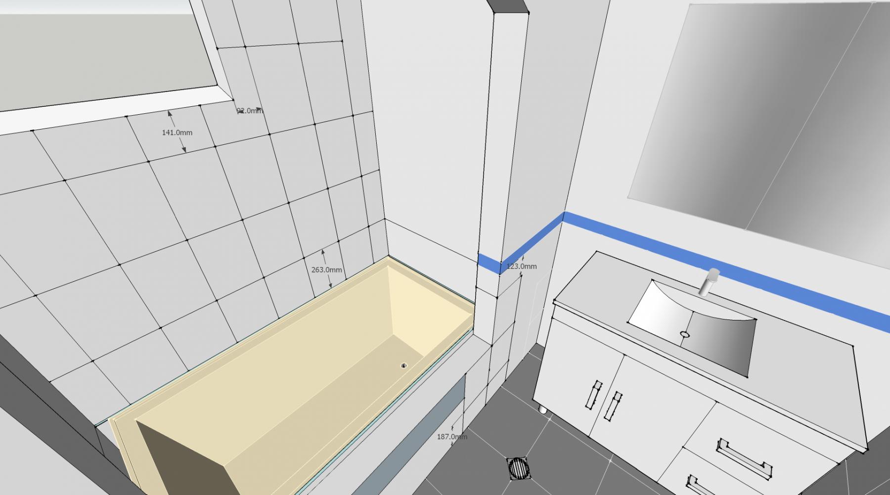

Hi, thanks very much for the suggestions. This gives me some good ideas. Colour Repuplic....here's a sketchup model of the situation. There's a blue/green edge around the bath of about 10mm representing the gap. I can't help but wonder if it's easier/cheaper to just fill that gap with silicon? Or could that result in undesirable consequences?
