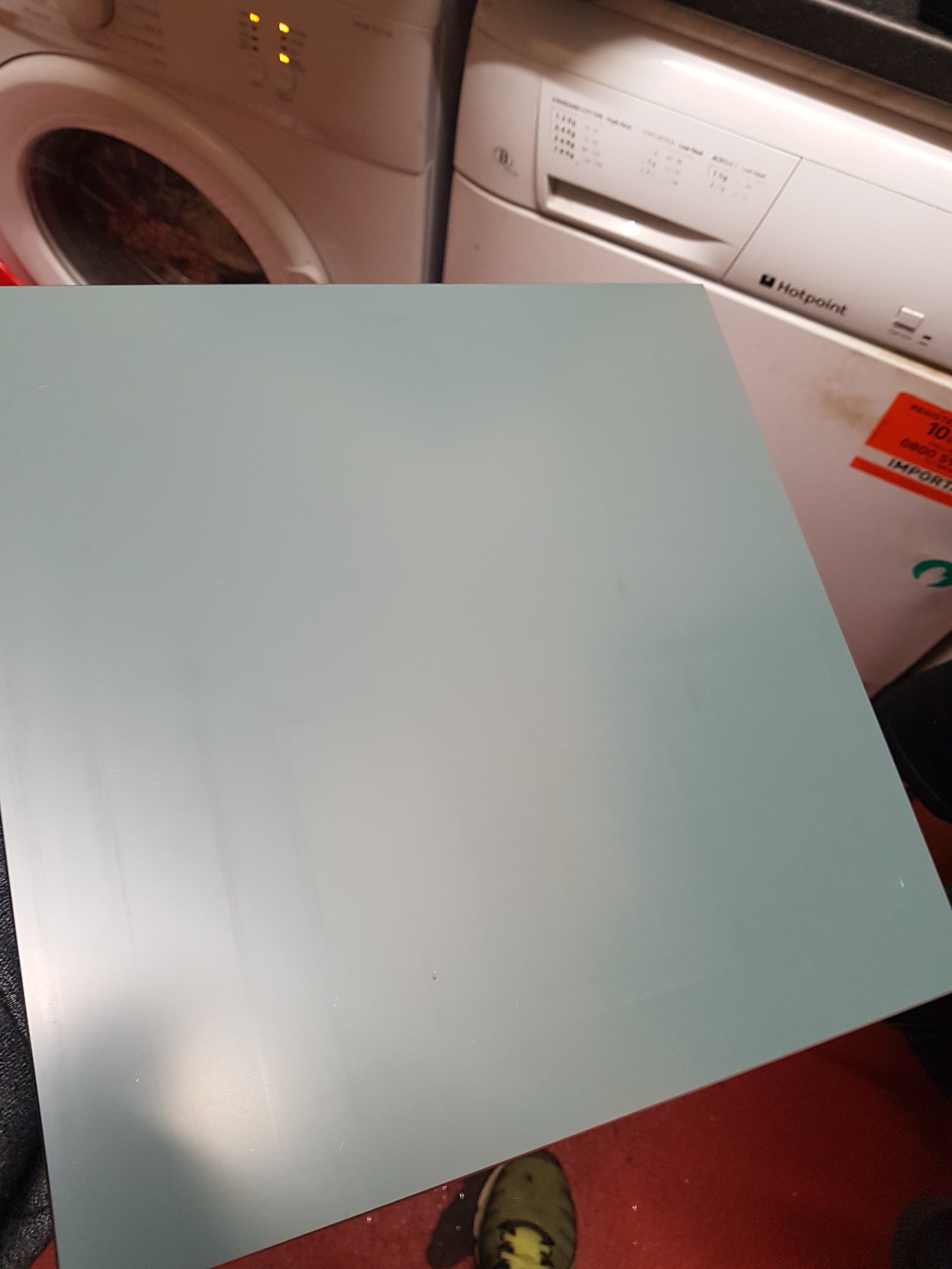

Hi
Looked at a job where the customer wants mirrored tiles within the field of other tiles, 300x300 size.
About 2mm thick.
Any adhesive options would be great, the background will be strapped, plasterboard walls.
Cheers
