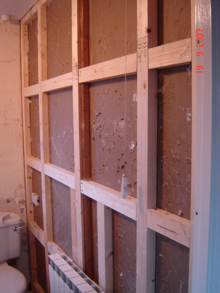

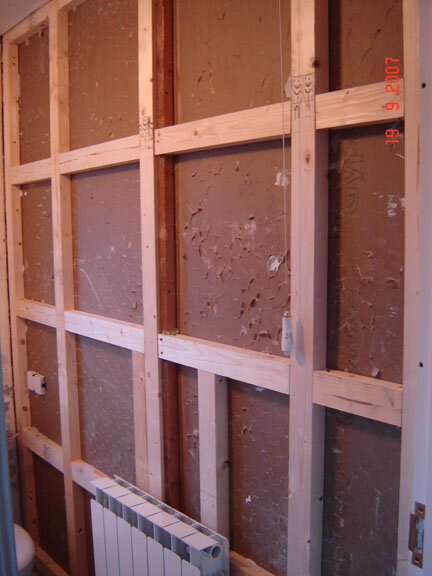

Removed the plaster board skin from the indide of the bathroom leaving the bedroom wall intact (Girlie said she didnt want to see me sat on the loo first thing in the morning) (charming)
Anyway just need to get some 3 x 2 in the morning as im off for a couple of days and need to reinforce the wall now.
A question please .... do i need to plasterboard the wall prior to putting the backerboard on or can i fasten the board straight to the studding.?
Also If i put extra noggins between the joist do i need to dpwn (after removing the floor boards 25mm ply or will i get away with 18mm as i dont really want t step into the bathroom.
Couple of pics if any one interseted.

Good thats made it a little easier for me.Thanks
Do i have to bond the backerboard down or screw it direct to the floor.
Another question where is the best place to get the backerboard from.
Gaz
You can just screw directly to your floorboards after securing...and the best place for backer board is...well...I will give you 3 guesses lol:wink_smile:
