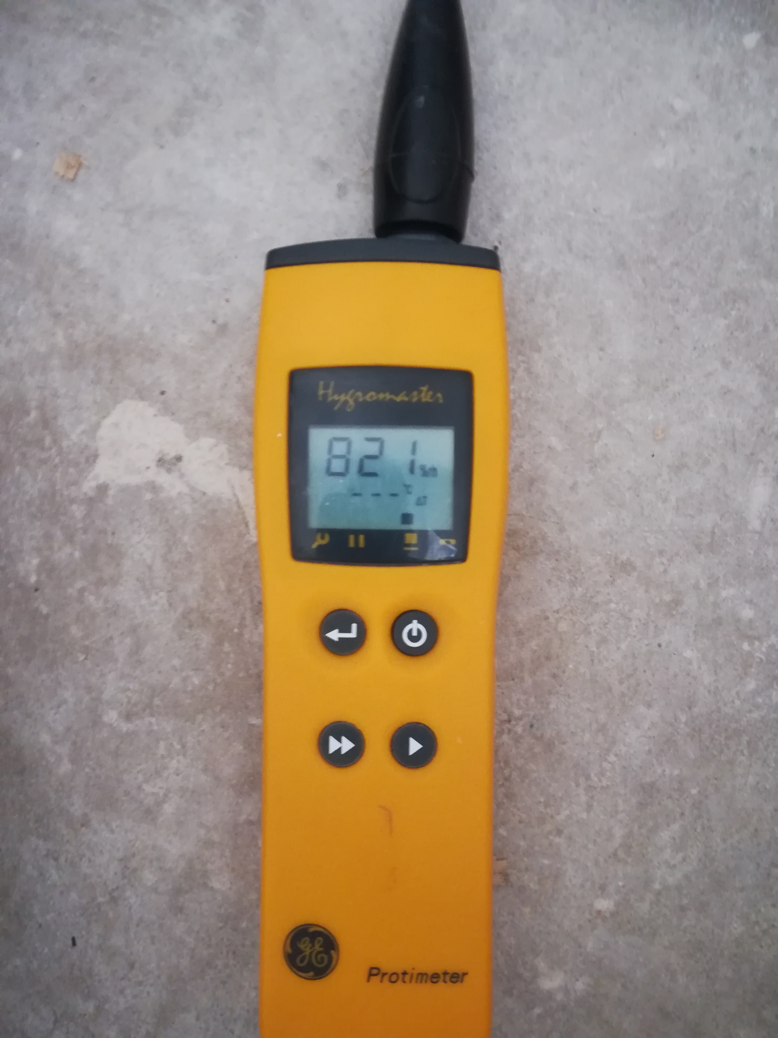

I've seen two around my way, tiled one, the other wouldn't let me test it so walked.
I have test equipment but really can't see it taking of at all.
