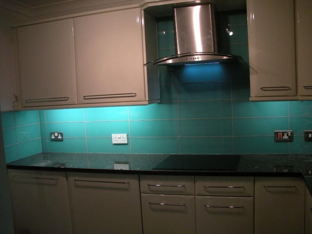

Sean fsy
What happened with that rogue white plug socket !
All the others are brushed chrome...
(Sorry if thats off topic) Just being nosey !
have a look at the one in the corner,(at a different level to the rest of them) it was an after thought extra so didnt have enough new fronts to put on i think. said before i tiled it was at a different height but they said it would be ok, then guess what, when i was done they said it stuck out like a sore thumb.
