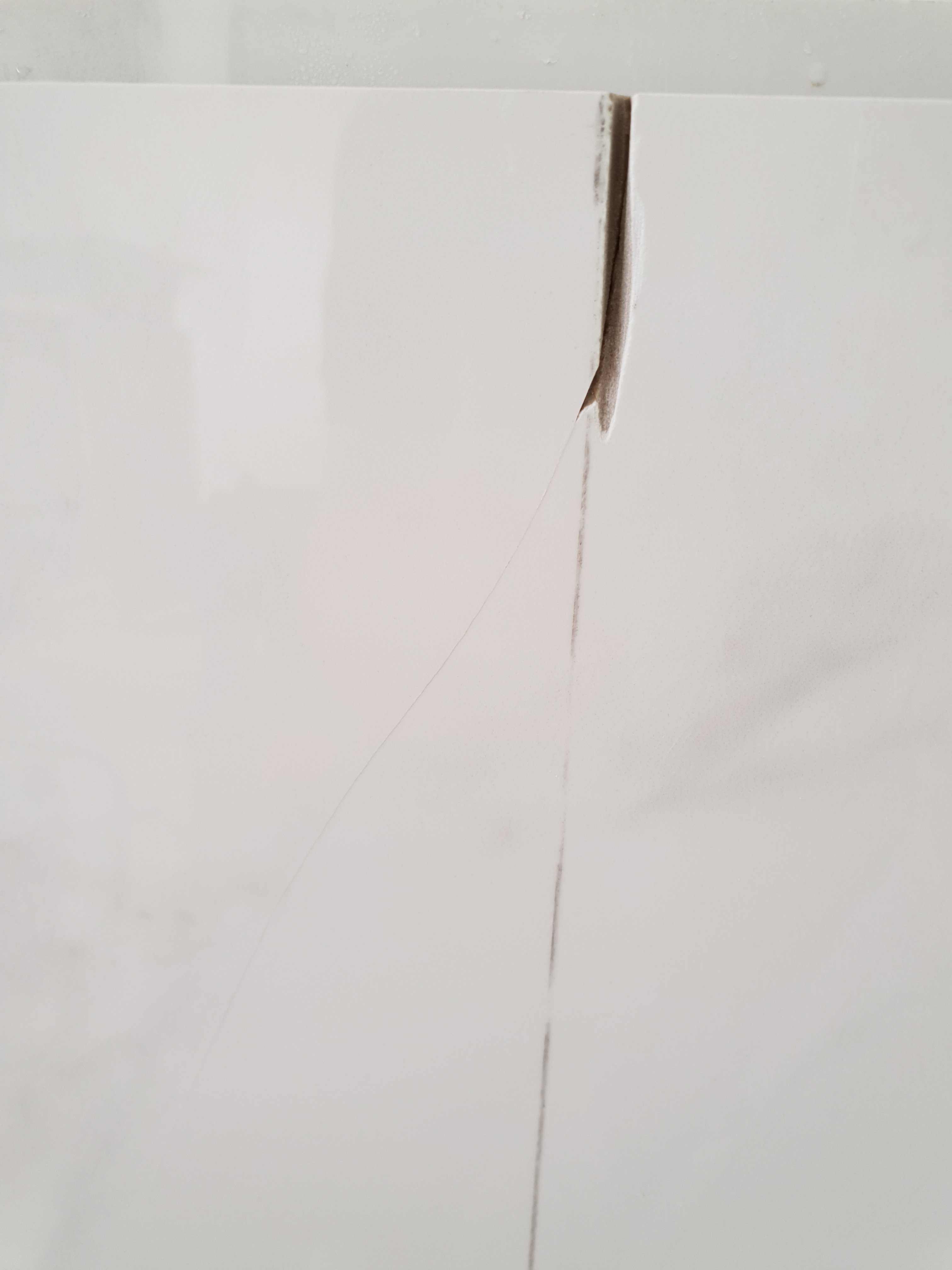

Glazed porcelain cutting issues

Totally Agree its just cheap tiles, its Really weird that its not every tile, he say its hot spots, I'm using expansion joints in doorways so hopefully it will not notice if the shade is different.
Guys there are some tiles that are simply sxxt , had this problem from fired earth and I used both my sigma water saws push table version and the larger bench plunge version both marcrist 850 blades,, no good .
The costumer complained about wastage of 11 tiles costing £250 fired earth got rid of me and sent there best tiler who worked with them all The time .
I lost two days work never gota job of them ever again .
The plumber was my mate and it turned out the best tiler had the same problem so fired earth changed the tile to something else .
Fxxxxxr's
Everytime time ive dealt with Fired Earth ive had problems , ive contacted there tech department and they have admitted difficulty in cutting tiles as well ..
I always check the tile before starting a job and if there's an issue I reject the contract . Makes the tile shop look like arseholes .
The costumer usually calls me back to tile with a different tile , and has a long story to tell me about they will never deal with the shop again .
Look there are companies that will only sell cheap garbage for the short term.
Thanks for that explanation Marc. I've never heard of over firing, but now I have. I did have a batch of floor tiles that the customer wanted on the wall. I did a test cut and it was one of those porcelain tiles that would not cut in a straight line on a dry cutter. I wasted one tile and got the customer to order a different style of tile. He did and I saved myself from having a nightmare.
