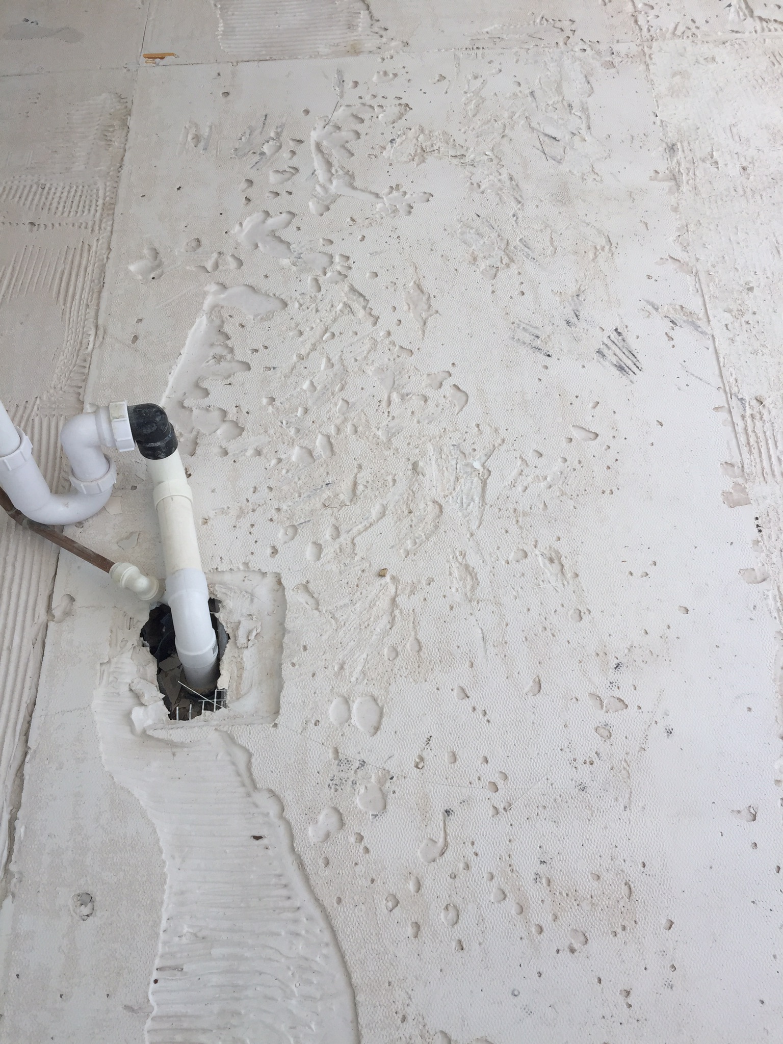

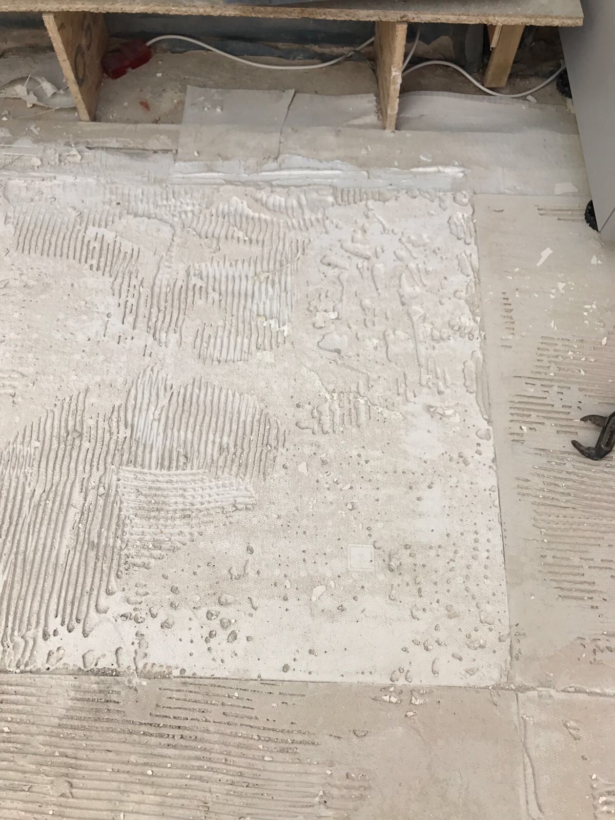

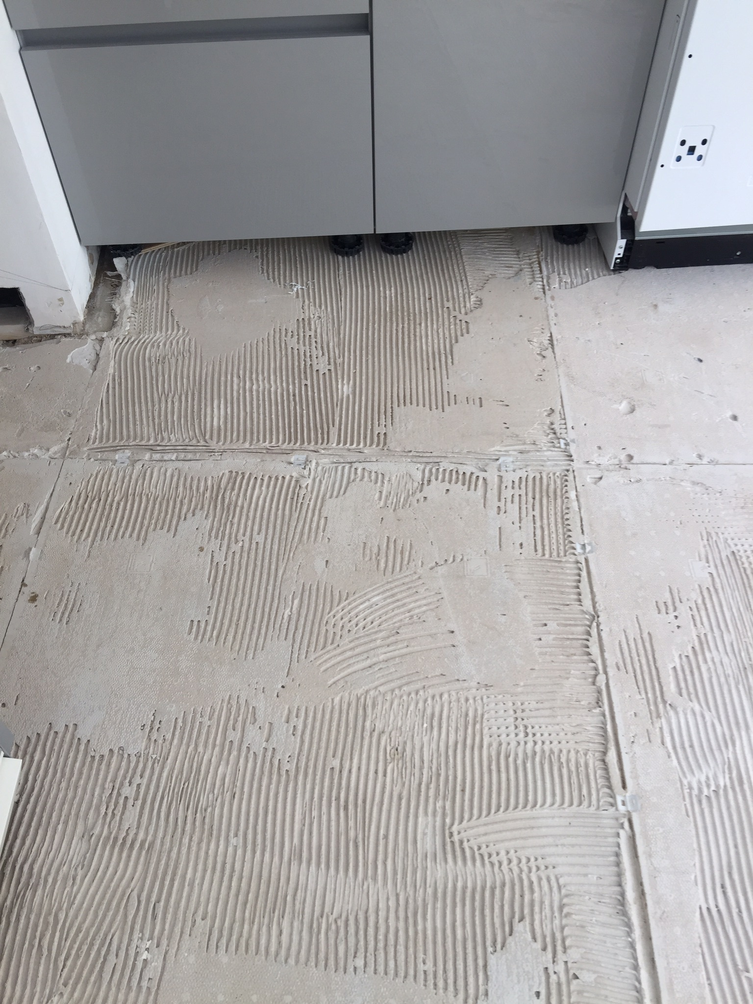

A bit like this, this install 9 from 15 pieces split clean in half thro poor installation techniques.
This is NOT how it’s done.
