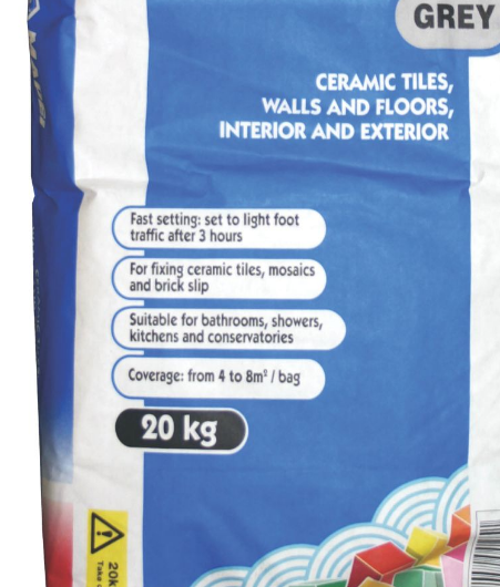

I used powdered stuff which you mix up, bought from wickes a couple of years ago, but have have to do it twice since laying the tiles...problem is, it cracks up, and comes out...total rubbish...why can I not find ready mixed Grey floor tile grout anywhere, like you do the white one? any ideas?
The tiles are definately not moving, and were layed by myself on concrete downstairs toilet floor. Iv'e done a few before...Just looked at the stuff again, bearing in mind, I'm no expert, but they told me in B&Q that I could use this stuff as an adhesive and grout. It is Mapei fast set tile and wall adhesive...Thinking now that someone there is an idiot...unless I'm wrong. see photo canvas.png
chalker...now you're confusing me..I thought Mapei was one of the better ones...are you saying that screwfix's mapei products are fake?😵
Let's just clear something up...... Screwfix now sell Mapei Ultracolour Plus as well as the cheaper Mapei grout. They are subtly different (less polymers etc)
