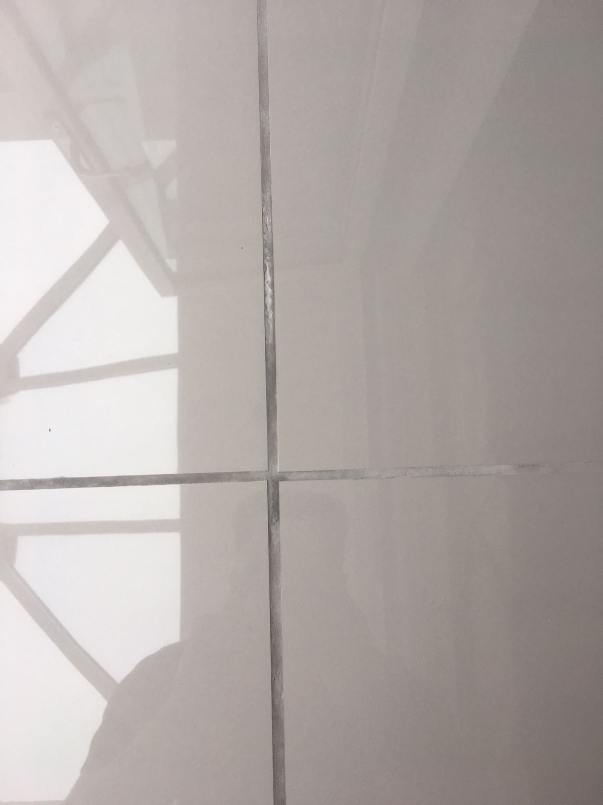

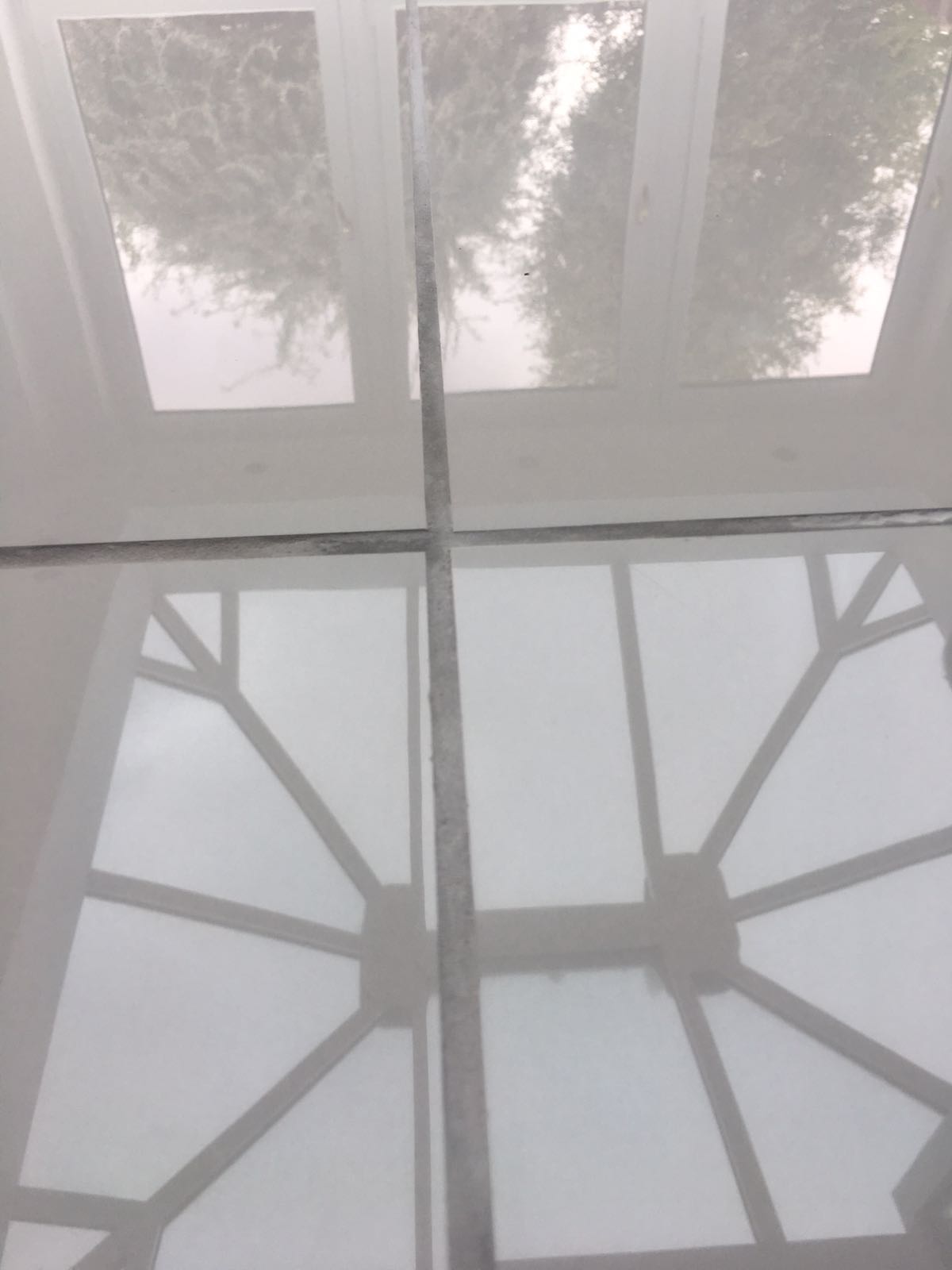

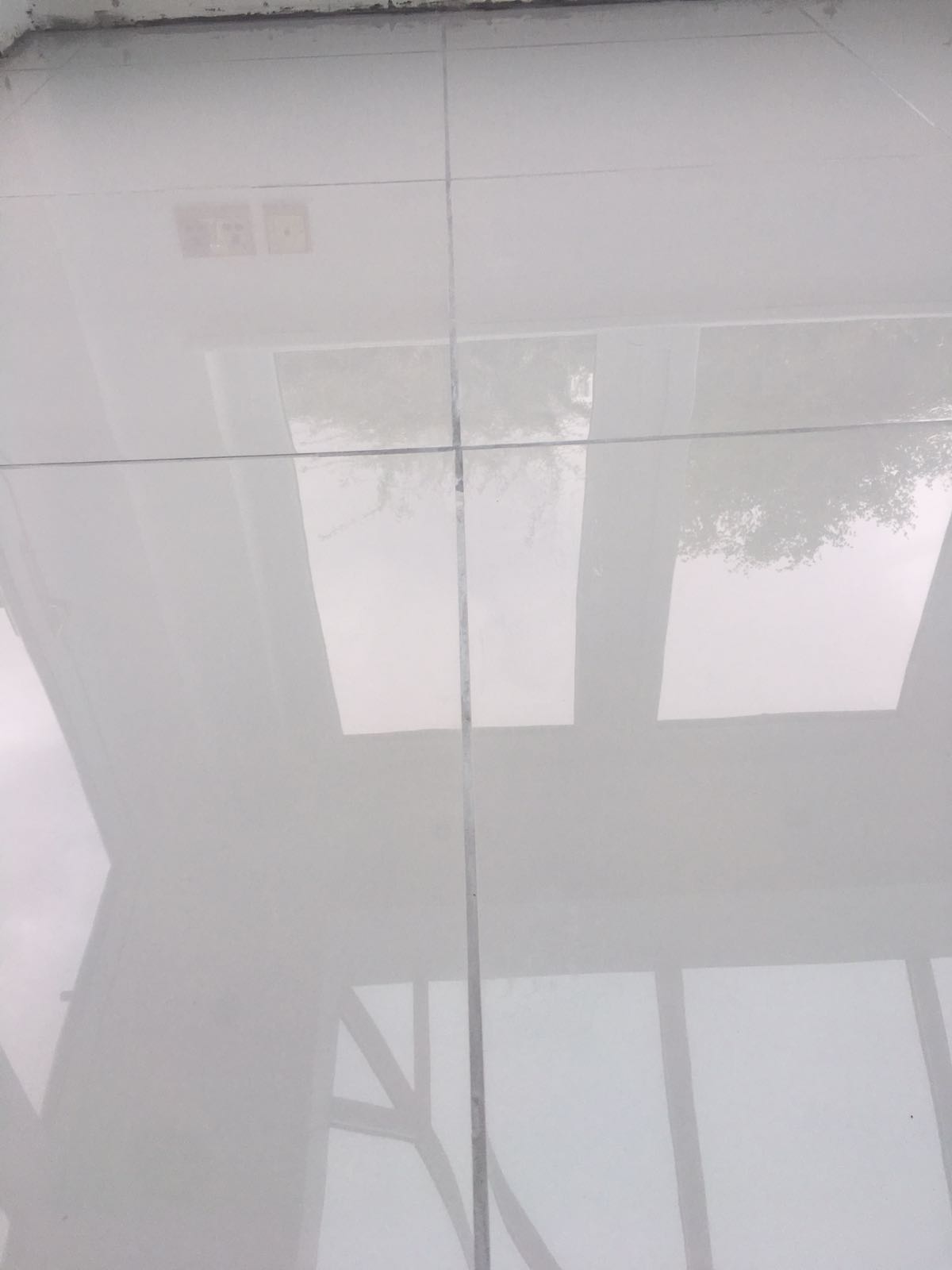

I have grouted a floor using the BAL Smoke grey however it is not coming out that colour and is very patchy. Some bits are light grey and some are dark. It has also happened to me before. I am using a fresh clean bucket, added water and stirred with my hand with a glove on to get the right consistency, however don't know why I'm getting this reaction. Any suggestions? I have attached photos

Grey grouts are notorious for drying patchy nowadays.
You should empty the contents of the bag in to a dry clean bucket first and dry mix the grout.
This will ensure that the pigments are evenly mixed throughout the grout first, then mechanically mix the grout with a small paddle.
This will be especially true if you’re not mixing the entire bag all at once, and you should make sure that mixes are identical, proportional to the amount of water used.
Another reason a grout will dry patchy is because of efflorescence. (Excess water at some point) the grout dries too slowly and salts are drawn up thro the grout because of the slow rate of moisture release.
That can be caused by standing water already in the joints when you grout, or using excess water when washing off.
It does appear tho in this case tho that you’ve just not mixed the grout thoroughly enough and the pigments are not evenly distributed throughout the grout mix.
One other reason it can happen is if you try and ‘top up’ already drying or dry grout.
It is good practice to leave the grout to rest after mixing for a couple of mins then remix.
I don’t think that’s an issue with the pigments not mixed right, I think that’s a problem with over washing or washing too soon, or both.
sorry marc,
I had not noticed that you had already said.
for me in the morning English is mixed with Italian and dialect...😡
Well the reason I would say it’s not efflorescence is because a symptoms is that the grout is lightened in appearance, not darkened.
As the original colour is smoke grey, which I believe to be quite a light shade, you wouldn’t be getting the dark shades If it was suffering from salt deposits.
Ahh, I’m not familiar with smoke grey so not sure what colour it’s sipposed to be but those really light almost white patches must be efflorescence
I always try and 'peg' the grout joints with these new grey grouts and that seems to stop any shading issues. If the joints are narrow like these, then I would just let the grout firm up a lot and then rub the grout joint with a fluffy towel. That works too.
