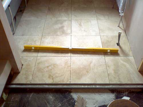

As a coincidence I am doing a honed and filled tranertine floor on timber at the moment :yes: .
