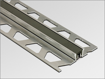

Hi,I had a problem laying limestone in the same situation the customer did not want to see an expansion joint but it did crack and he agreed that he had have one try this Schluter profile dilex_copy.jpg

Hi, thx afright for the comments & pic. I have decided not have the floor tiled if an expansion joint is essential as I don't want the visual delineation of old house & extension half way thru' the kitchen.
