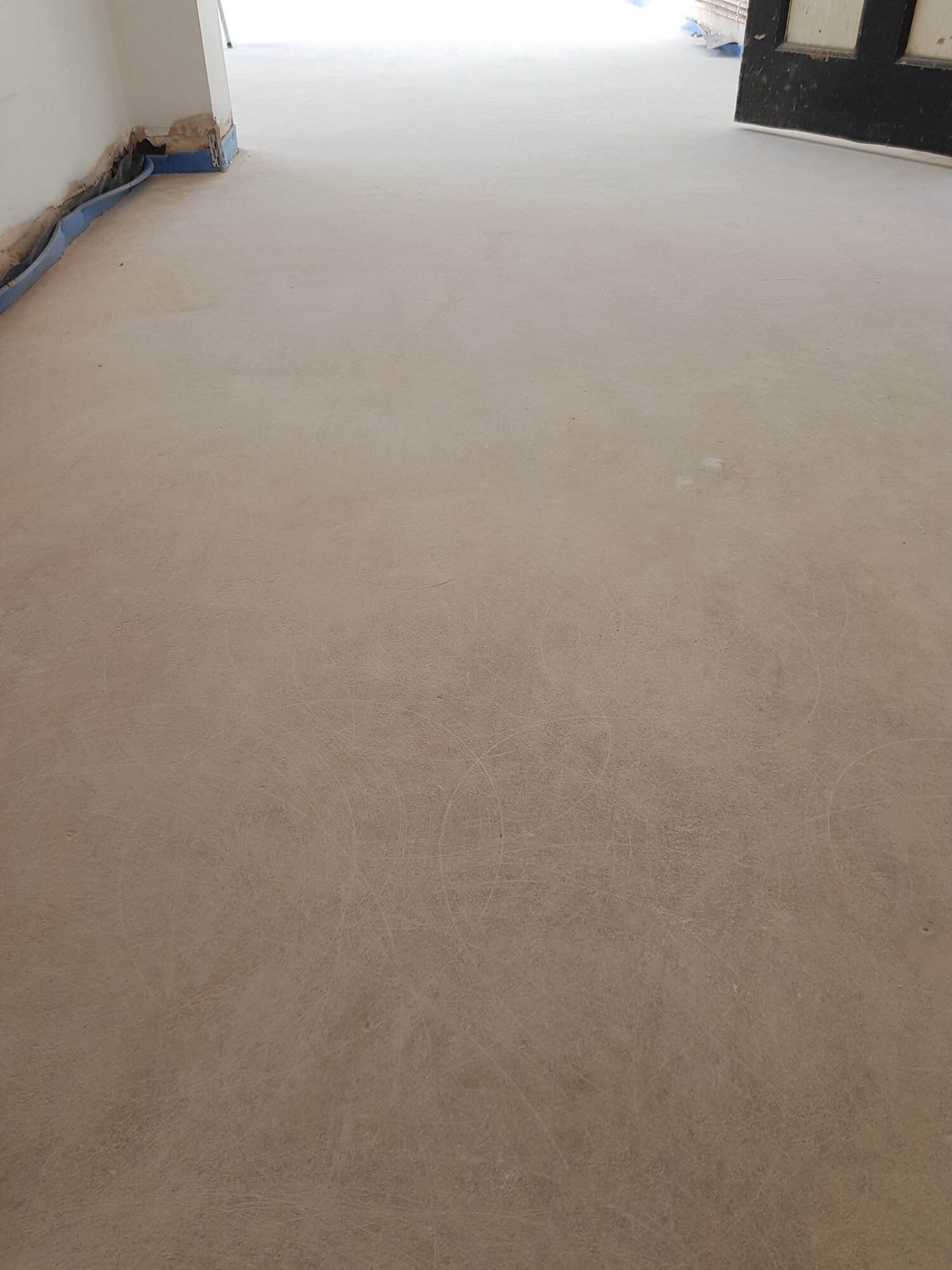

So my liquid anyhydrate screed was laid in December, the laitance was removed mechanically by a sanding machine with diamond cutter 5 days later. I'm on the verge of getting the floor tiled in the next week or so. I commissioned the ufh a few weeks ago. Now I'm getting cold feet thinking the laitance hasn't fully been removed. I've attached pics for all you pros to see and hopefully reassure me that everything is fine and I'm overthinking. The floor does need a good sweep and vac but my question is do I need to get the guy back to sand it again?? It cost me £200 to get it sanded in the first instance.
Nah. Just hoover it up. What method are you using to tile it ?

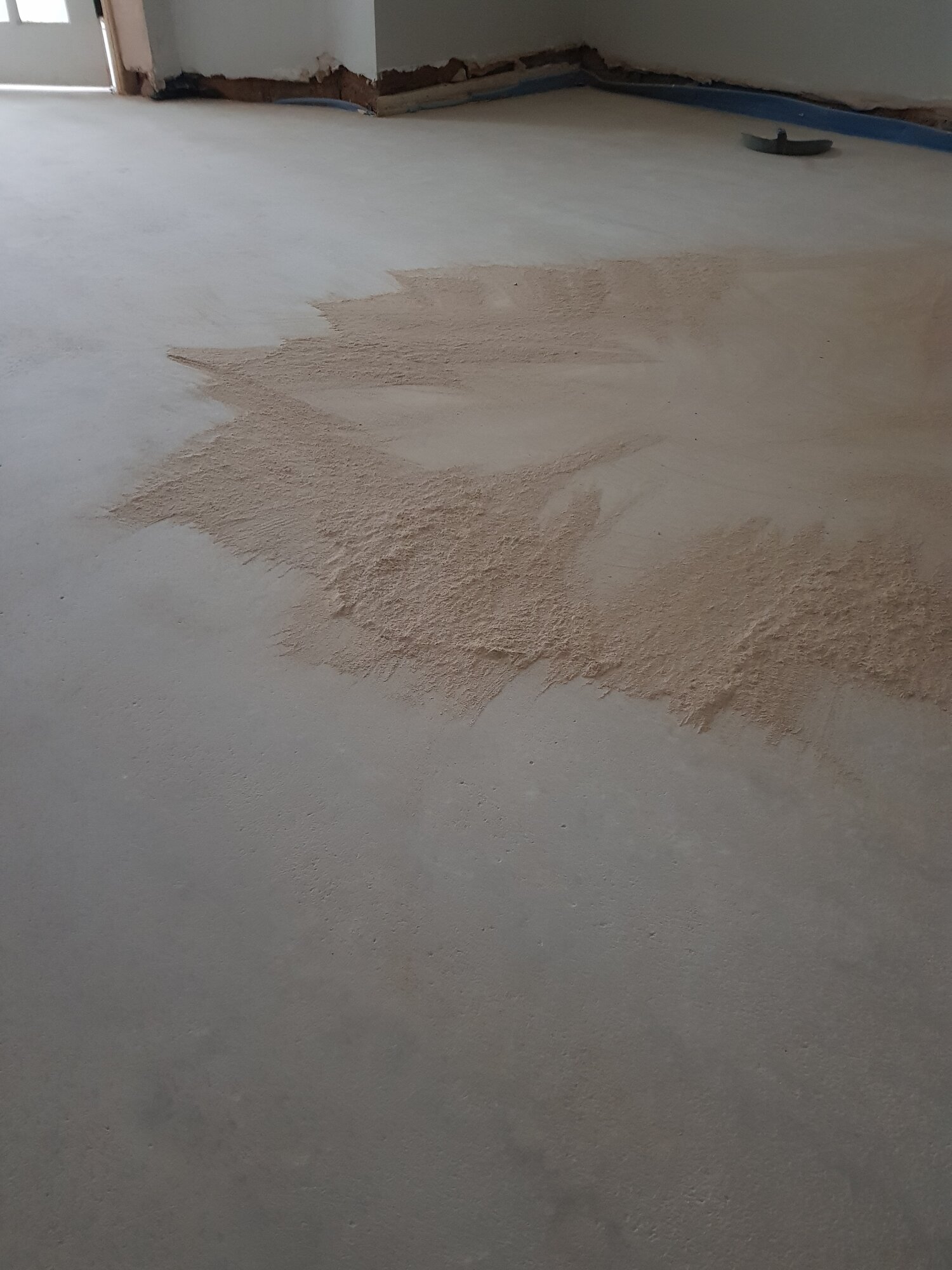

Just to update I've hoovered the whole floor and I've noticed theres areas of lighter patches. Could this be laitance stuck to floor or is this normal?
If you are not sure sand it again? It's you that needs to be comfortable that its properly prepped. I can say there is some small, patches of what looks like flaky laitance there but whether its enough to cause you an issue I dont know from photos.
Are those small patches of laitance the lighter shades of the floor?

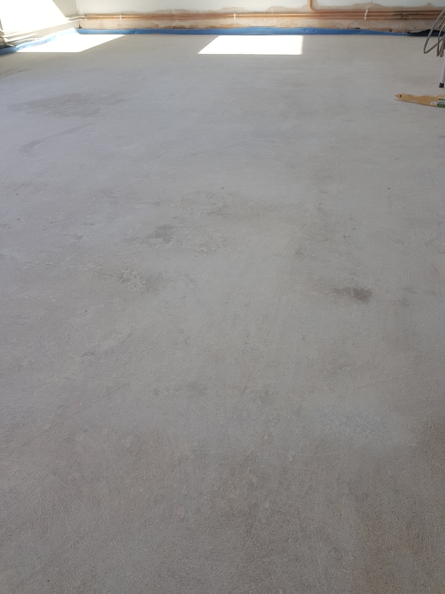

Update...had someone come out to sand down the floor again. He used a diamond disc sander. I've hoovered all the muck but I'm still getting patches that are stuck to the floor (definitely not loose) of what I think is laitance on the floor?? Is there enough on there to fail the floor? Or am I overthinking?
If they’re not loose they’re fine
