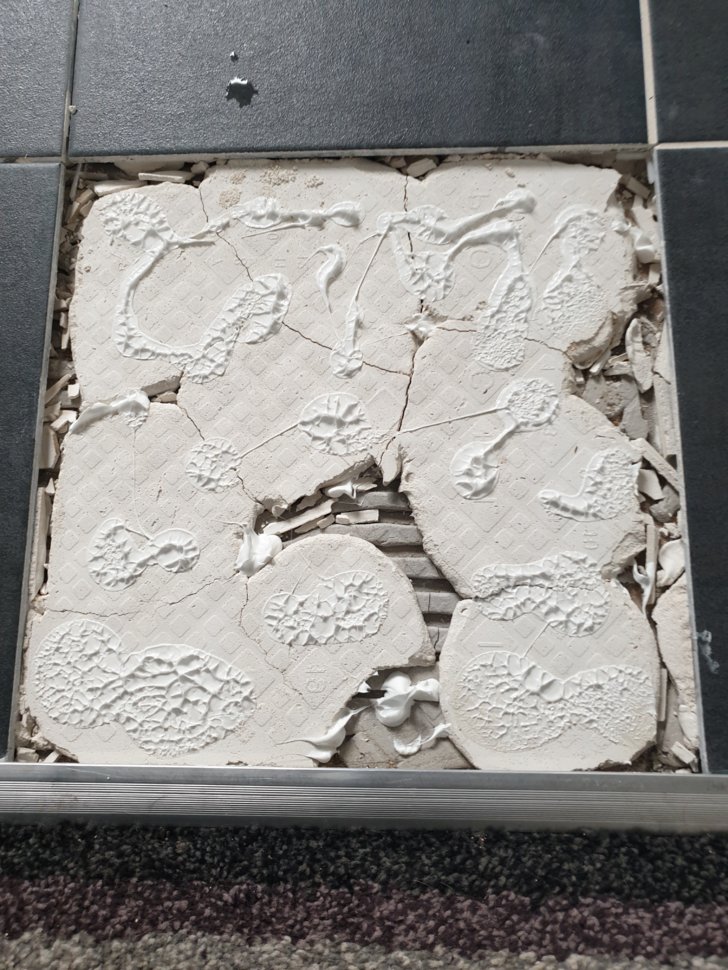

Hi, sorry to ask but we where having a repair done today on some floor tiles in our bathroom that had come lose. I witnessed him try and Silicon the tile back down.
So question 1. Why did they come lose any ideas
Question 2 is silicon the tile back down acceptable way of doing a professional repair.
Any advice would be very helpful.

Hi Stephen,
there are voids underneath.. it has been dot and dabbed and there looks like a build up of different adhesives..
has the adhesive stuck to the tile?
from the look of that one tile you are likely going to have problems in the near future with other tiles
Thanks dave yes when they did the floor it wasnt level so they broke up some tiles and used large amounts of adhesive in places to make it level. I was worried that this would cause problems. The ones by the door are the first to go. And that is the small amount of adhesive.
I take it using Silicon is as a thought a dodge attempt?
And you paid them to do that? adhesive can only be built up to 6mm in isolated areas unless particular adhesive (Bal flex one for instance) can go to 15mm the floor should have been levelled using a leveller, then an anti-fracture mat laid then the tiling.. I would seriously ask the question of your tiler because you’re going to have bigger issues Silicon will fix a tile (I’ve done this in my past life when I was on the tools) but was usually when I had one tile to go and didn’t want to mix any more addy up what adhesive did they use do you know?

No sadly no idea what they used here a pic of a built up section as you can see they used bit of tiles. Take it this is no good either.

Definitely not mate..
I would say the lot needs to come up, floor prepped properly and retiled
it’s a shame because you will end up out of pocket unless your fixer puts it right off his own back which he should do
I’ve never known a tiler to try and build up using broken bits of tiles.. addy yes even though they shouldn’t but not broken tiles
