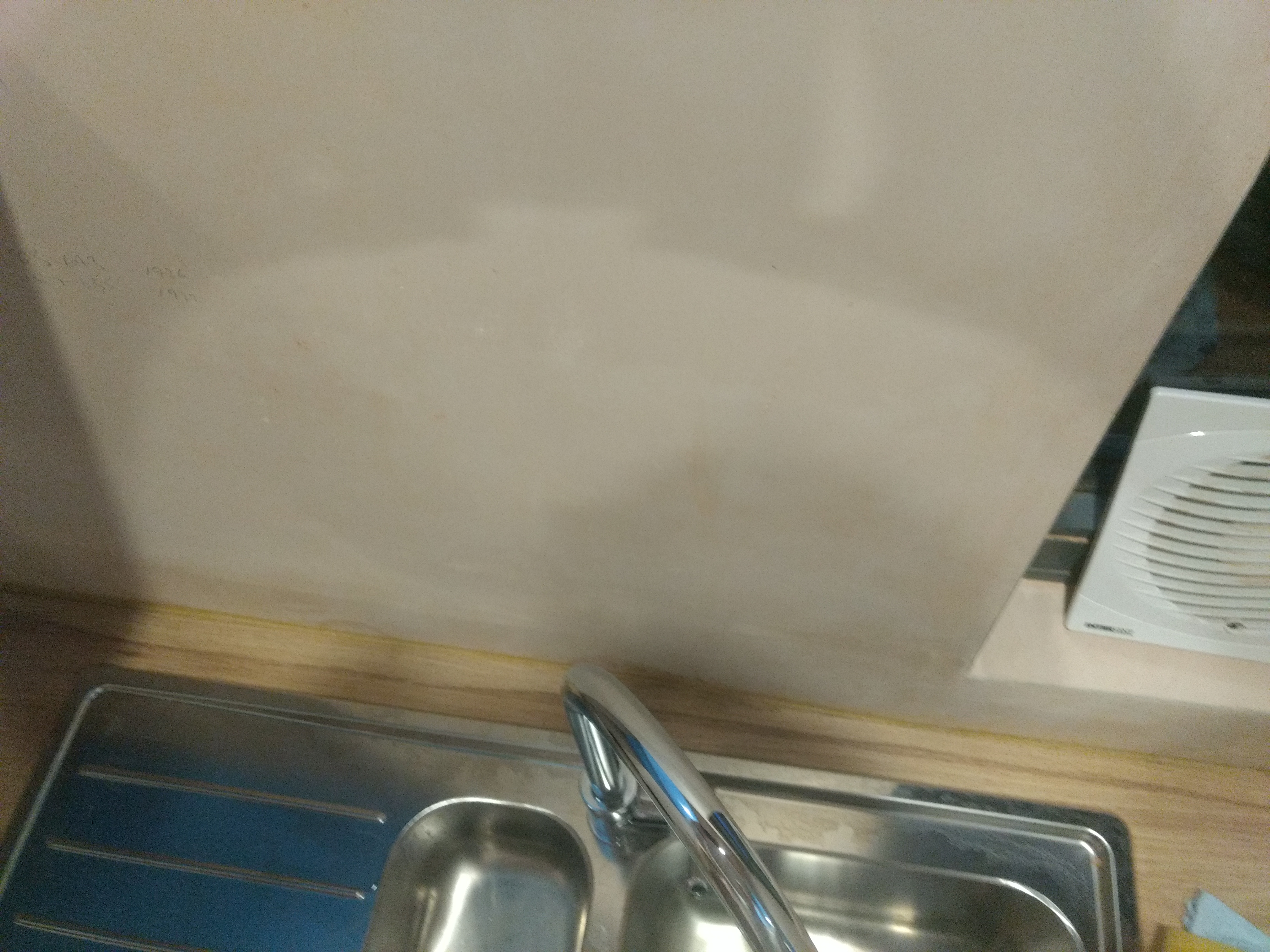

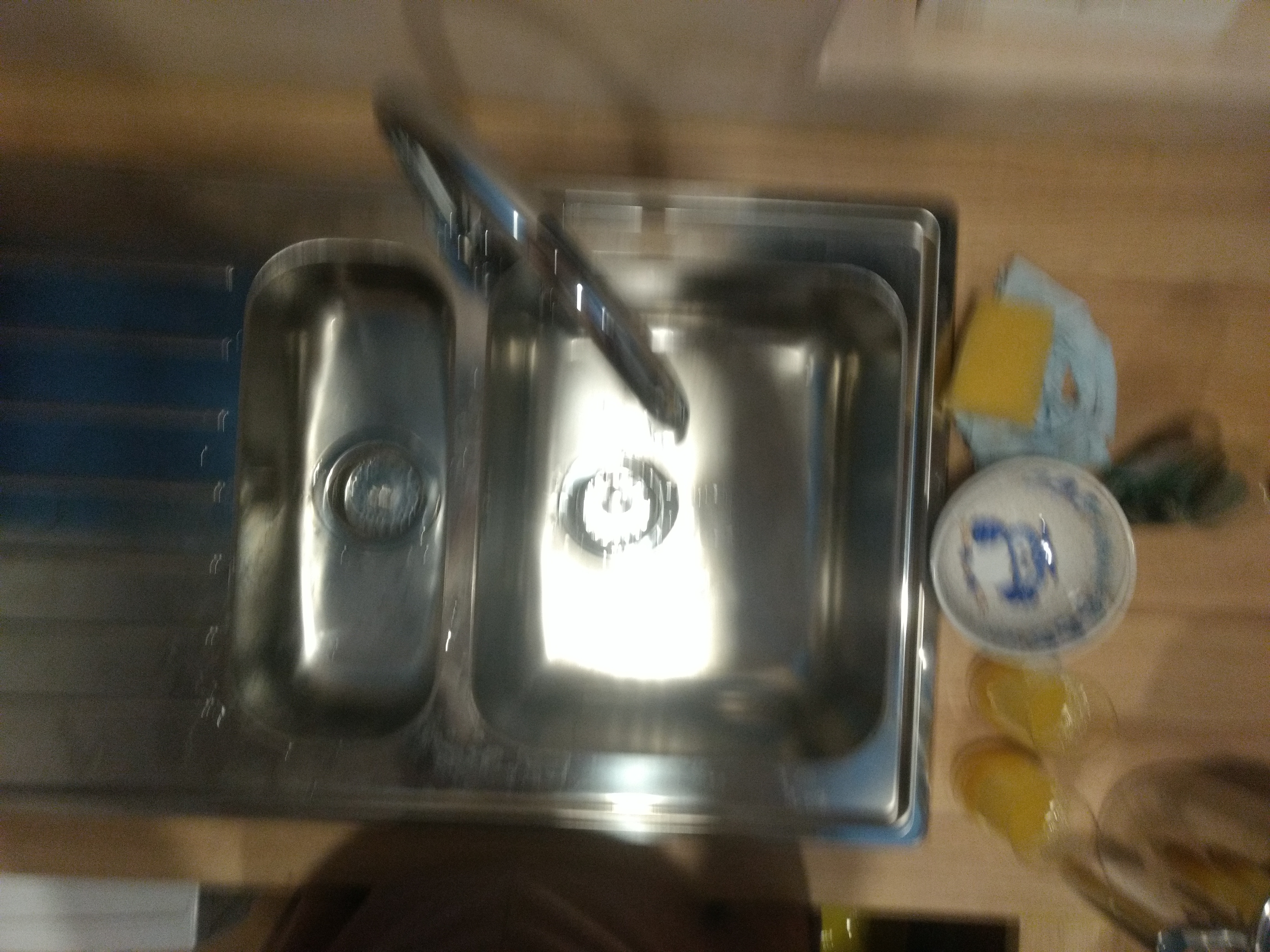

Here is a picture. It looks even worse in real life. The sink is neat at the front of the worktop but one of the back corners is 1cm further from the back wall than the other. It's not the hugest sink.
I am NOT doing a cheap job with this. I'm paying an enormous sum of money for the changes, but I expect a high end finish for that, and this is emphatically NOT meeting that standard. I will be paying the tiler a good price.

Good tilers can sort it - not by packing loads of adhesive behind certain tiles but by straightening the walls prior to tiling. This might entail chopping out high points, floating in rapid set with a straight edge, sticking thin backer boards in certain areas and usually a combination of all of the above. We do this without removing fixed worktops/units so why can't they?
If I were you I'd stick to your guns and make them sort it - they've messed up and given you a sub standard job. Failing that find a good tiler who can sort it but expect to pay extra for the prep - maybe the builder will knock the price of the extra prep work your tiler will have to charger off his final bill?
