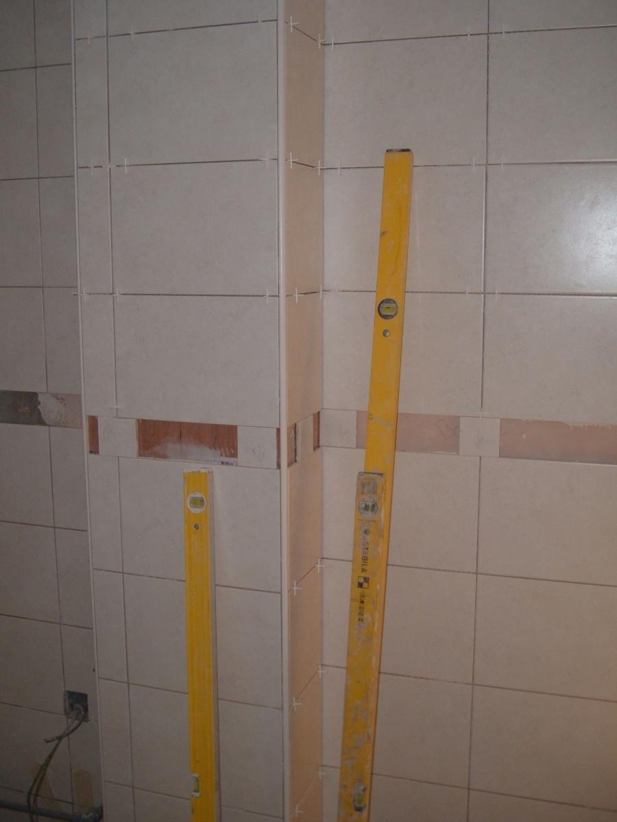

Hi and welcome..you need to do somethink as in picture, cut some tile pieces just slightly wider than your mosaic. fit them to support the next row and leave to set...

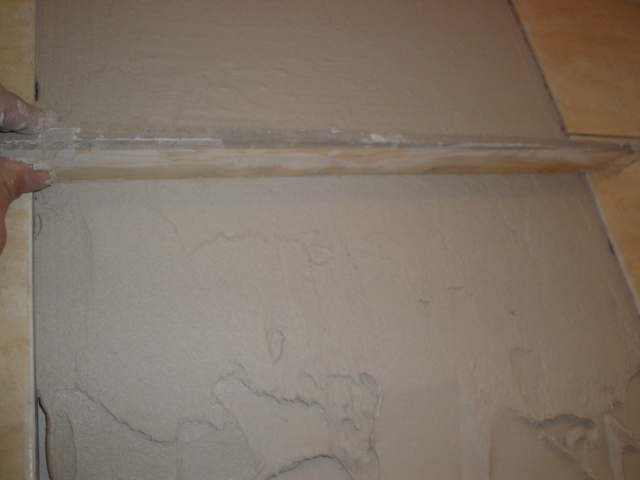

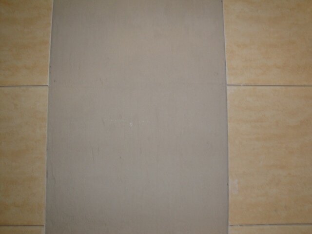

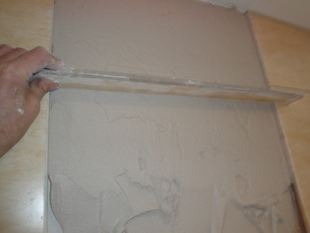

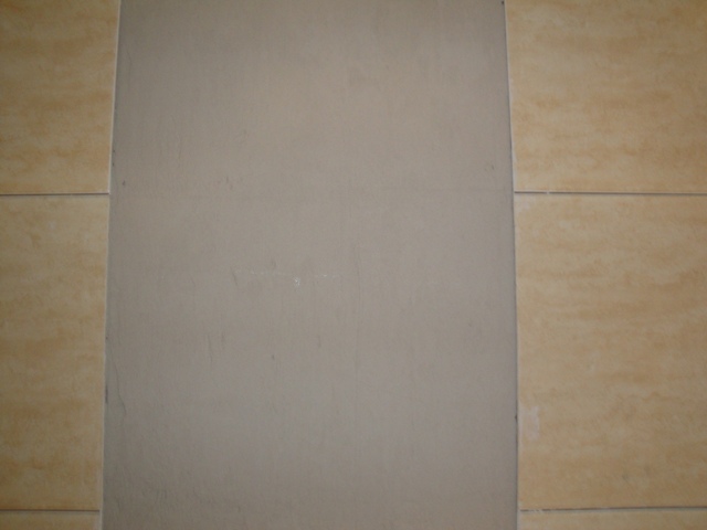

Same as Whitebeam for me. You can then ensure the correct adhesive bed depth by using a "dog ear" so that the mosaics set straight and flush.
Daz
:welcome: from another brown eyed female.. ask Daz to explain dogear to you, it's nearly my bedtime.. there is a link somewhere though..
Dog eared screed
